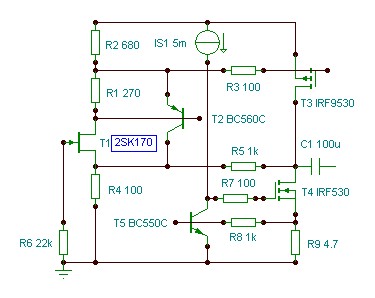

Wavebourn said:What do you mean?
I was referring to driving a 7watt rated tweeter with a 8 to 10 watt amplifier, albeit Class A.
It depends. On 1 meter distance 94 dB/W/M driven by 10W tweeter may be too loud.
I am not Lineup,
but for me it is torture to see schematics drawn such a way, like Egyptian hieroglyphs from right to left. Check if you can flip symbols horizontally in your software.
The most resposible for this design is Wavebourn. True.

Wavebourn,
lineup,
For me too, but I did not write the software.for me it is torture to see schematics drawn such a way
lineup,
I would not be so sure. He probably does not get easily inspired by others` design. Besides, your design is limitedly exciting.So he forked this intesresting amplifier out of my own design:
Lineup, I just took your parts for some exercise and designed what Kubeek wanted and liked. That's it.
Lumba, I don't understand what inspiration by design means. I understand inspiration by end requirements and limiting factors.
Hi
I have just stumbled across this thread and it appears I have most of the parts to build Wavebourn/lineup amp.
I have just a couple of quick questions before I start.
1 . What value volume pot would you recommend for either circuit?
2 . What are the capacitor values in Wavebourn's schematic?
Any help would be really appreciated! 🙂

Hi
Its eerily quiet around here 😉
I understand this is an old thread and you might not remember some of the values. I was wondering if someone could help me with the capacitor values/type for C6 and C5 on the following schematic?
Thanks a lot
Thanks a lot
Those seem to be power supply caps. 😉
Good luck and report back...anything from Wavebourn interest me.
M.
M.

Hi Max
Thought so...I just wasn't sure if he recommends a particular value.
I'm going to start laying out the components tonight, I'll just have to see how I get on.
Thanks for chiming in!
