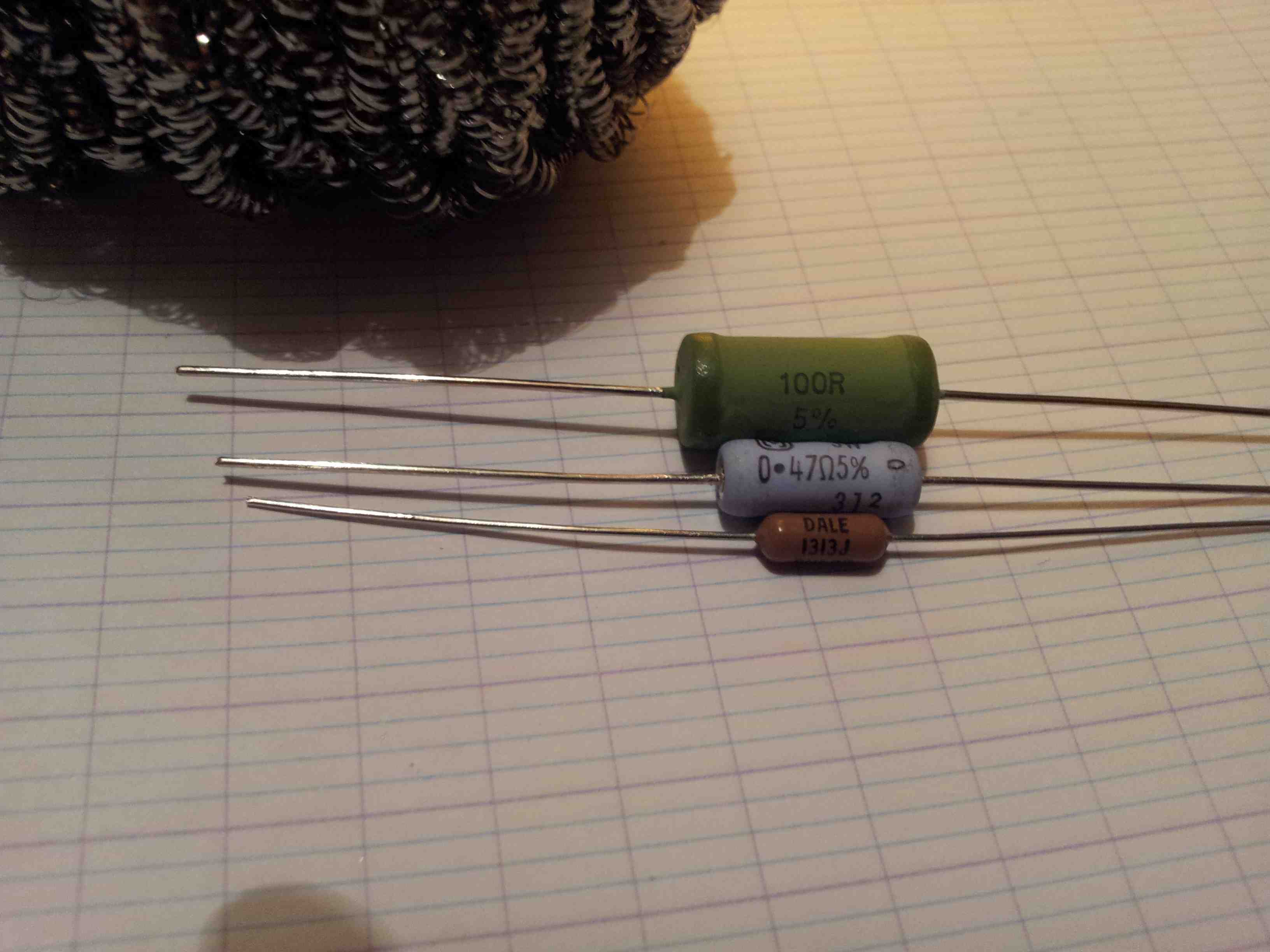

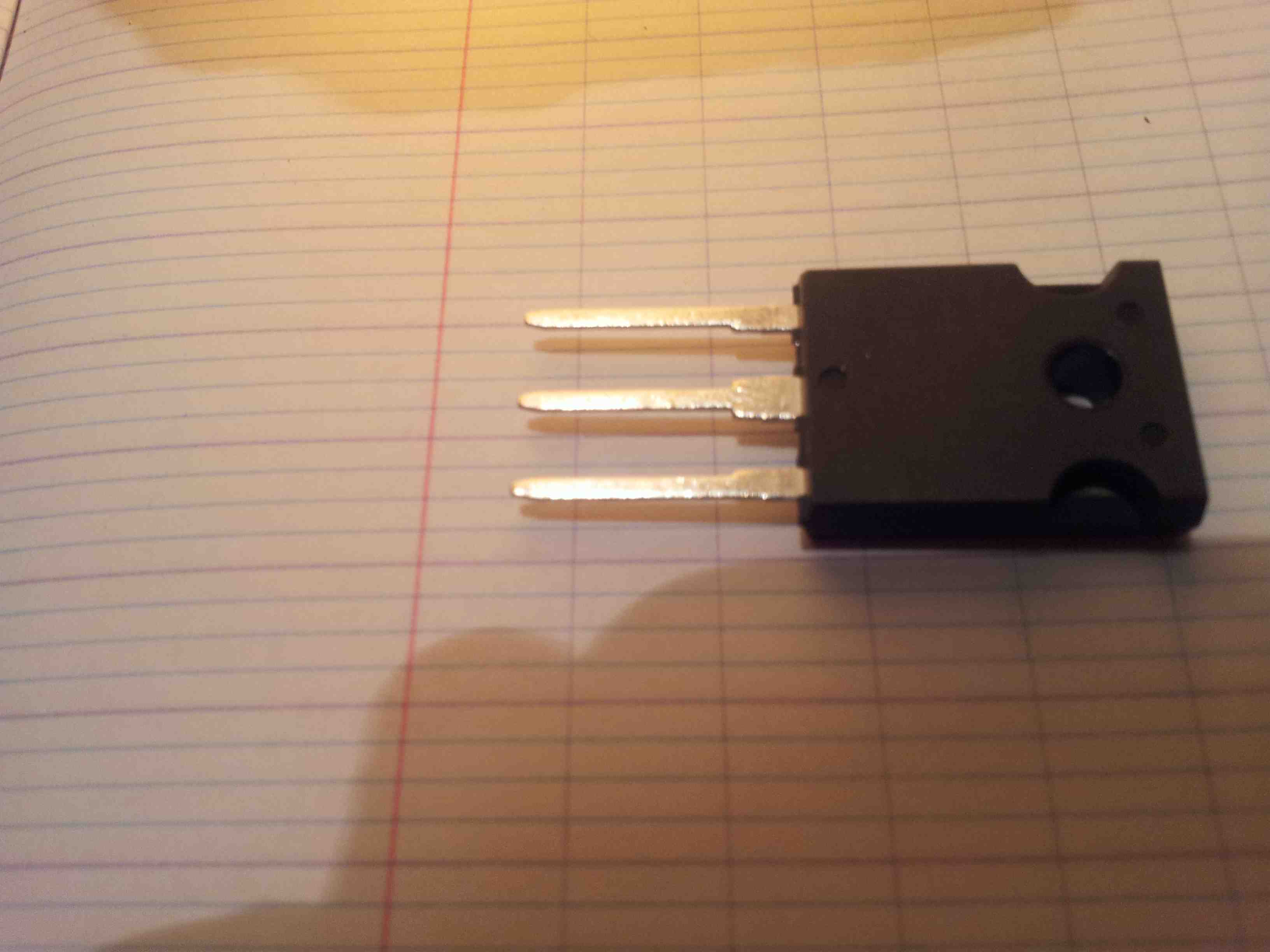

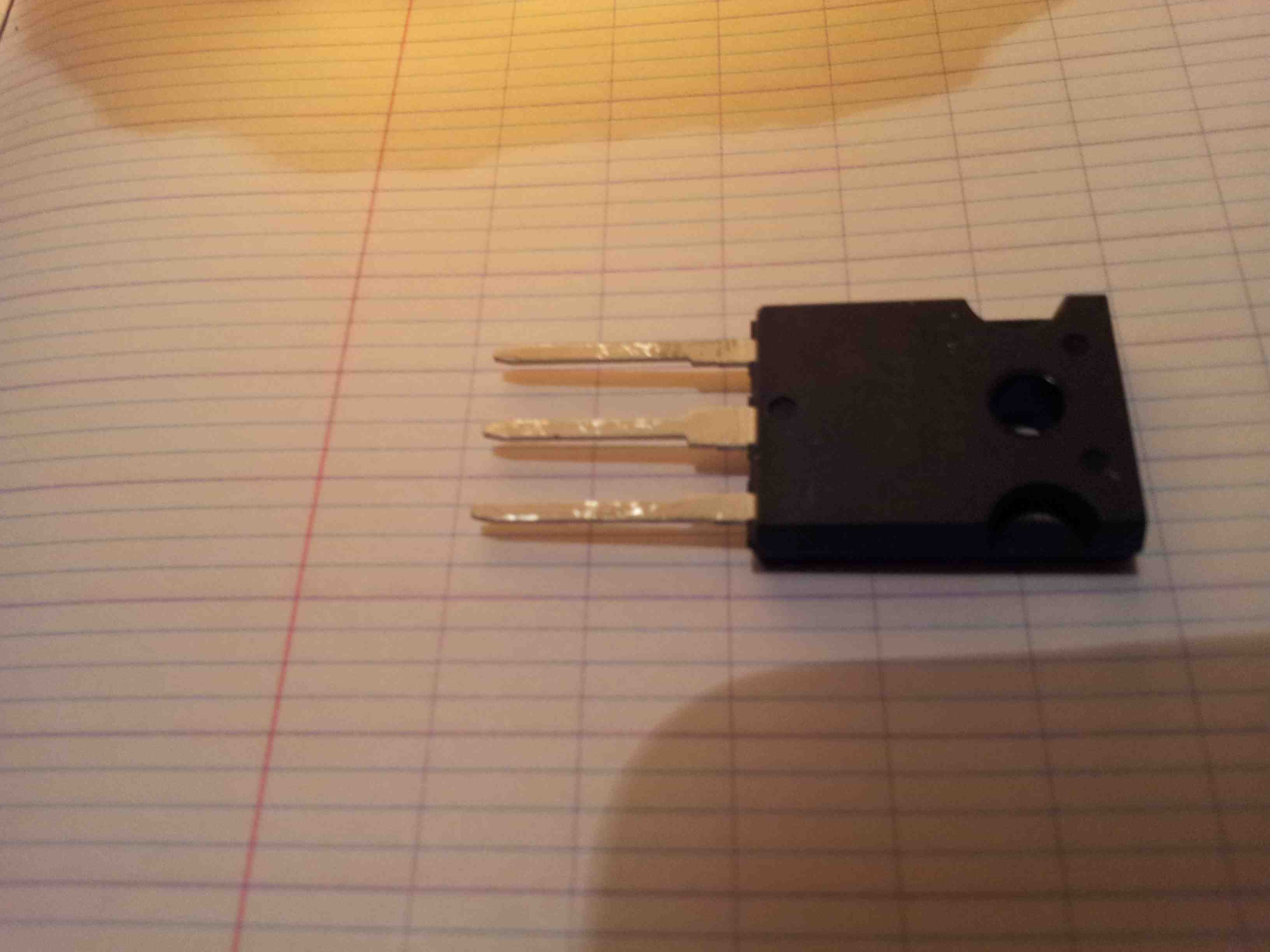

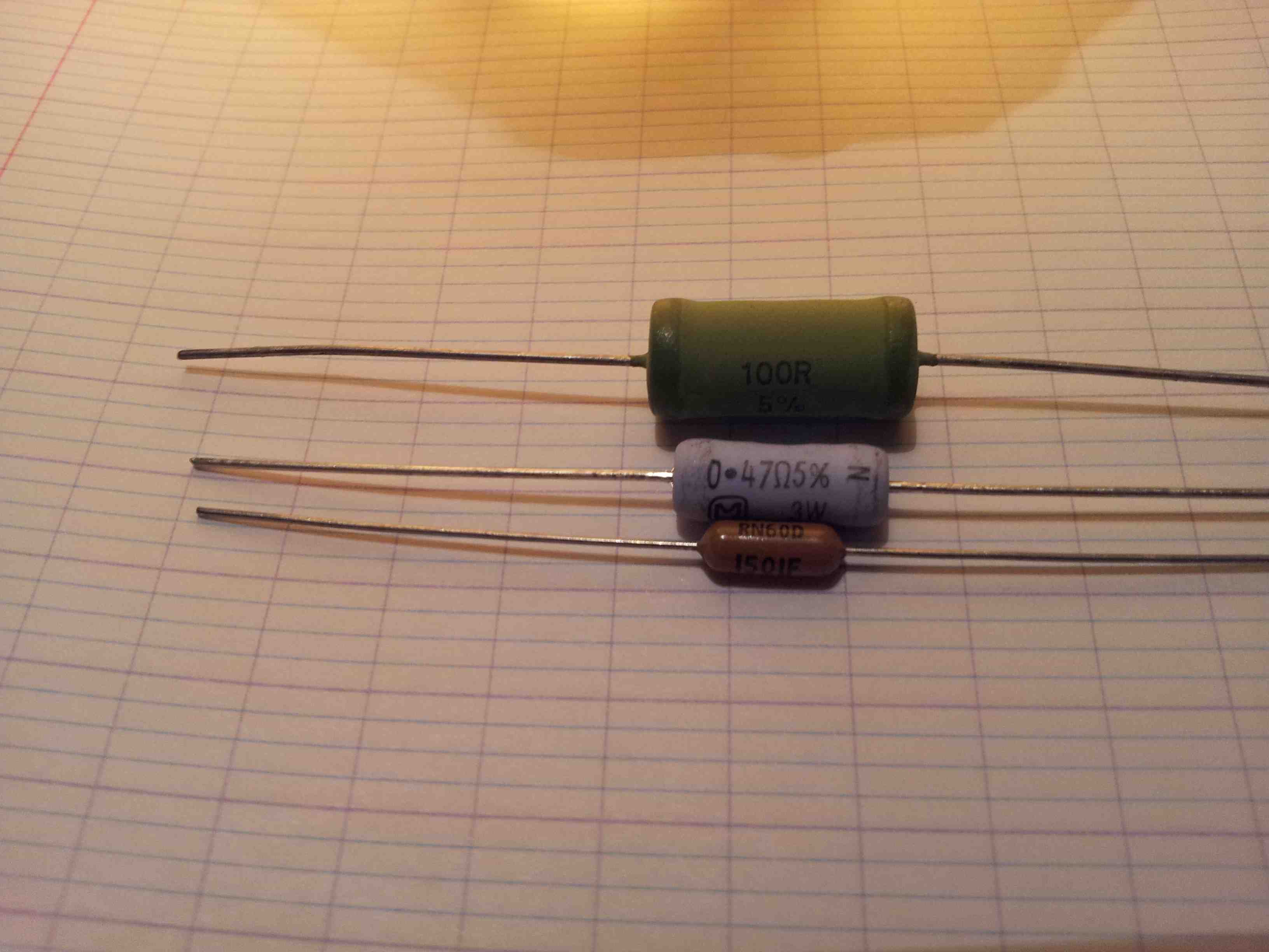

No matter what wire or solder you use, you won't get a good joint if your components have oxidation. I keep a small piece of fine steel wool on the bench and clean the leads of my components right before installing and soldering them. For large joints, I also put on a little liquid flux. Cleanliness is key to a good solder joint.
YES
