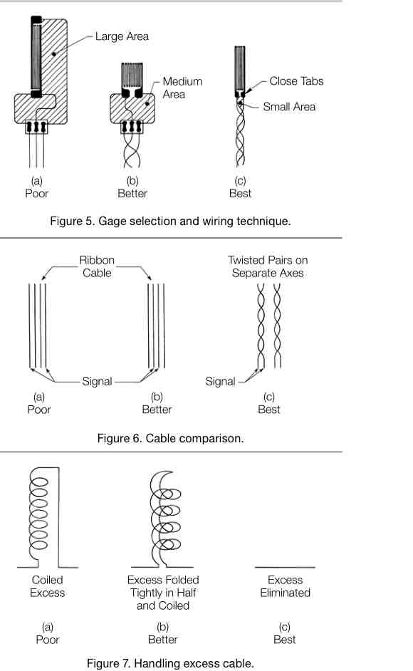

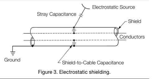

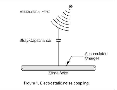

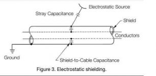

I do work with strain gauging ie extremely small signals and have discovered issues with crimped bnc connectors just for starters.
This is basic stuff for most people here but I thought you guys might like to see how we tackle this stuff.
http://www.vishaypg.com/docs/11051/tn501.pdf
Hi 2Pico Dumbs
One document from Vishay lab like rare pearl fished in Pacific ocean don't miss
Very instructive and useful in all diy amplifiers construction this is one i have looking for long time.
Can realy participate to made cleaner signal path.Thanks to 2Pico Dumbs for great contribution:magnet::bulb::trapper:

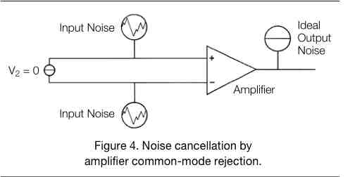

Glad someone appreciated that.

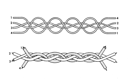

This wiring technique works much better than twisted pair for small signals.
Cable 1 and 2 are paralleled to form one conductor and cable 3 and 4 are paralleled to form the other conductor.

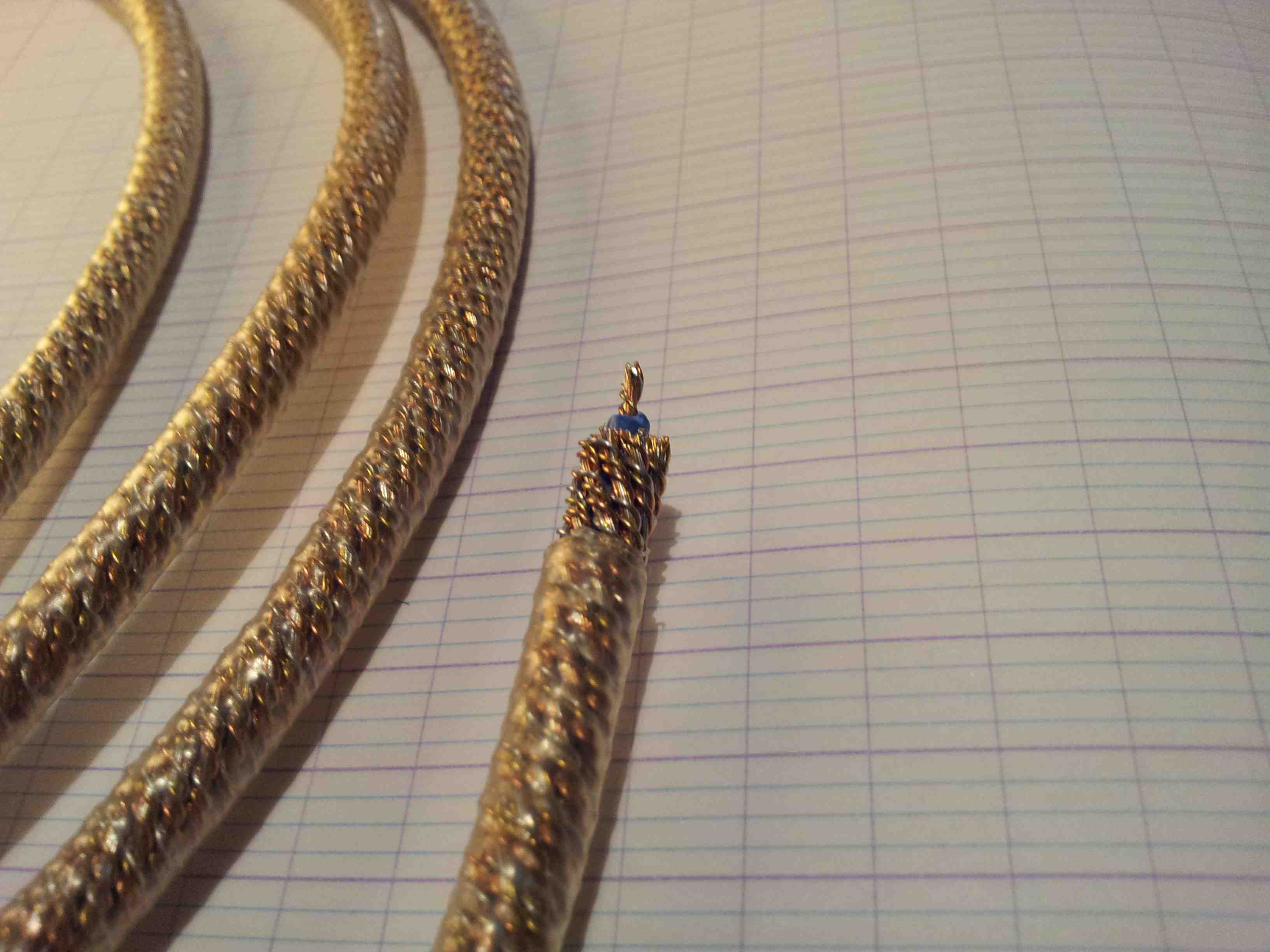

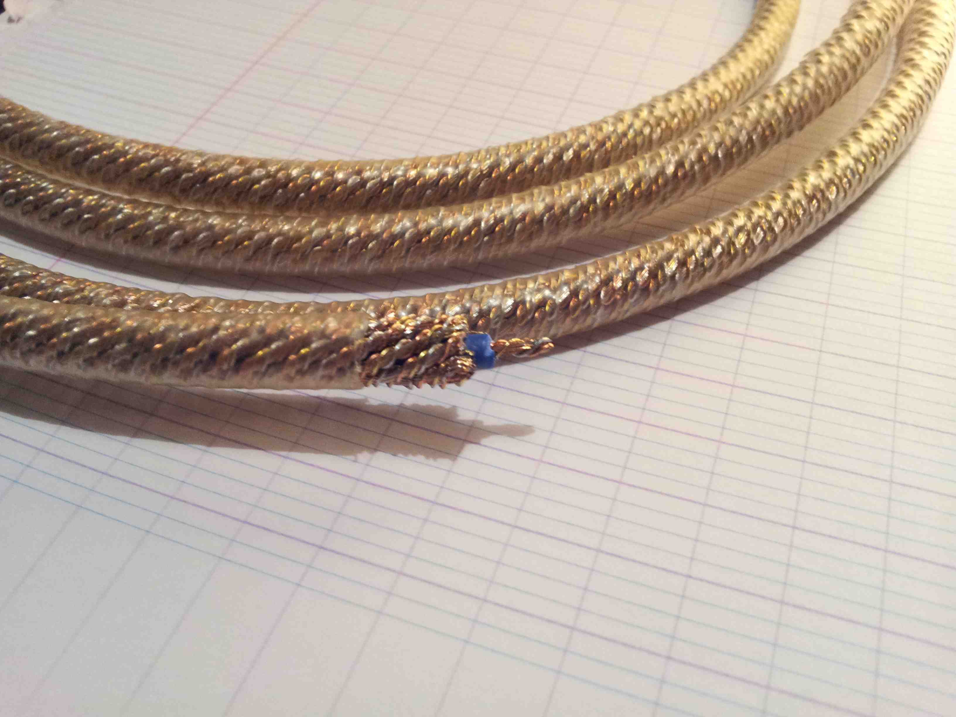

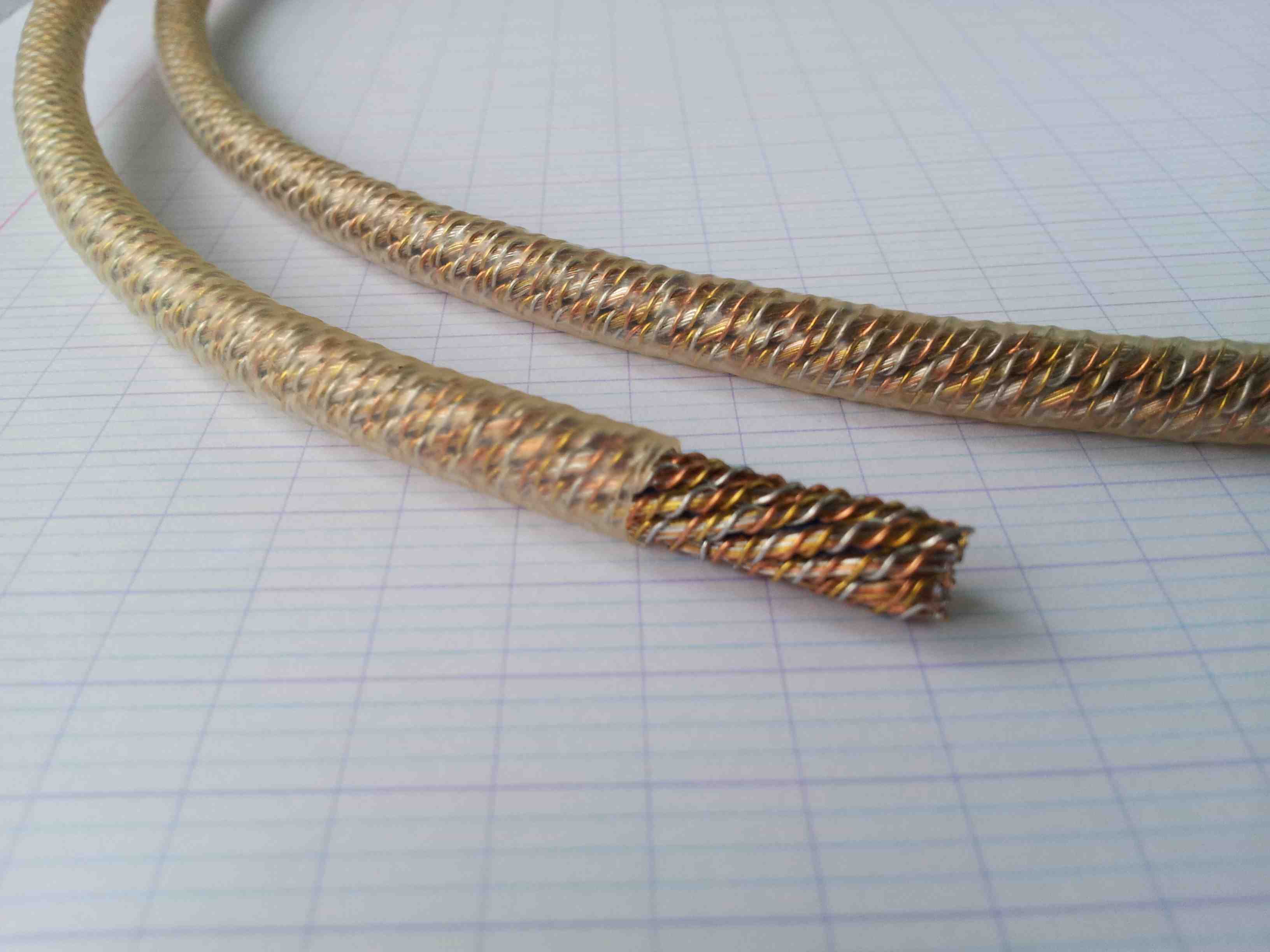

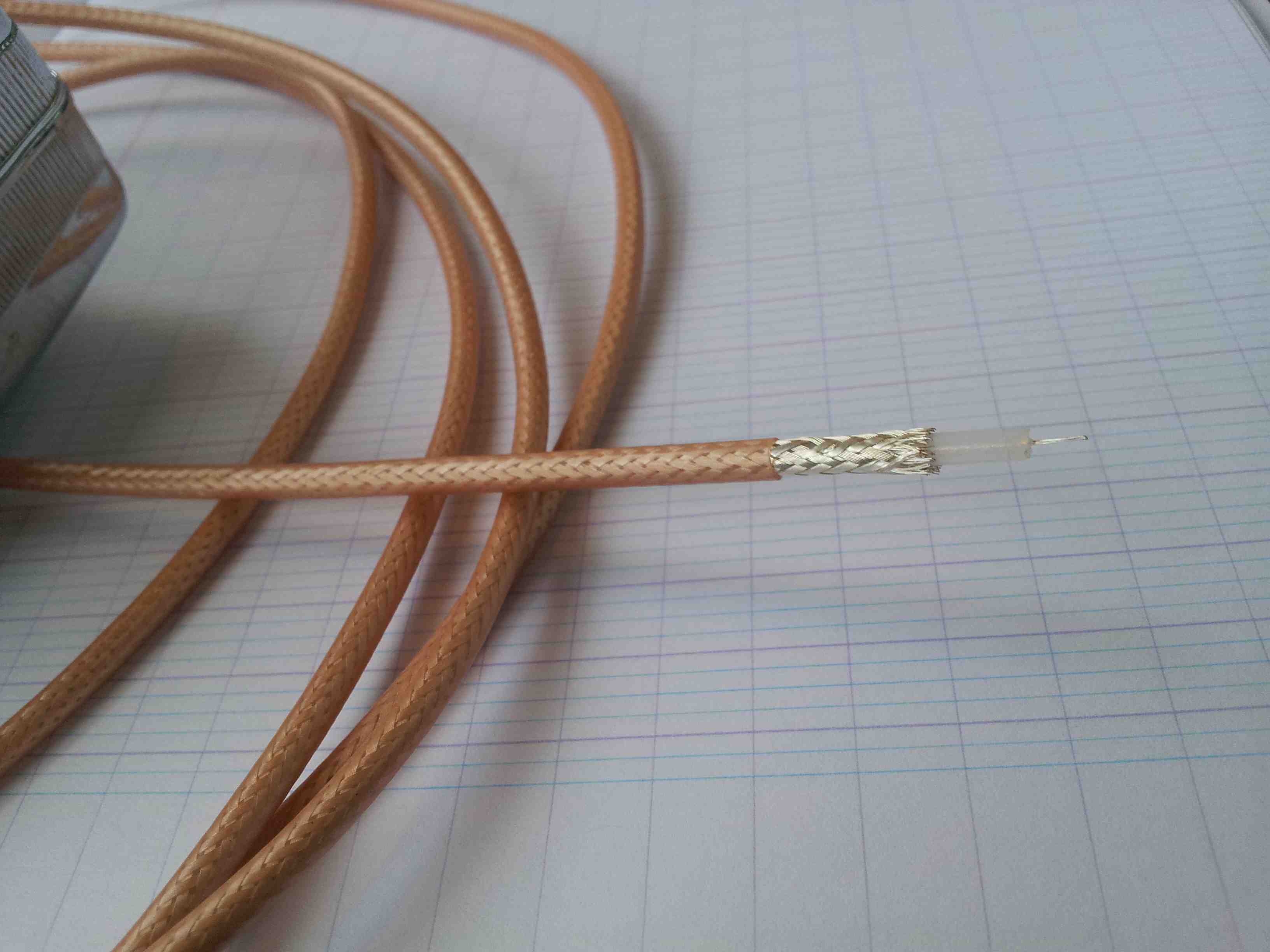

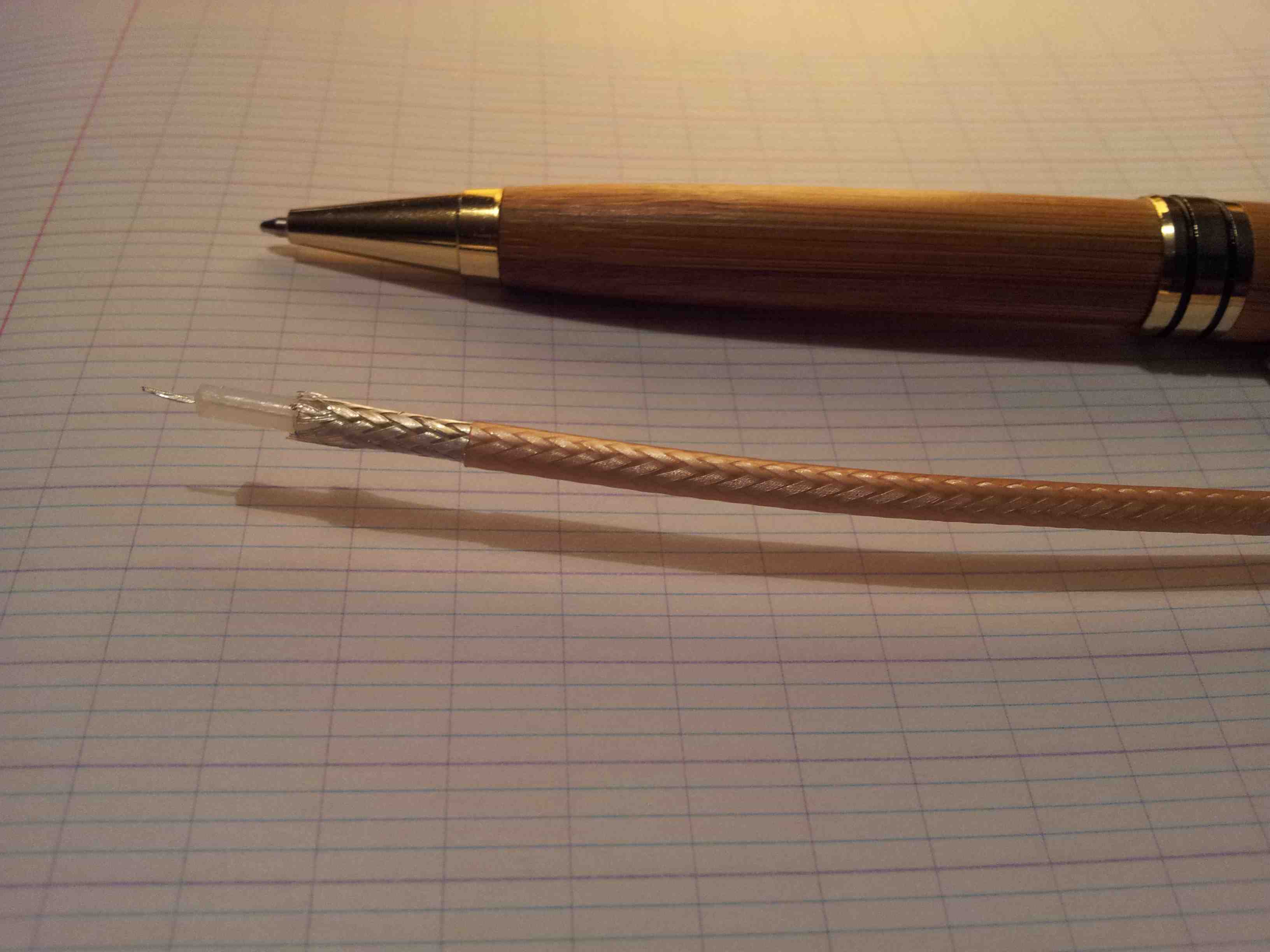

This last picture from Vishay document is a try at home i am very motivated.😀At the evening i thake pictures of ready made shielded wires first is old Isoda from Japan hybrid metals , next is one candidate i begin collected some quality samples...:magnify:
What brands of wire You work?
Thanks again 2 Pico Dumbs
Best regards

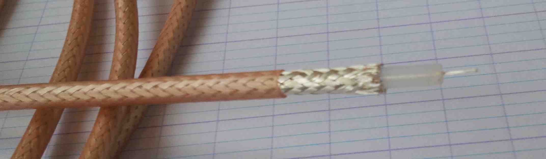

If you use coax then the shield is the return and the return must be connected to signal ground at both ends.
I used to use a Belden tan colored coax like the last 2 pics. I then learned the use of Ferrous metals in your wire is bad. The shield on the coax I was useing is not totally copper and will be attracted to a magnet. So I don't use it anymore 😀
Well, I can't really explain it, or wont, but, John Curl Said it and I beleieve him more than the ego scientific f$%^&s that won't give him a break. Nobody buy's their stuff!
So what was that small tan colored coax? is it .100" teflon insulated 28Ga. or???
