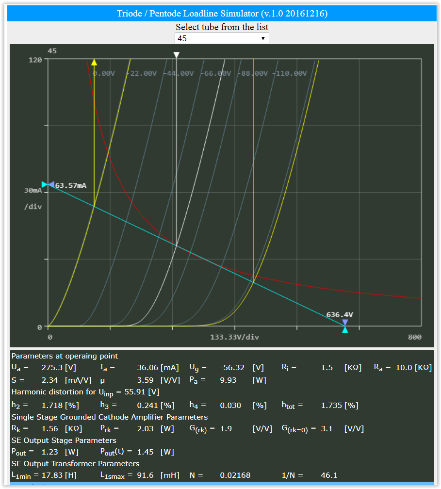

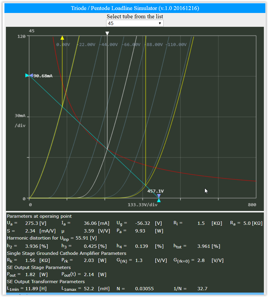

Best SE output transformer for 300B - shootout
i think the 10k is just better.
5k is "shooting into knee" , i hate that sonically
same loudness, but not the THD profile !
I like 7k for the 45, but primary inductance, frequency response, power, etc. all play such important role.
7kohm load impedance at what frequency?.
Load impedance is a function of primary inductance with respect to frequency. And that inductance figure for air gapped types depends on DC current through the core.
Change the frequency for a given amount of inductance, and the load impedance changes.
For example, I would like load impedance to be 2x Rp at my lowest usable frequency. That makes sense, a lot of sense.
I know of one winder (recent inquiry, US based, self proclaimed winder of 20,000 items sold), who does not understand this as fundamental, he does not specify, but when asked he admits that his 'impedances' are measured at 1kHz. Then again, maybe he does understand and is chasing better HF response due to less capacities (there is more than one internal capacitance involved) within the transformer. Or perhaps its just a matter of convenience and he doesnt really care - take your pick.
If I see primary inductance specification at a given DC current through the core, I am happy - I can work out the loading to my tube at ANY frequency. Simple.
If I see a '3k3' with in circuit measurement utilising 800 Rp tube at 80mA and quotes -3dB(f) as such, I am happy - and I think it is the latter who fully understands that he needs to provide a bridge to those who do not really understand the nature of the relationship between inductance as it varies with DC current through the core, frequency and how this relates to the impedance which then loads the tube.
Again, to specify a transformer primary as simply an impedance by itself is meaningless.

You are missing a point, which Hanze explained in post #185.
Of course the reflected impedances in your example are the same.
However, for a given impedance to be a real one the value of inductance can not be ignored.
In your example of 1 kHz, and the impedance ratio of 500:1 giving a load impedance of 4k at 8 ohm, the value of the inductance should be at least 637 mH (2.Pi.1000.0,637=4k).
This value of inductance at these frequencies is not a problem also for low quality output transformers.
It matters however at low frequencies; in your example the inductance at 20 Hz, with DC current through the primary, should be 31,83 H.
Now we enter territory where we see differences in quality in output transformers.
Another point to realize is the fact that inductance goes up with higher signal levels; a normal inductance meter only gives an estimation of reality.
