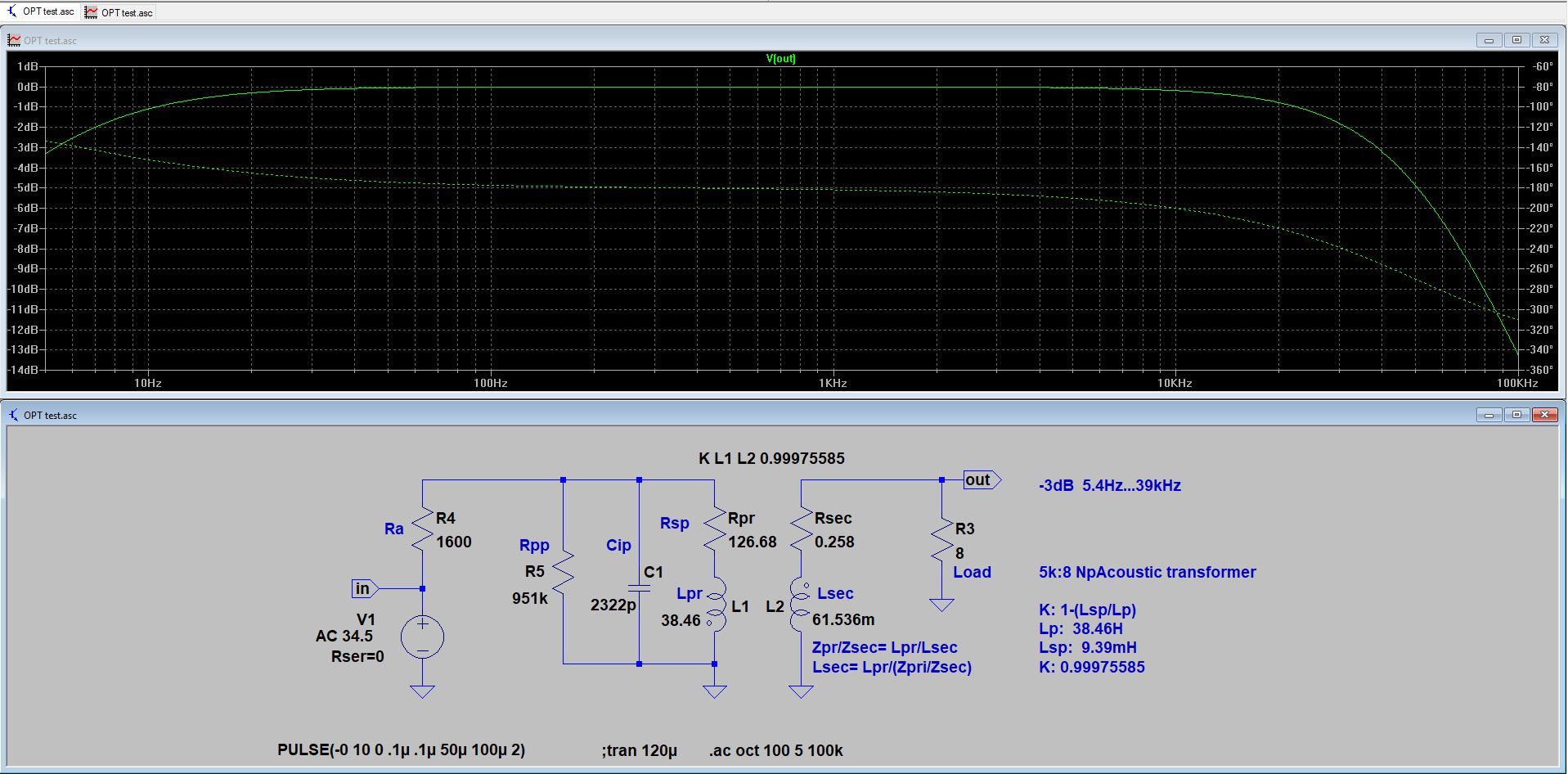

and in particular the performance of the 5K OPT.
If your RCL measurement and my calculation are correct, "real" measurement is coresponding -at HF- to the simulation. :)
