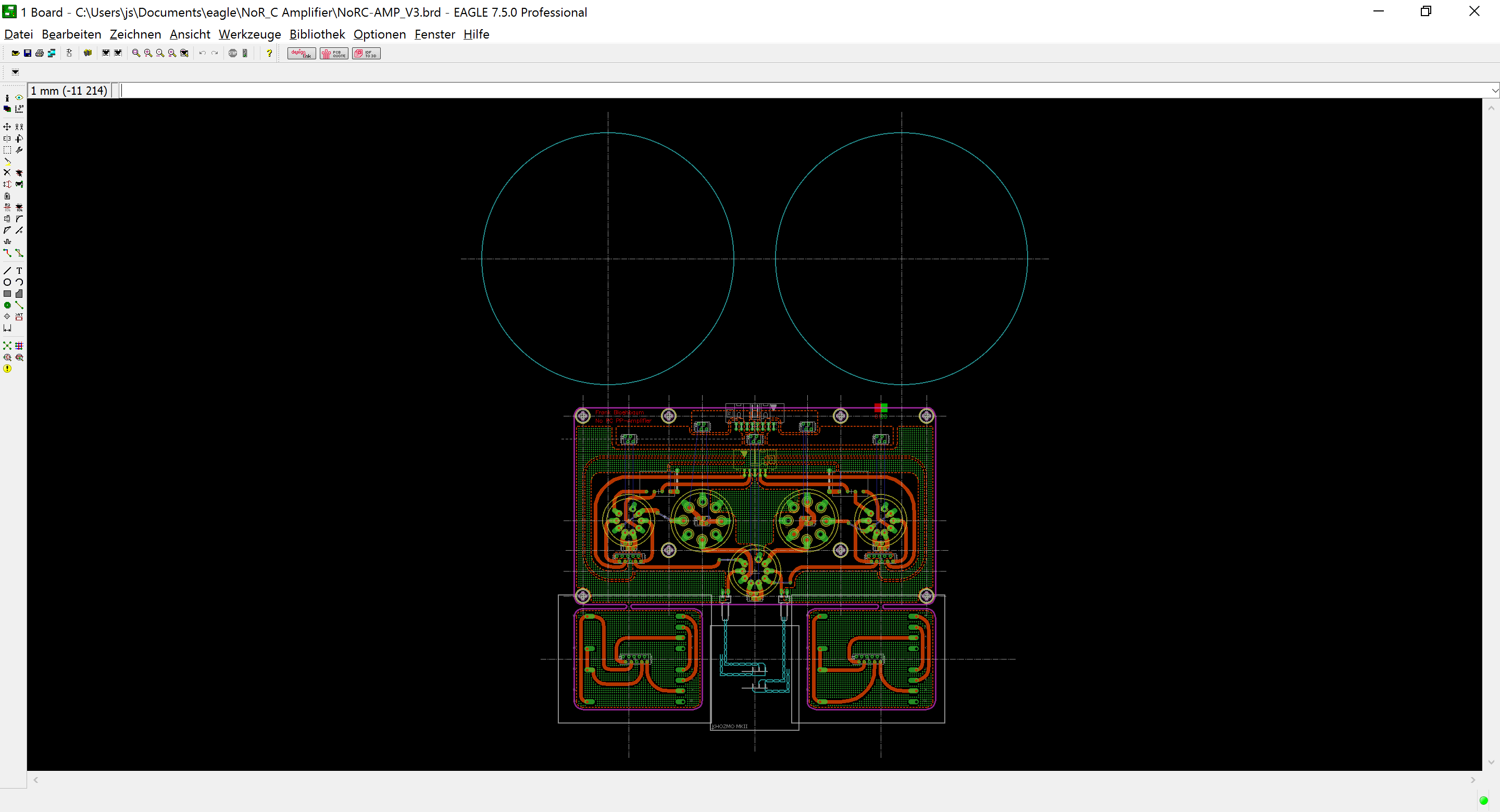

A CCS has especially no place in a minimalist circuit, since it requires at least one additional active element, which is put to better use somewhere else. See #52 for my minimalist design using only two triodes.
I believe anything less, i.e. only one active element, does not classify as hi-fi.

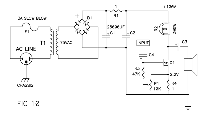

The Delite by Nelson Pass (link to pdf) arguably has one active element: an Nchannel MOSFET. Arguably it classifies as hi-fi based on the good measured results and many very pleased builders and listeners. It's a single ended common source amplifier using a resistor load. The resistor is a 300 watt light bulb.

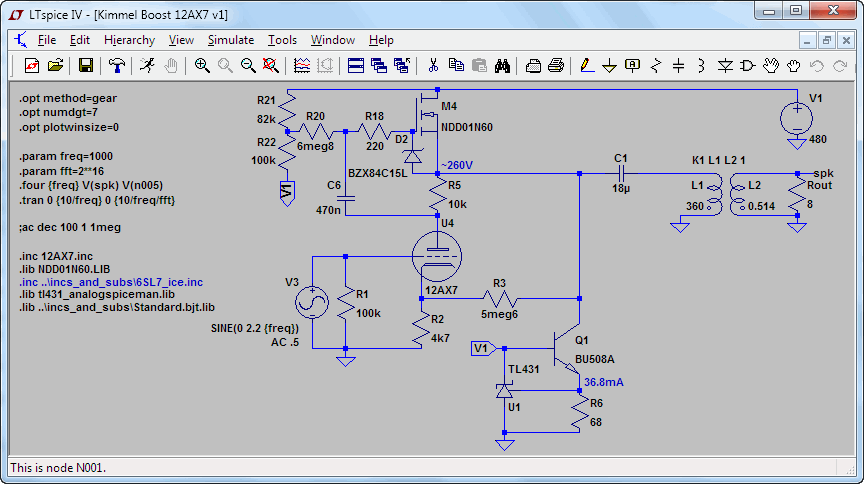

No disagreement here. The tube defines the transfer function. However, all the power drive will be provided by the CCS. See attached example.
attachment.php
~3W from a single measly 12ax7. How can that be?
It's a hybrid topology.
attachment.php
I
What you posted is not a CCS loaded valve amp - the cathode circuit effectively bypasses the valve. In a CCS loaded valve SE the whole current must pass through the valve which contributes almost all of the sonic profile of the amplifier.
Your not really comparing apples with apples.
That's just pointless quibbling. If the top CCS isn't loading the tube, what else is?
The bottom CCS just pulls more current thru the top, boosting the available class A power.
The CCSes provide all the output power, the 12ax7 provides the voltage amplification.
This topology is just a cleverly arranged hybrid amp with a disguised tube VAS and a sand output stage. The fact that you are able to remove the bottom CCS for less output power does not change its fundamental operation.
