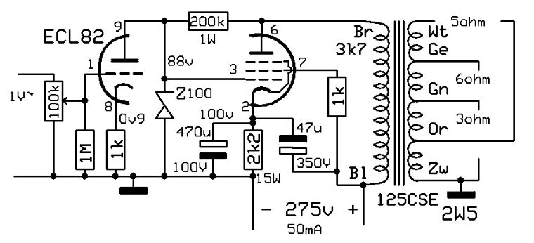

To do the same thing but without the transistor, perhaps like this ?
Interesting, Ketje. Could one use a voltage regulator tube (e.g. OB3 or OC3) in place of the 100V zener, or would that be too noisy to be attached to the output tube's grid? Would there be enough voltage at startup to get it to spark?
That zener never conducts (if everything goes well) It's only to prevent catastrophic current in the pentode if the triode fails or warms up too slow.
Maybe an NE-2 neon lamp could be used instead?

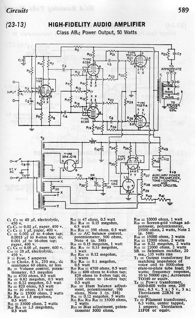

It's an amplifier in the RCA manual and sounds good, I was going to build it but with the speakers I had I didn't need that much power. The speakers you are interested in are fairly efficient and you can probably get away with a 20 watt amp if the room isn't huge and or you don't need ear piercing levels of playback. I built the Mullard 5-20 circuit with some minimal changes like wiring the front end pentode as a triode. It has a large following, many builders on here have built and are very happy with the results.
I recommend the Mullard 5-20 circuit.

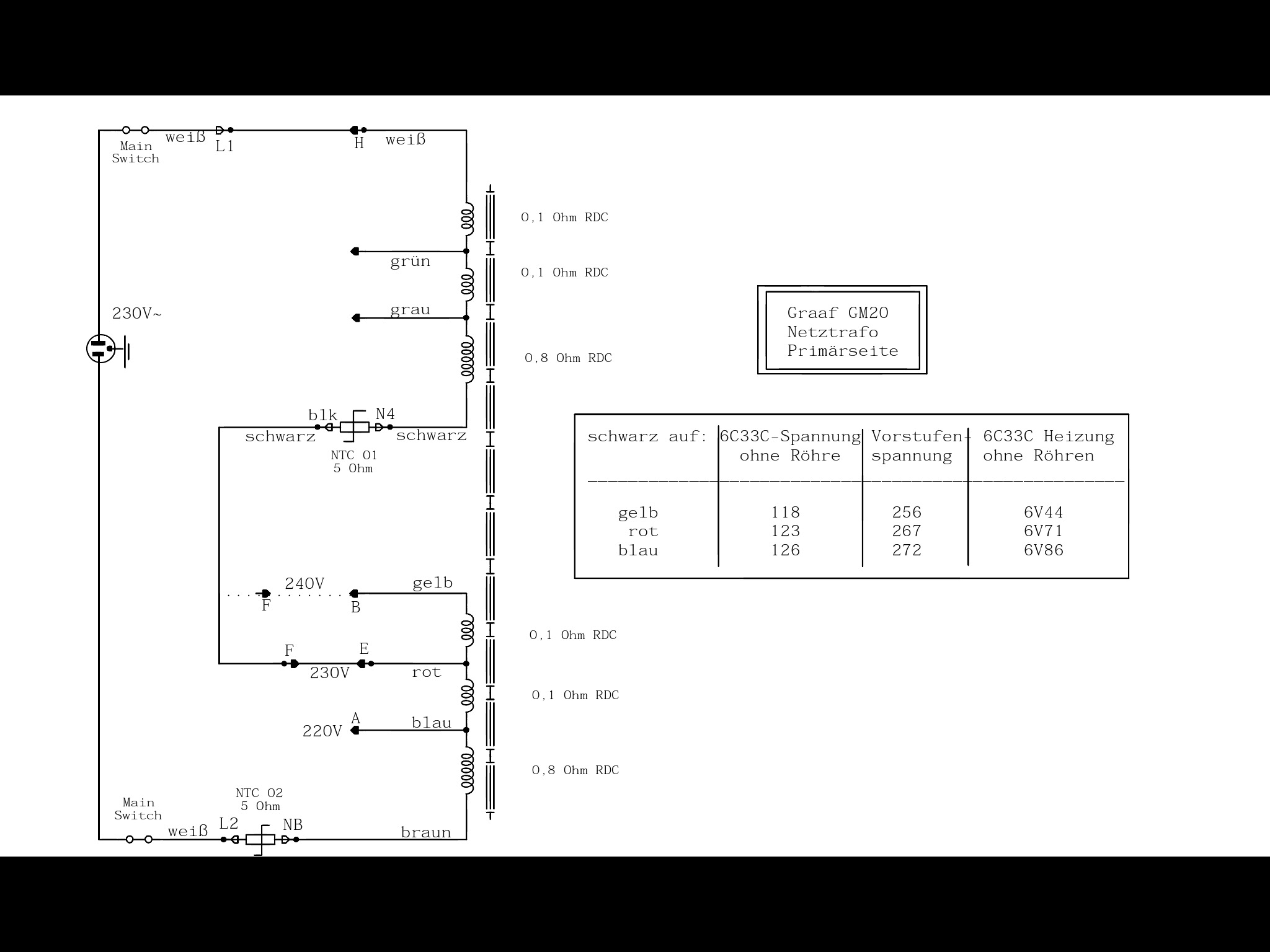

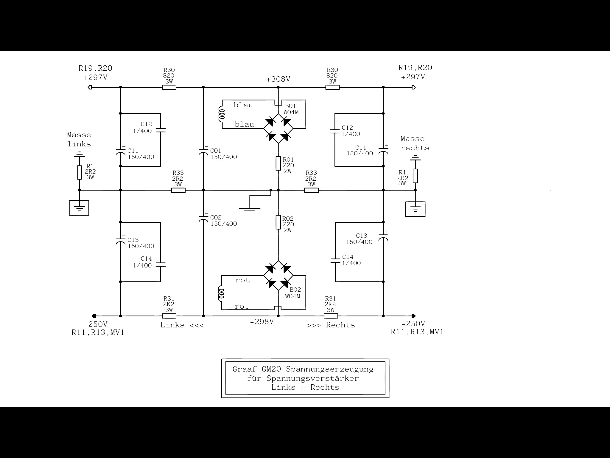

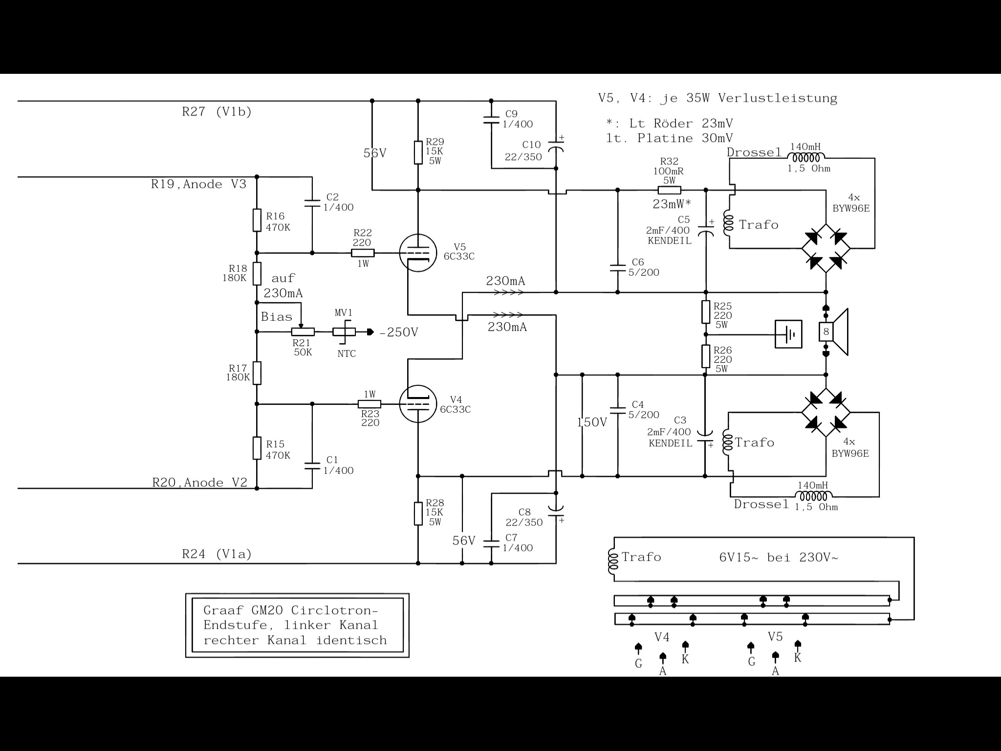

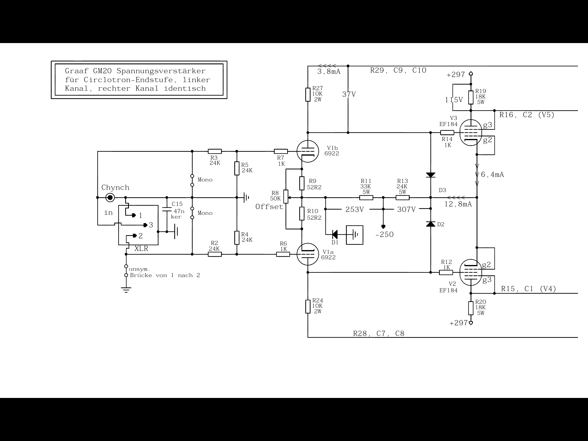

I used graaf gm20 diybuild with tannoy dual concentric for many years.
This otl concept is easy to build. Very good match.

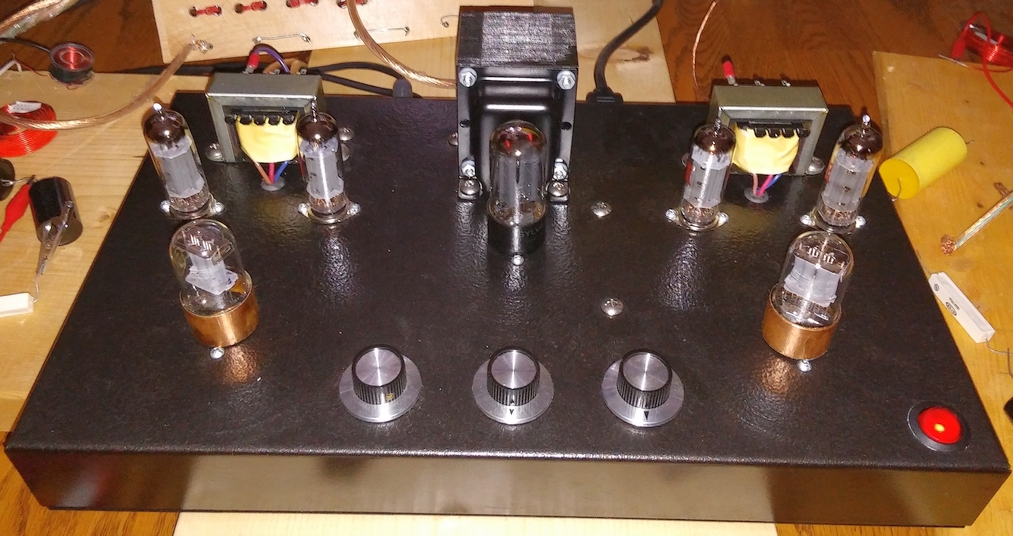

Just finished a triode EL84 amplifier which runs quite low voltage and can be build for around $1000 canadian,
It has the 'beautiful' tube sound that people want, with high distortions, however the sound is quite good even compared to the best amplifiers, distortion is 0.3% at 1Watt, 0.72% at 2 Watts and 10.4 % at 4 watts (all RMS watts of course!)
Transformer is triode 10 watts, bass is not well defined but all there due to extra harmonics, high frequencies are poor, there is no sparkles of the top end, 'air' is average, instrument separation poor.
this is with 87db speakers, it could be a different story with 95+ speaker.
