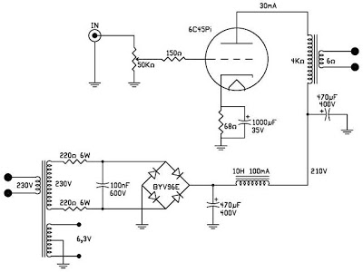

i am clueless as how a SE El84 / SE 6sn7 can be of any use to anybody.
I strongly believe it would sound worst than a 15 $ transistor amplifier
It is very easy to build one and find out why there are so many who like them. If you have not listened or made on for your own amusement or edification then you can only wonder.

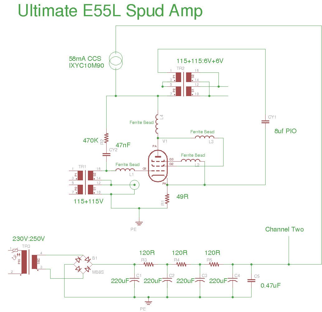

A CCS has especially no place in a minimalist circuit, since it requires at least one additional active element, which is put to better use somewhere else. See #52 for my minimalist design using only two triodes.Also a CCS has no place in such a design or any other SE design for that matter.
I believe anything less, i.e. only one active element, does not classify as hi-fi.
There is one place in which a CCS has a role in an SE and that is in a parafeed plate load.
I have to disagree with your other point as I can attest that a single E55L make a very high performance 3w amp.

Eh, maybe... Even an EL84 makes a decent spud with an input transformer if your signal is hot enough, as do some of the subminiature tubes, depending on desired power. If one watt or so will drive the intended speakers you would be surprised at the options for a nice low THD single tube solution.
Shoog
Agreed, although a plate load CCS can be useful for a driver tube too, depending on what your goals are.
In that topology, the CCS plate load essentially becomes the output stage, delivering all the power. The tube effectively drives the CCS "from the bottom".There is one place in which a CCS has a role in an SE and that is in a parafeed plate load.
I don't like it, and it's no minimalist.
I looked at you "ultimate" design, and it's of the topology above.I have to disagree with your other point as I can attest that a single E55L make a very high performance 3w amp.
Problems with single triode (pentode, whatever) spud amps is tube tolerances and Zout, which means channel imbalance and boomy single note bass. Certainly not hifi.

I have to disagree, the output tube is definitely the dominant sonic component since its impedance is always lower and in parallel with the plate load. Parallel loads always tend to the lowest impedance component - ie the valve not the CCS.In that topology, the CCS plate load essentially becomes the output stage, delivering all the power. The tube effectively drives the CCS "from the bottom".

This applies to just about any of the many zero feedback SE designs out there. Couple them to the right sort of high Q OB speakers and they work just fine. Try to drive a standard sealed box with them and you will get the results you imply - but that applies to just about all SE amps. If you want what SE has to offer then a spud can deliver all the best aspects of SE in spades.I looked at you "ultimate" design, and it's of the topology above.
If you are implying that only a feedback dominated amplifier can deliver HIFI - then I am just going to have to disagree with you.
Having said that, I would always tend to prefer a PP amplifier over an SE one, and always local feedback over global. Still I have that E55L amp in daily service and it performs very well with my OB three ways speakers.

No disagreement here. The tube defines the transfer function. However, all the power drive will be provided by the CCS. See attached example.I have to disagree, the output tube is definitely the dominant sonic component since its impedance is always lower and in parallel with the plate load. Parallel loads always tend to the lowest impedance component - ie the valve not the CCS.
~3W from a single measly 12ax7. How can that be?
It's a hybrid topology.
I'm not. But the the high gm thoroughbred tubes proposed for spuds exhibit much more sample to sample variation than quality audio finals used for more traditional SE amps. Some nfb is a proper measure to tame these.If you are implying that only a feedback dominated amplifier can deliver HIFI - then I am just going to have to disagree with you.
No disagreement here. The tube defines the transfer function. However, all the power drive will be provided by the CCS. See attached example.![]()
I
What you posted is not a CCS loaded valve amp - the cathode circuit effectively bypasses the valve. In a CCS loaded valve SE the whole current must pass through the valve which contributes almost all of the sonic profile of the amplifier.
Your not really comparing apples with apples.
As for this, its just about the same as almost all SE amplifiers - so your point is - SE amplifiers are fundamentally flawed, well I must agree.
However my experience with premium valves, such as the E55L, doesn't really back up the claim that this is a major issue to deal with.
Shoog
That's just pointless quibbling. If the top CCS isn't loading the tube, what else is?What you posted is not a CCS loaded valve amp - the cathode circuit effectively bypasses the valve. In a CCS loaded valve SE the whole current must pass through the valve which contributes almost all of the sonic profile of the amplifier.
The bottom CCS just pulls more current thru the top, boosting the available class A power.
The CCSes provide all the output power, the 12ax7 provides the voltage amplification.
This topology is just a cleverly arranged hybrid amp with a disguised tube VAS and a sand output stage. The fact that you are able to remove the bottom CCS for less output power does not change its fundamental operation.

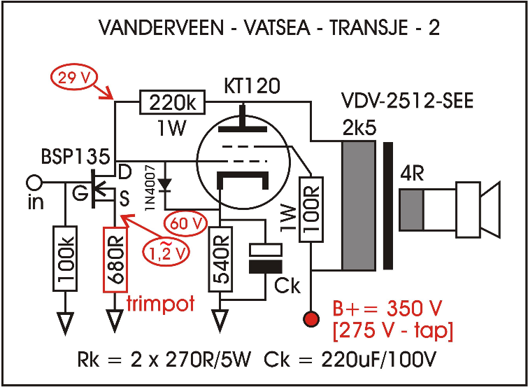

Cool design! what if we were to use an ECL86 for a little more power out? Probably use a Hammond 125DSE instead of the CSE? Anything else?To do the same thing but without the transistor, perhaps like this ?
