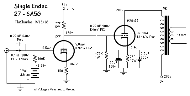

There's no such thing as "best" but here's a fairly simple, low parts count, amp I built using a 27 as input and a 6A5G output. I wanted to build a true SET, not a triode strapped pentode. The tubes were chosen to hopefully get close to having all the sonic advantages of using DHTs like the 26 and 2A3 while still being able to use basic AC heating.
Because it uses indirectly heated tubes it doesn't require any special efforts to deal with hum. Most designs using directly heated triodes require DC heating of some sort which can add to the complexity quite a bit, depending on the method used.
Perhaps I'll post more details about it in a separate thread sometime.

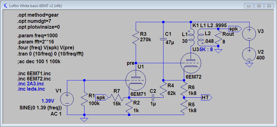

The best simple SE circuit, Loftin White, see attached pic for a 6EM7 spud implementation. It's remarkable properties have been discussed somewhere else. The most important in the minimalist spirit would be the really low PSU requirements, compared to traditional SE amps.
Just have to disagree. Simple but fundamentally flawed. Better designs are available.Ah the RH84, IME, that is a very simple but very good sounding amp. If you spend money on better output transformers the amp will also produce better sound. The biggest thing is to make a very good power supply, which is also true of any single ended amp. There has been many, many builders of this amp and if that is any indication of worthiness, then you would be in good company.
