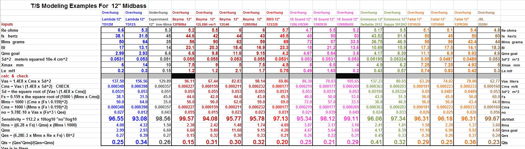

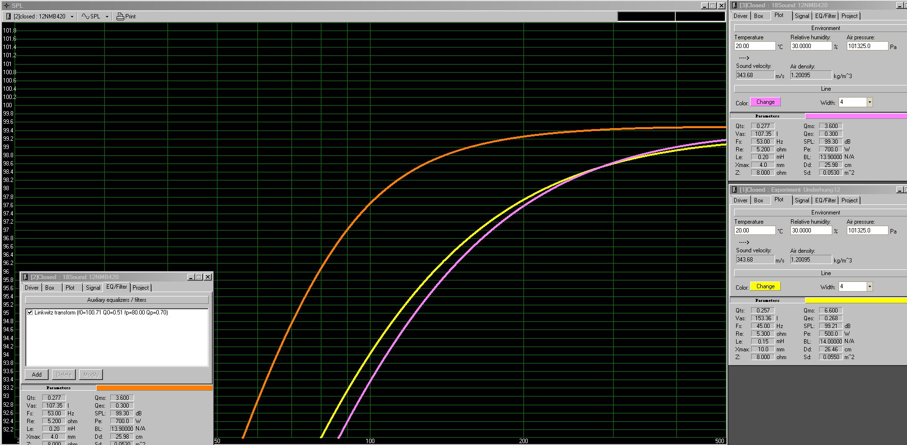

Mark Levinson stated that the Daniel Hertz M1 uses custom drivers. Attached T/S spreadsheet of high quality production 12" midbass. The M1, similar to the Geddes Summa, decided to create an audio illusion which includes room effects below the horn/baffle polar control frequency.
A 3-way M1-type design (woofer+midbass+CD/Heil) which uses a 12" midbass for high efficiency would have a few design decisions:
1) sealed volume midbass
2) ported/aperodic volume midbass
3) active Xover with equalization
4) passive Xover with port tuning options for passive room bass equalization
5) Low(<0.2) Qts 12" midbass to optimize tweeter sonic interface
6) medium(0.3-0.4) Qts midbass to optimze bass sonic interface
The Qtc=0.15 Beyma 12" midbass is an interesting solution for a large'ish low Qts sealed volume with active Xover that blends well with the CD/HEIL tweeter.(1)+(3)+(5) or (1)+(2aperodic)+(5). The 12P80Nd and 18P80Nd share Beyma's latest motors and cones.
The Qtc=0.29 18Sound 12MBW420 has a very light(33g) cone that makes it a good solution for passive Xovers. (1)+(4)+(6)
An underhung motor with similar T/S specs is possible, and would allow more Mms in the cone material, and waste less Mms in the voice coil.

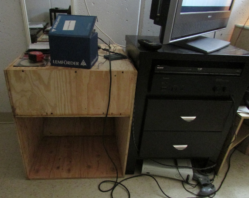

hi Sergey
can you show a cross section drawing to see how the horn is folded, and dimensions ?
Listening to a wide variety of music through my system in the last few days, after i got amplification finally right. Its a lot of fun.

?? Has anyone built a 60 x 40 horn/wavegide for the Beyma TPL-150 with 1600Hz Xover ?? (PK??)
WE HAD A DREAM... that the TPL-150H could be crossed at 1,200Hz with low distortion and HEAVENLY 99db/w dynamics, plus controlled directivity up to 20khz so it could be seamlessly mated to a high efficiency 10" or 12" midbass for a >96 db/w watt speaker.
BUT... There is a difference between covering a frequency range with flat frequency response, and sounding beautiful while doing so.
The group brain trust said .. NO .. not 1,200Hz ... high distortion data when 1,200Hz tone is combined with 10Khz+ tone.
The group brain trust said ... not 1,400Hz ... the TPL-150H sounds strained.
The group brain trust said ... OK if >1600Hz, and the TPL-150 driver benefits from removing the rear chamber and felt damping pad, and allowing the rear exit into a large damped chamber. THD is reduced by almost 20 dB by doing this.
Two common ~1600hz Xover combinations:
1) standard 80x40 horn with an 8" midbass, add a 15" woofer. Avoids MTM lobing. Sd of 6" midrange ~0.013m^2. Sd of 8" ~ 0.022m^2
2) NEW 60x40 horn/waveguide with a 12" midbass Xover 1600Hz, add a 18" woofer. The controlled directivity function narrows at a low'ish frequency to gain efficiency of large midbass.
