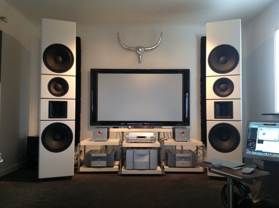

LineSource,
Perhaps you should take the initiative to lead a project to develop one together with the group brain trust, very much like how the SEOS waveguide was developed. Use the new TPL-150/S or TPL-150/B as base and liaise with horn.pl to do the mould. Then put me on top of the list for 5 of them 😀
I actually had a fairly large (app. 20 cm deep) 60 x 30 degree waveguide build for the Beyma TPL-150 in order to match my 60 x 30 conical mid horns. Obviously, the dispersion was now matched successfully, but I had also hoped that the larger waveguide would load the Beyma TPL-150 down to 1,000 Hz were my conical horns with the Fane Studio 8M roll off. However, it did not. I do not think that the Beyma TPL simply can be taken any lower than 1,200-1,300 no matter the size of the waveguide.
However, that being said I really like the sound of the Beyma TPL-150H (to my ears significantly better than the compression driver/horn combos that I have tried), and contrary to some other people I actually feel that it can be used down to 1,300 Hz (with the Beyma waveguide) or so, but this may have to do with the fact that I use fairly steep filters (at least 24 dB/octave).
The real problem is finding a cone driver that keeps up with the Beyma with regards to speed, clarity and resolution. The Fane Studio 8M sounds great in a horn, but rolls of in my conical horns around 1,000 Hz, so recently I have been trying out different drivers in an OB (10" PHL 3451 and double 8" Audax HT210T0). Both the PHL and the Audax sound fairly good, but I still feel that they struggle a bit keeping up with the Beyma.
I wish that Beyma (or someone else) would make a GIANT (and affordable) amt that would work down to, say, 700 Hz and all the way up! Some of the new Pro Mundorf amt's may do the job with the right waveguide, but unfortunately it is so expensive just trying it out.....🙁
Best regards
Peter

?? Has anyone built a 60 x 40 horn/wavegide for the Beyma TPL-150 with 1600Hz Xover ?? (PK??)
WE HAD A DREAM... that the TPL-150H could be crossed at 1,200Hz with low distortion and HEAVENLY 99db/w dynamics, plus controlled directivity up to 20khz so it could be seamlessly mated to a high efficiency 10" or 12" midbass for a >96 db/w watt speaker.
BUT... There is a difference between covering a frequency range with flat frequency response, and sounding beautiful while doing so.
The group brain trust said .. NO .. not 1,200Hz ... high distortion data when 1,200Hz tone is combined with 10Khz+ tone.
The group brain trust said ... not 1,400Hz ... the TPL-150H sounds strained.
The group brain trust said ... OK if >1600Hz, and the TPL-150 driver benefits from removing the rear chamber and felt damping pad, and allowing the rear exit into a large damped chamber. THD is reduced by almost 20 dB by doing this.
Two common ~1600hz Xover combinations:
1) standard 80x40 horn with an 8" midbass, add a 15" woofer. Avoids MTM lobing. Sd of 6" midrange ~0.013m^2. Sd of 8" ~ 0.022m^2
2) NEW 60x40 horn/waveguide with a 12" midbass Xover 1600Hz, add a 18" woofer. The controlled directivity function narrows at a low'ish frequency to gain efficiency of large midbass.
" Fastest" 8 inch midrange to match TPL

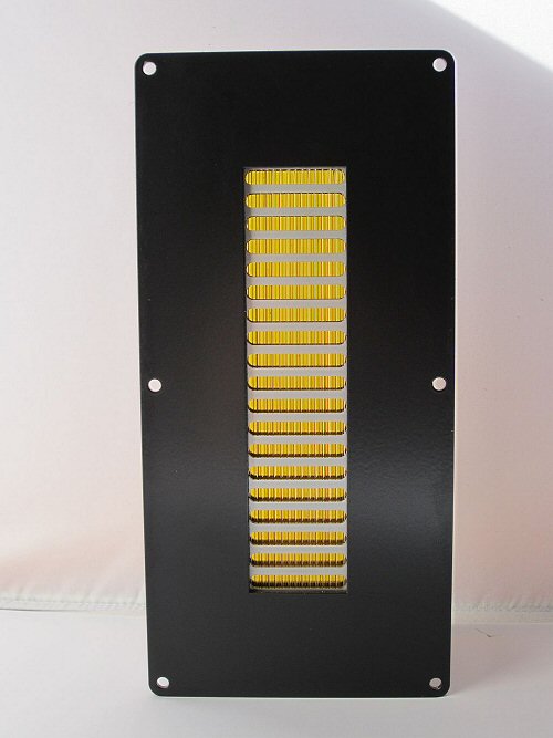

Best regards
Peter
Hi Peter
beside Mundorf, there is Bernd Lohmann from Germany. He builds amt's that go down to 600hz, and he is developing one that goes down to 100hz
Inferenz 345 Digital Dipol Ripol - Seite 3 - DIY-HIFI-Forum
bel-AMT: ausführliche Vergleichsmessungen von Ton-Feile, Lautsprecher - HIFI-FORUM
the price back in 2008 was Euro$ 235,00 a pair for the top model, which is very fair. Don't know how much he is charging today. Customers commented that his service is excellent. Email address is bel.amt@gmx.net
best regards
Angelo

Thanks for the input Derek. Much appreciated. 🙂 the Stig definitely knows what he is doing. That I hear every day. But as mentioned, also he has acknowledged that the inConcert Miles would benefit from a dedicated midrange. He has recomended the 12G40, and there is at least one high profile "Miles"-system here in Norway that uses this midrange. Personally I have been eyeing the 10MI100. Both because of the high effiency, and the fact that many concider it a great midrange.
I like to build my own speakers (I have Econowaves in my living room, in addition to the Miles) but lack technical knowledge. As to your characteristic number three...could you elaborate on what you think would be the best xo-point for a 10"? I know this is a bit general but bare with me.
Any thoughts on the 15" spacing question in my first post..?
