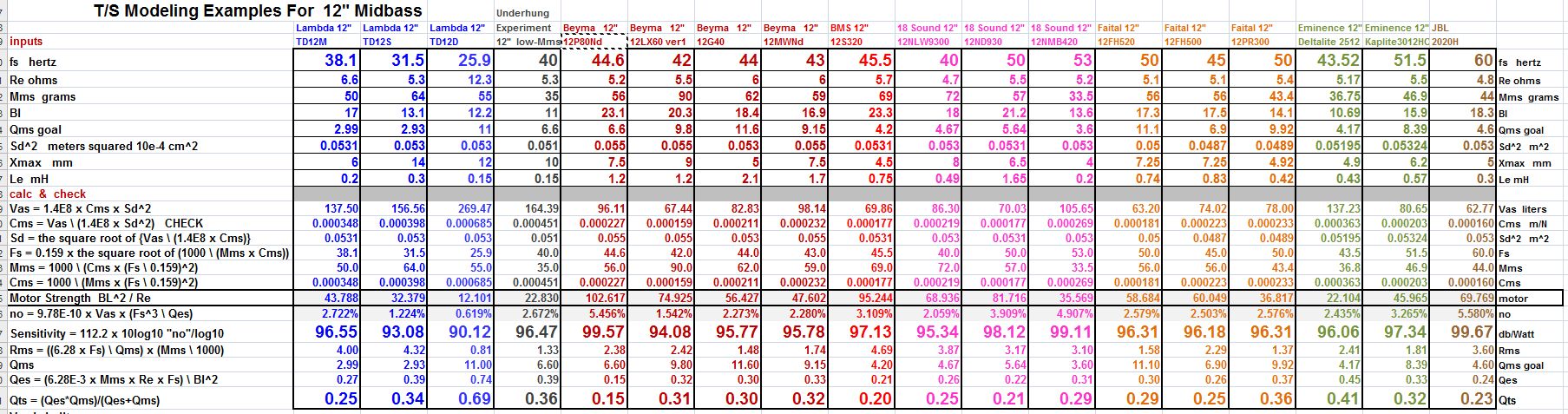

The equation Bl^2 / Re is often considered useful in estimating the motor strength of a driver. The Beyma 12P80Nd has the highest Bl^2 / Re among common 12" midbass candidates. This may explain why SOME ears like the 12P80Nd with its low Qts = 0.15 and middle-road Mms = 56g as a high efficiency midbass. Distortion data is also very good, especially for a 99db/watt driver.
It would be interesting to hear if anyone has done a direct comparison between the 12P80Nd and PHL or BG Neo as a midrange under the TPL-150.

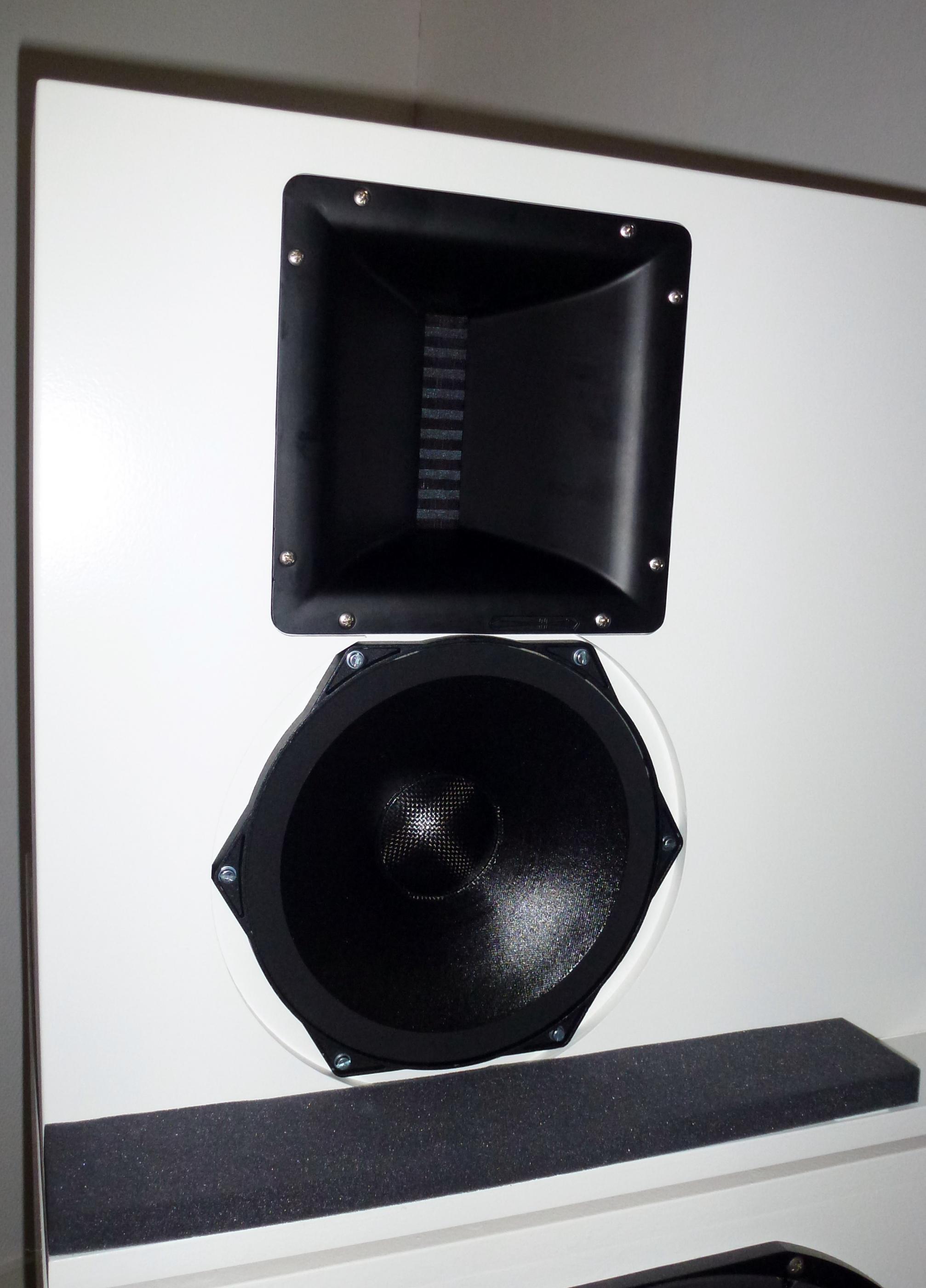

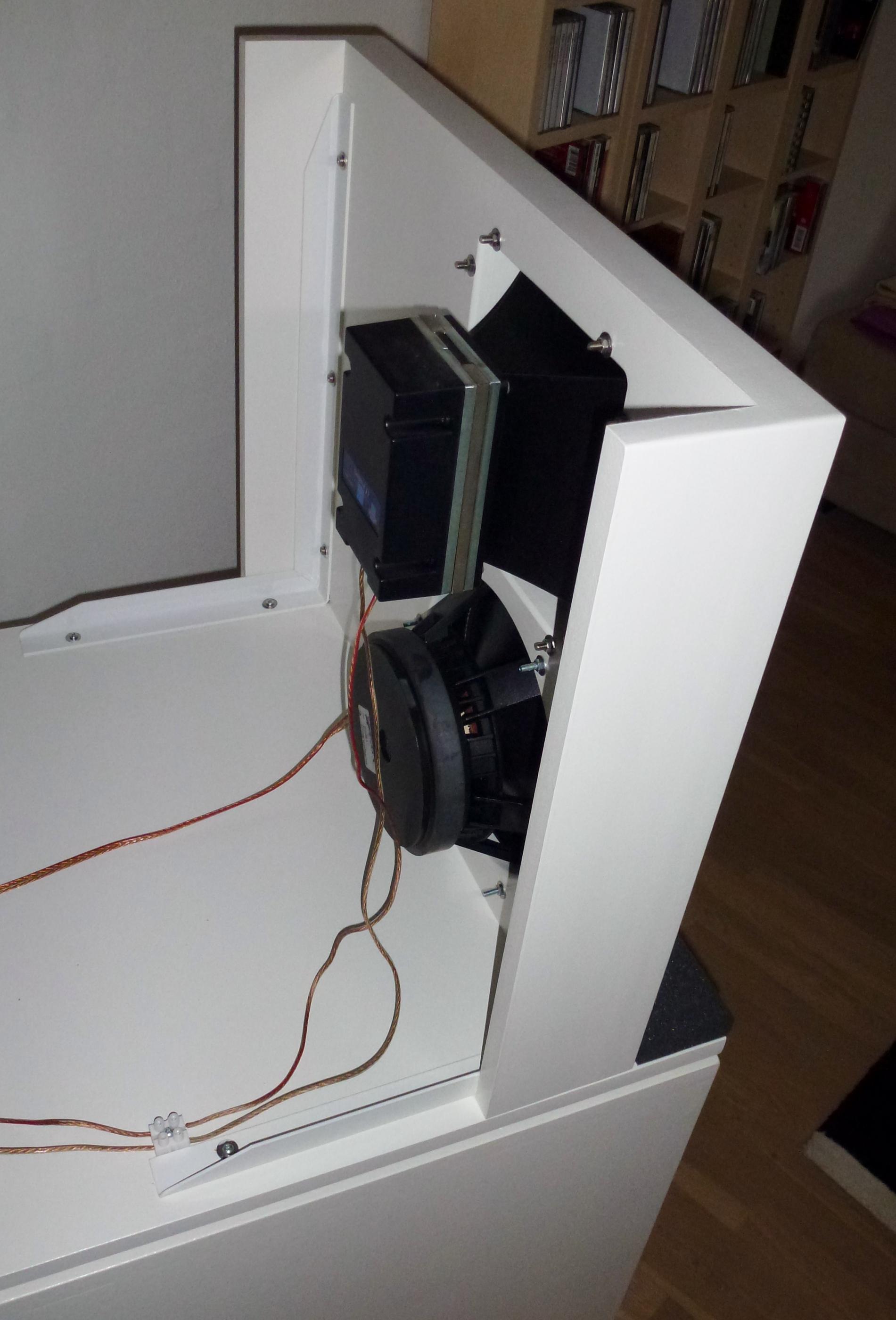

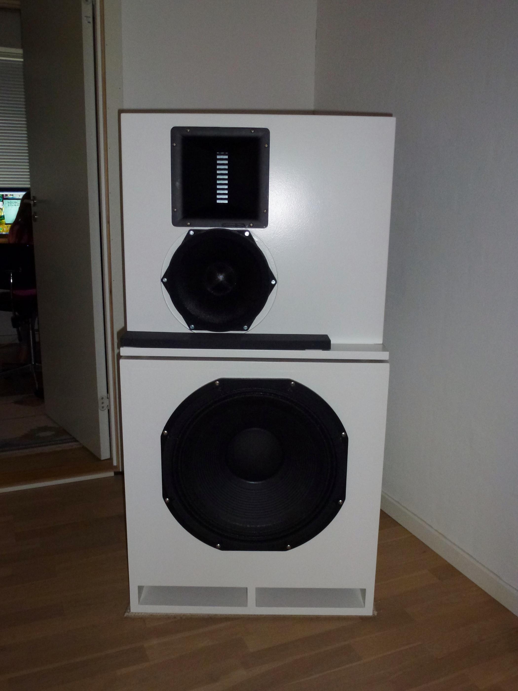

As promised, here are a few pictures of the current system using a Fane Colossus 18XB, PHL 3451, and Beyma TPL-150H. Crossover points are 200 and 1511 Hz, active crosovers 24 dB/octave, and triamped.

hi Peter
do you like the phl better than the p.audio you had before ? do you use it in the same conical horn ? any pic of your actualized system ?

Hi Peter
how do you like its performance ? have you tried to take off the back cover of the tpl150 ?
Angelo
Hi Angelo,
I do like the performance of the system, and the sound of the PHL is not that different from the Fane Studio 8M in my conical horns, but I still feel that the 500-1500 Hz could be clearer and faster🙂

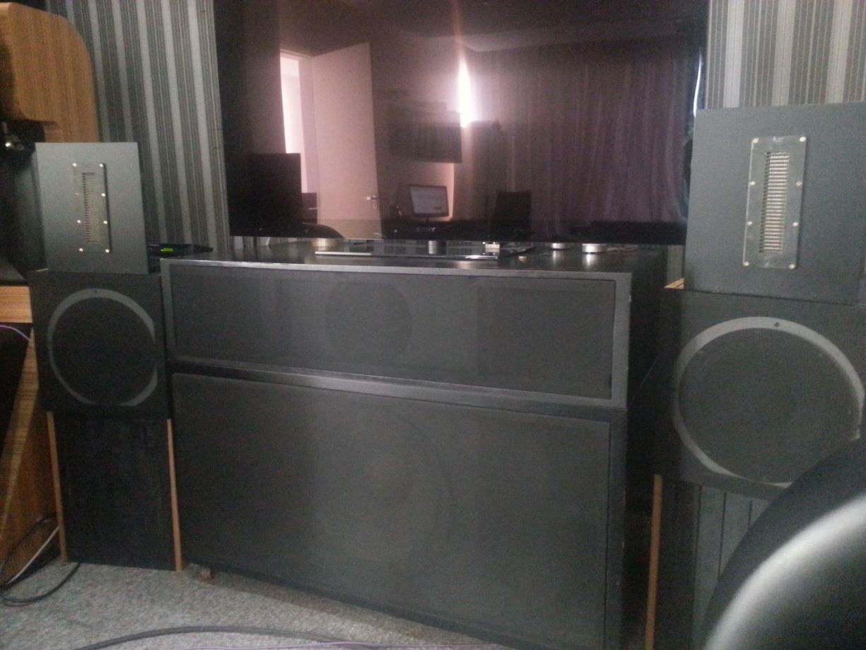

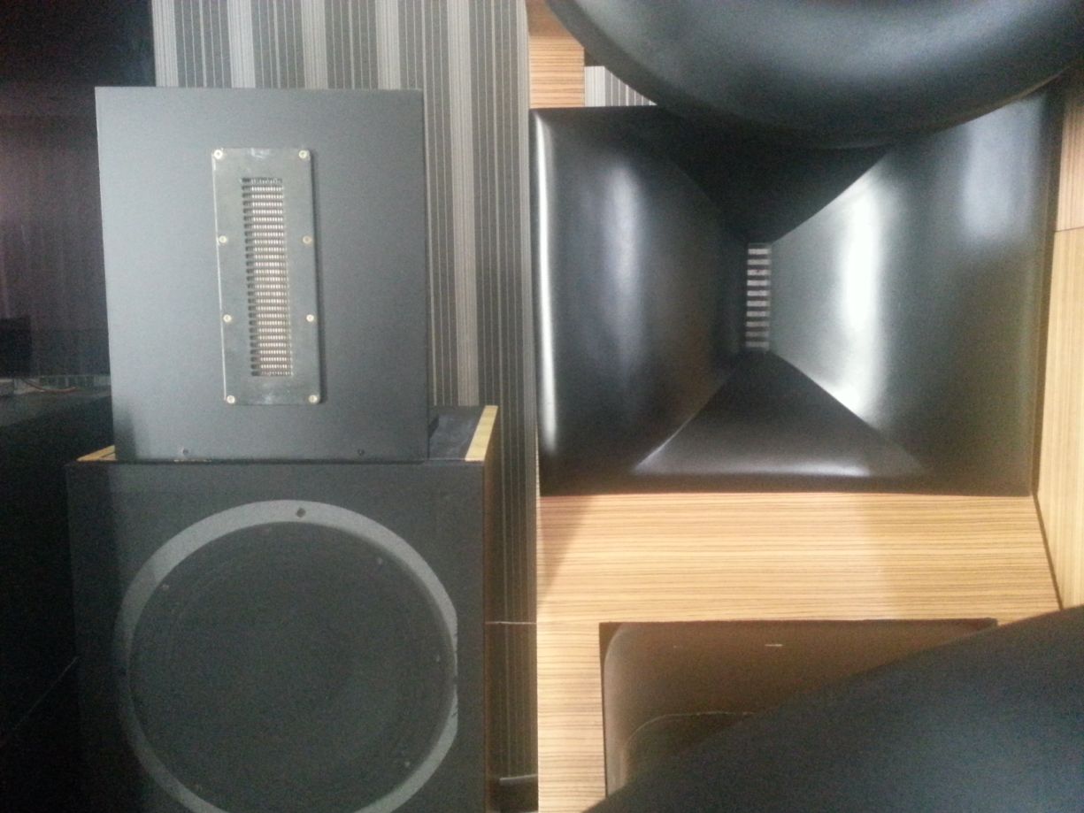

Raymond ( RayCtech ) sent me a pair of his midrange amt's for testing. I made a baffle for them ( 35cm x 30cm ). Back, its open, so it runs dipol. Today i hooked them up for the first time mounted on the baffle. I crossed them at 300hz , first order. Below,i use the Beyma 12p80Nd up to 300hz/24db.Since these are prototypes, and where folded by hand, they are not 100%, so at higher spl , at peak, there are some resonances, but nothing too much to bother. Integration with the woofer is not perfect, i will have to tweak and make some adjustments in the next days. Will do maybe also some measurements. So what are the first listening impressions? I would say, my reaction is similar as with the Beyma TPL150, when i listened to it the first time. It sounds very, lets say unspectacular. But in a positive way. It is extremely neutral,natural, open, revealing,fast, with correct timbre and tone. Voices sound simply as they should. I played already all kind of music, classical, jazz, vocals. It covers a very wide range, just as a guess, flat up to 10khz. More to come....:=))
Angelo
on the first picture, a size comparison with the Beyma TPL150
Angelo
