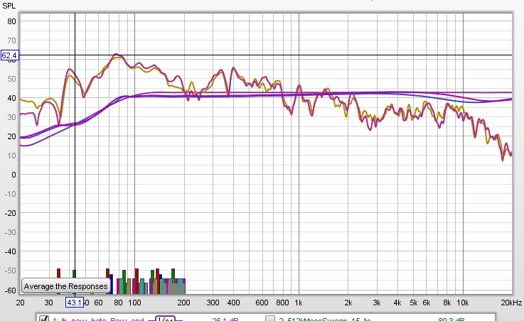

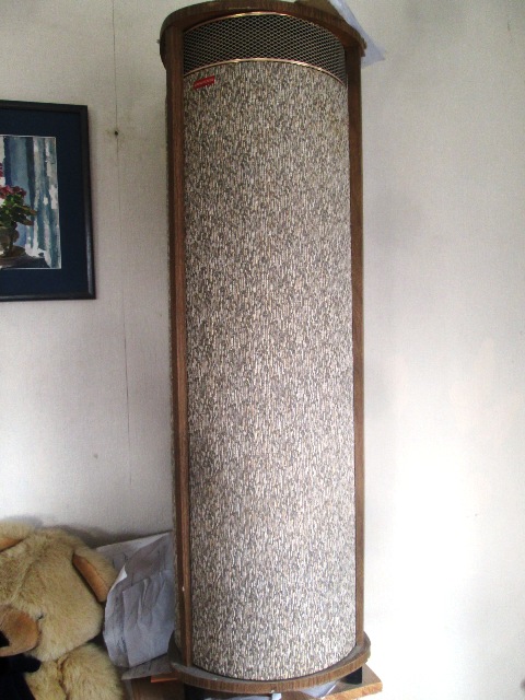

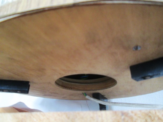

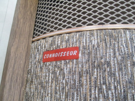

It's not R & A, it's RICHARD ALLAN! My original ones I bought from the factory in the 70s. Everyone has always said they sound really good. If you check carefully you would find the CG8/T had very large powerful magnets which the other 8" variants didn't. Having put the CG8 v the T variant side by side and compared, the CG8 was flat and uninteresting compared with the 8T, and the other 8" drivers they made weren't good either. In the end I was extremely lucky to get a pair of ancient sugden connoisseur vertical speakers which also had the RA drivers in. Once changed from the original "ordinary" 8" drivers to the 8T they make a really outstandingly good rear surround speaker, as it's a vertical bass reflex omni design.
Here is the interesting speaker. This goes back to early 60s & I have never seen another design like it.
Note the roll off of the mic and amp measurement system below 80hz.
The large spike at speaker resonance (77hz & 41hz ) is perfectly correctable with a DSP.
