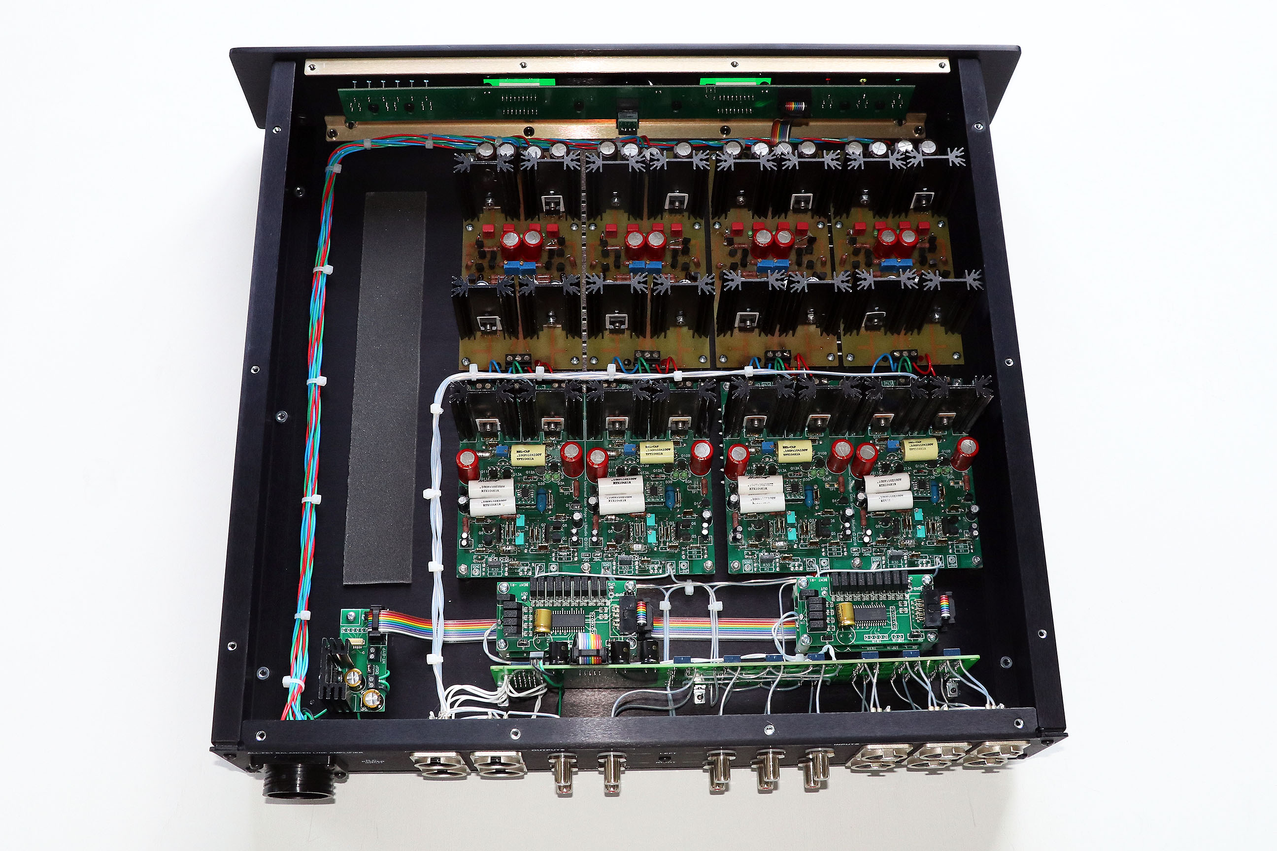

Amp is Borbely Millenium. Biased at 2.5 amps in the original 1980 Krell KSA 100 chassis.
Hexfet bridges, one for each polarity. TO3 output devices.
The Borbely balanced, direct coupled, jfet/fet preamp, dac, phono stage have over 160 BG caps as Ps bypasses. Gain stages are N and Nx , shunt regulators are FK and N. Preamp in the picture, power supply is a separate chassis, discrete stepped attenuator, RTX servo, teflon bias bypass, 90 ma output stage bias.
