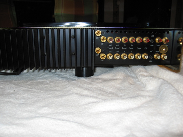

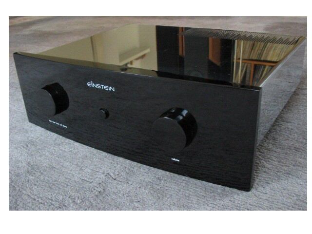

Some years ago I had an integrated amplifier from Einstein (model: "THE AMP", internal as dual monaural version) for repair.
Each half uses 19x 1000uF in parallel mode. After addition of one additional 10.000uF/63V (Siemens LL) with srew terminals for each half sound quality enhances dramatically.
Schematic and outside pictures you will find in the attachement.

Some years ago I had an integrated amplifier from Einstein (model: "THE AMP", internal as dual monaural version) for repair. Each half uses 19x 1000uF in parallel mode. After addition of one additional 10.000uF/63V (Siemens LL) with srew terminals for each half sound quality enhances dramatically. Schematic and outside pictures you will find in the attachment.

Yes much more low bass. But much more clean and tight bass at the same time. Actually better sound in all respect. Please note: my english is too bad as that I could describe it like a test report in the us magazine "ABSOLUTE SOUND".
Unfortunately I haven't perform exact measurements at those days.
I assume, that commonly many small capacitors is a better solution as any few big capacitors, but for investigation this by compare you must use the same kind of caps, e. g. either only SILMIC or only MUNDORF, otherwise you get no clear statement.
