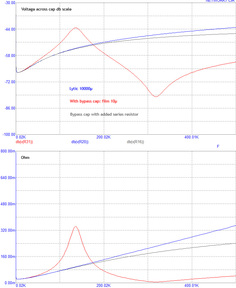

Bypass cap series resistors avoid dips and peaks im the impedance curve.
Things can be much improved by multiple different sized bypass caps,
and again with series resistors.
It can be seen that a single 10µ film cap worsens impedance up to 135 kHz before it gives an improvement at higher frequencies.
A single 1µ film cap worsens impedance up to 580 kHz, see earlier picture from analyzer.
Which values orders?
0,39 ohm for a 10µ MKP.
Evaluated with main cap 10000µ / 0,022 ohm ESR.
The picture below shows the impedance of 3 x 10.000 µF and the same 3 x 10.000 µF with 1µF MKV bypass.. . .

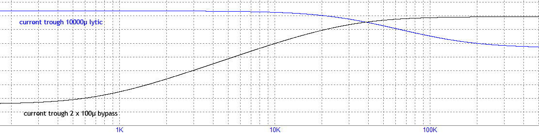

Woah! That response is drooping right after the ear's sensitivity peak. This is most annoying! Even a small error in the wrong direction will be very noticeable. The big caps need corrected so they can reach 22khz with a flat response.
Same for 10000µ + 100µ + 10µ but NO series resistors.
Blue is current through lytic, red 100µ bypass, green 10µ bypass.

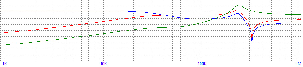

IMHO for a PSU we must consider:
1) Because the cap acts as high pass for the load, a lytic must be as large as possible to have lowest impedance at low frequencies.
Perhaps lots of smaller lytics paralleled could bring improvement by lowering ESR and could make the task of bypass caps easier by lowering series inductance.
2) Because the lytic cap's series inductance acts as low pass for the load, the amplifier can not work properly at high frequencies.
A compensation is needed.
HQ film caps have low series inductance and can jump in.
The value of the film cap must be large enough so that there is no gap between the lytic and the bypass.
If it is too large, there will be overlap.
So the bypass must have a specific value that depends on the C value and parasitics of the main cap.
3) Parallel connection of lytic + bypass causes dips and peaks in the impedance curve which must be dampened by series resistors added to the bypass.
There is no general solution like 2µ MPK and 100n silver mica sounds good as bypass...

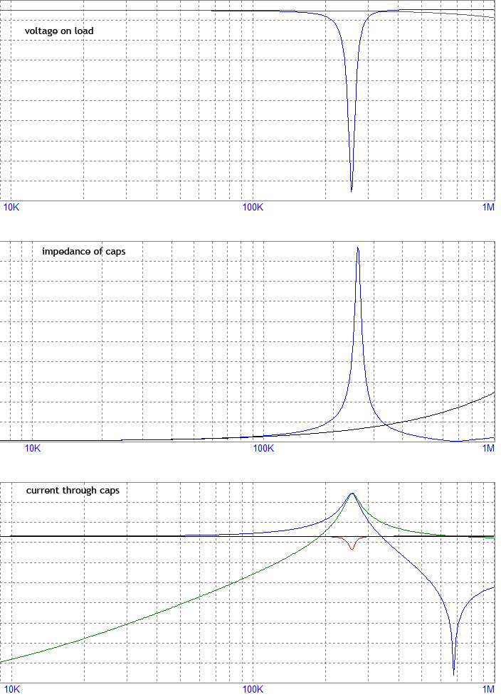

Here is what you find in a good amplifier: 22000µ + 2,2µ bypass and no series resistor.
First graph:
-6 dB dip on the load @ 250 kHz. The rest looks very good.
Without bypass there would be only -0,3 dB @ 1MHz, no cable inductances taken into account....
Second graph:
PSU impedance raises to 3,8 ohm @ 250 kHz.
0,22 ohm without bypass @ 250 kHz.
Third graph:
With bypass:
Blue is current trough main cap.
Green bypass.
Red load.
It looks like main cap and bypass cap are resonating.
By adding a series resistor to the bypass cap, that resonance is stopped.
Without bypass:
Black is current through load.
Because the impedance values of the caps are very low even at 1 MHz and the voltage loss depends on the load, the impact is very small in numbers.
But as most people believe there is an audible difference, it must matter.
Maybe a power amplifier like opamps and digital ICs needs perfect decoupling far above it's bandwith to provide stability and differences could be seen on squarewaves.
But it also could be that if the amp bandwith is 100 kHz and the dip / resonance is @ 250 kHz,
everything is already perfect and no need for series resistors.
