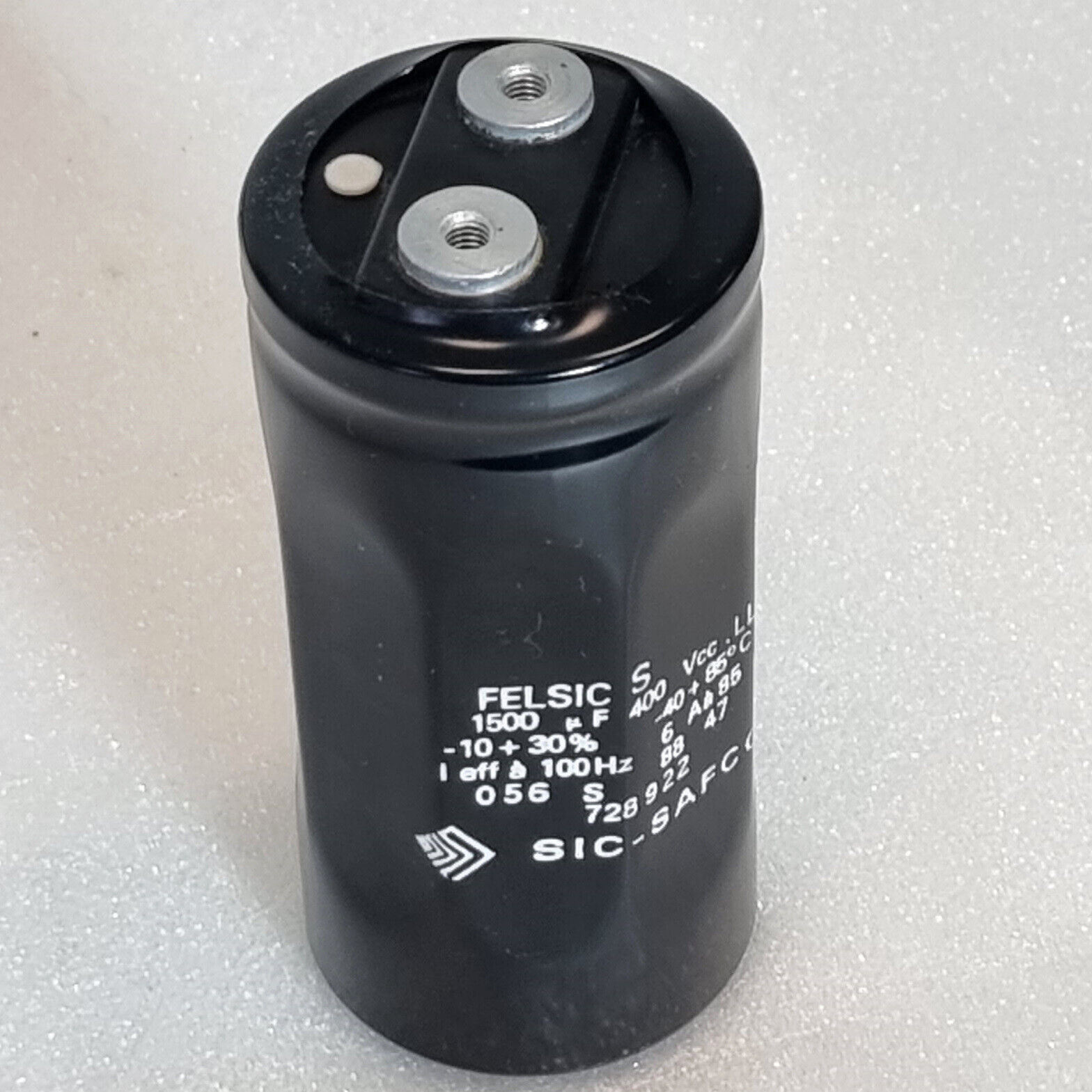

Question about elcaps whose cans are crimped with a super-sized crimp tool
My English vocabulary is not sufficient to correctly describe this process during production. Hence the photos in the attachment for comparison.
What is the reason for this additional work step being carried out (go to the first both attachment) ?
And what are the pros and cons of both versions (i. e. with and without this additional process) ?
P.S.: When comparing various electrolytic caps in amplifier power supplies, I often had the impression that designs like those shown in the first two photos always provided the better sonic performance.

For an audio application, I would look at the audio result and derive audio-relevant actions. One would have to listen to these capacitors before and after crimping.
I would avoid the thick alu sockets. My experience is that these large diameterss are harmful to the sound. You could cut them slightly, which would also improve the sound.
It is done for mechanical purposes. With these intentionally applied "dents" the casing is more sturdy/less prone to dents that may happen during transport. The used aluminium is thin and soft. In the round normal form a large dent in such a large sized capacitor is easily made and easily seen too. As they are used with a screwed clamp mounted on a chassis the clamp may hurt the cap. Less so with the dents. The last that is desired is a collapsing casing and a short circuit as result.
It was very long ago but of course destructive testing was done and at least once (Felsic/Sic Safco) I noticed the innards to be kept together by a layer of paper and the casings dents. Possibly they are therefor also less sensitive to vibrations. It is exclusively used on industrial series capacitors for heavy duty use in UPSes etc.
The impression that they sound better may have to do with listening with the eyes 🙂

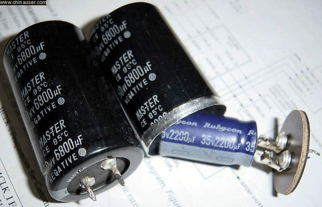

Hi Nico Ras,
Wow!
Massively bad idea. No ventilation, very substandard replacement capacitor.
People try this with multisection high voltage cans as well. Horrible idea done by people who lack an understanding of how this stuff works.
Wow!

IMO, re-stuffing should only be done for ascetic reasons and only then in carefully considered circumstances - there is no performance benefit involved. As @anatech said, not to be done in ignorance. The single most damaging effect is to "ovenize" the replacement capacitor and increase the buildup of any heat generated - and elevated temperature is the single most relevant factor in reducing a electrolytic capacitor's lifetime in normal operation. I will beg to differ in that re-stuffing those high voltage capacitors can (and frequently has) been done successfully but only by paying close attention to the power dispersion, clearance requirements, and by generally having an "understanding of how this stuff works."
Hi Hal,
Sure it can and does get done. But they don't last nearly as well.
Since CE Manufacturing makes new ones the same way, use those if you can. Especially since the "recap" jobs I see, they are charging tons doing it the wrong way, and you could get the proper part for the same or nearly the same money. Otherwise if you have the space, use tag strips and axial caps and do it neatly so it will last.
I'll call them "stuff jobs". I've seen some load the can with silicone. Makes things even worse, and try to service that mess. New small sized capacitors do not perform as well as the larger ones (that don't fit). So what does that tell you?
