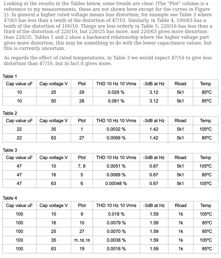

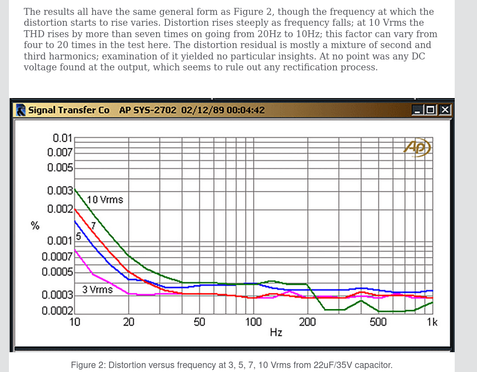

there is a new preliminary work by Douglas Self :
In conclusion, while the results are not as clear-cut as one might hope, there is a general result that if you are troubled by electrolytic capacitor distortion, you should use the highest voltage part you can. The results for the temperature rating are much less obvious, but nowadays I always use 105ºC parts for greater reliability (less drying out and reduction in value) over time. In the future I plan to test some non-polarized (NP) electrolytics; one might hope the results would be better.

Actually, the 105 ° capacitors sometimes perform worse than the 85 ° capacitors - measured in circuit and on their own. If the ambient temperature isn't high, they don't buy you one single thing. They use a different electrolyte, and it often does not perform as well. It is an excellent example of optimizing one characteristic at the expense of another. Yes, I listen and others do as well.
In my experience 105c capacitors sound worse than 85c. To my surprise nobody else seems to notice this. Good for praise in reviews, bad for sound quality. They sound a bit closed in with a loss of timbre, I call it the new modern sound :(.
They often show this in measured characteristics.

Look at the tahn value Rick. Not catalogue, measured at 1 KHz.
