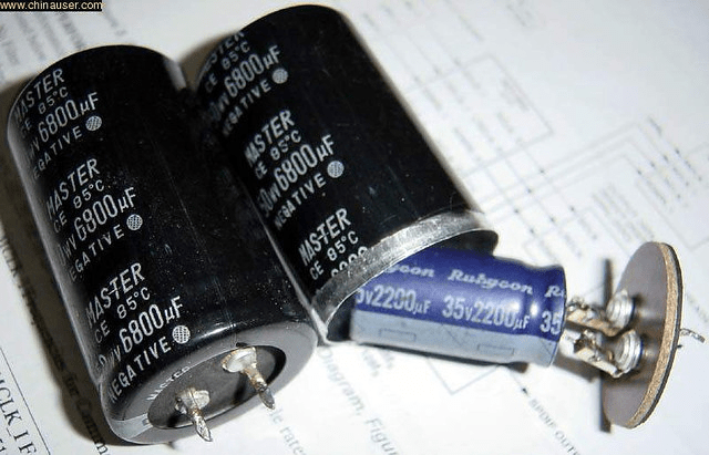

True... as long as there is a significant temperature rise. Use a 105C cap and a few degrees won't have any appreciable effect on the lifespan. The key to that is, of course, "few degrees" and why I stated that a knowledge of the power dispersion was critical in making a decision on whether to stuff or not. It may be different in audio circuitry but in TE the high voltage cans tend to be used in very low current rails, on the order of a few tens of milliamps and there are just not any thermal effects generated to begin with - the can size was determined by the voltage, not thermal, requirements. On a related note: you hit the nail on the head when speaking of smaller form factor capacitors. Just because modern capacitors can be much smaller than those prior does not mean that they are interchangeable (I know, preaching to the choir in regards to you but for others it needs to be said.) In a high power application, replacing that 10,000uF screw terminal can capacitor with a 10,000uF radial that is a 5th of the size is just not something that is going to last very long. Of course, going in the other direction and replacing a nice little, perfectly functional, 47uF electrolytic coupling capacitor with a film the size of a medicine bottle (with 10cm of leads free-assing off each end) is kind of dumb as well.

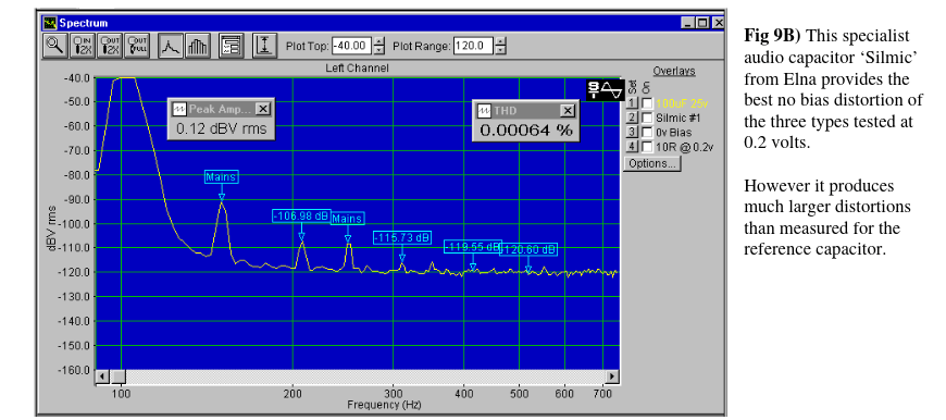

Screenshot 2024-08-16 at 17-02-27 Microsoft Word - CAPSOUN6.DOC - Bateman EW 01 2003 mar2003 1...png
Hi nicoch58,
However, test conditions make these only valid for the same operational conditions. You can't "read across" and apply the same results to all situations. Jets have crashed due to "read across".
Distortion does matter. Does the application activate the distortion process? For coupling caps in their pass range, no. It doesn't. Unless a capacitor is defective or really bad quality, and it is sized properly, coupling capacitors DO NOT CHANGE THE SOUND. Period. However it is easy to convince folks who don't understand how things work that a certain brand and model part is better. That's a type of lie. Sadly, it is easy for our brains to convince us we hear things that are not there too. Suggestion leads to expectation bias. There you have the high end component industry in a nutshell.
In order for the capacitor to change anything, you must develop signal voltage across it. That is why coupling caps do not change sound, you never develop a signal voltage across them. This should be easy to understand.
Always remember that test situations are normally designed to show the behavior you're looking at. If the normal application doesn't put the component in this situation, the tests are invalid for that use.
