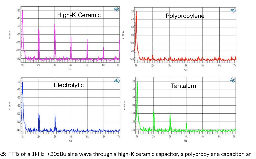

Well, if you understand circuit design and components you'll understand that no one component in the coupling position will ever be transformational. In circuit locations where components do make a difference is it the type, not the brand that matters. Matching of some parts will also greatly improve performance and sound quality.
Unfortunately, what matters does require knowledge, skill and instrumentation in order to get the matches. It also requires time, and time is money. You can't whack through a bunch of stuff doing it right. Someone has to know what they are doing and invests the time.
Anyway, the magic part simply does not, and will not exist. Improving sound quality requires a system view and actual engineering concepts.

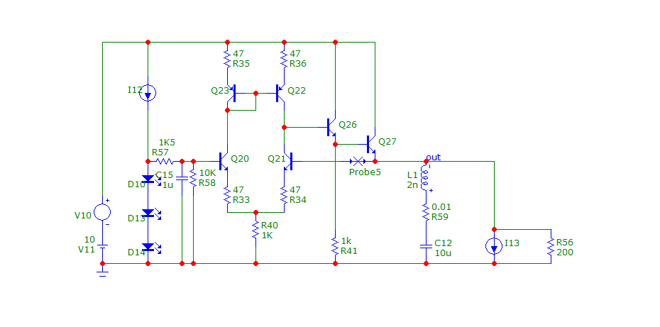

I have two stupid questions, do tantalum caps dry and age like regular electrolytics?
If not, why aren't they used more in diy, where voltage regulators usually require a fair amount of capacitance at the output (for stability)?
I was trying to get rid of the electrolytics in some of the projects I have been working on, but the regulators seem to need 100uF to 200uF in order to have good phase margin (on the simulator).

Tantalum capacitors don't dry out. They do suddenly short. I'm sure there is a wearout mechanism for them.
Why don't we use them more? They are expensive, you have to underrate their voltage rating specs - a lot! They do not handle reversed polarity at all, and spikes can sometimes kill them, over-voltage does for sure. That and they have horrible dissipation specs and terrible performance for audio. Try a Poly-Aluminum for improved HF characteristics.
Positives for tantalum caps are low leakage, stable capacitance and small size.

Yes, good high frequency characteristics, but for RF you want to use a ceramic capacitor. You could use mica, but those are very expensive.
Ceramic capacitors are good if one is not using a RC filter (as in supplies for digital logic). Audio requires not injecting current into the ground plane. That necessitates a RC filter where the capacitor has low reactance from audio through RF. Tantalum is the only capacitor that can do that.

Where do you think any type of capacitor will couple noise current to??? Capacitor type is immaterial if that capacitor is effective.
So let me tell you where. Noise current will be returned to either a "dirty ground" return, separate from the signal common, or to the other supply rail (negative for positive noise currents). Where your noise current goes to is a matter of circuit and PCB design, not capacitor type.
An R-C filter can be an effective attenuator for higher frequencies and has nothing to do with where the noise current ends up. More effective is an L-C filter and it depends on the frequencies you are trying to attenuate.
