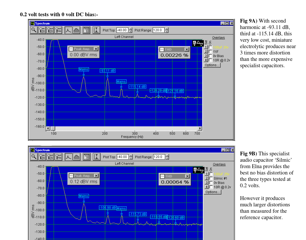

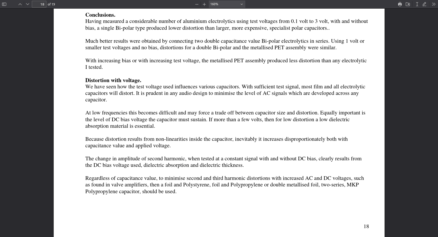

The Bateman paper you quoted talks about "very low cost, miniature electrolytic". I'm talking about MKP, which is Metallized Polypropylene.
