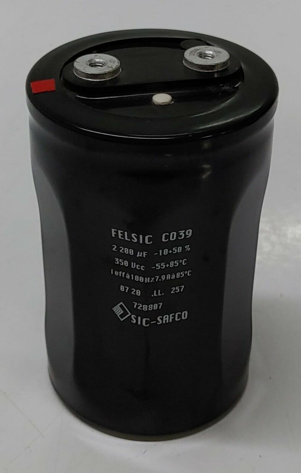

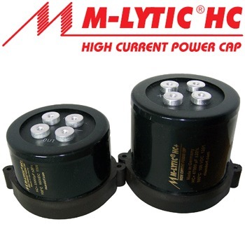

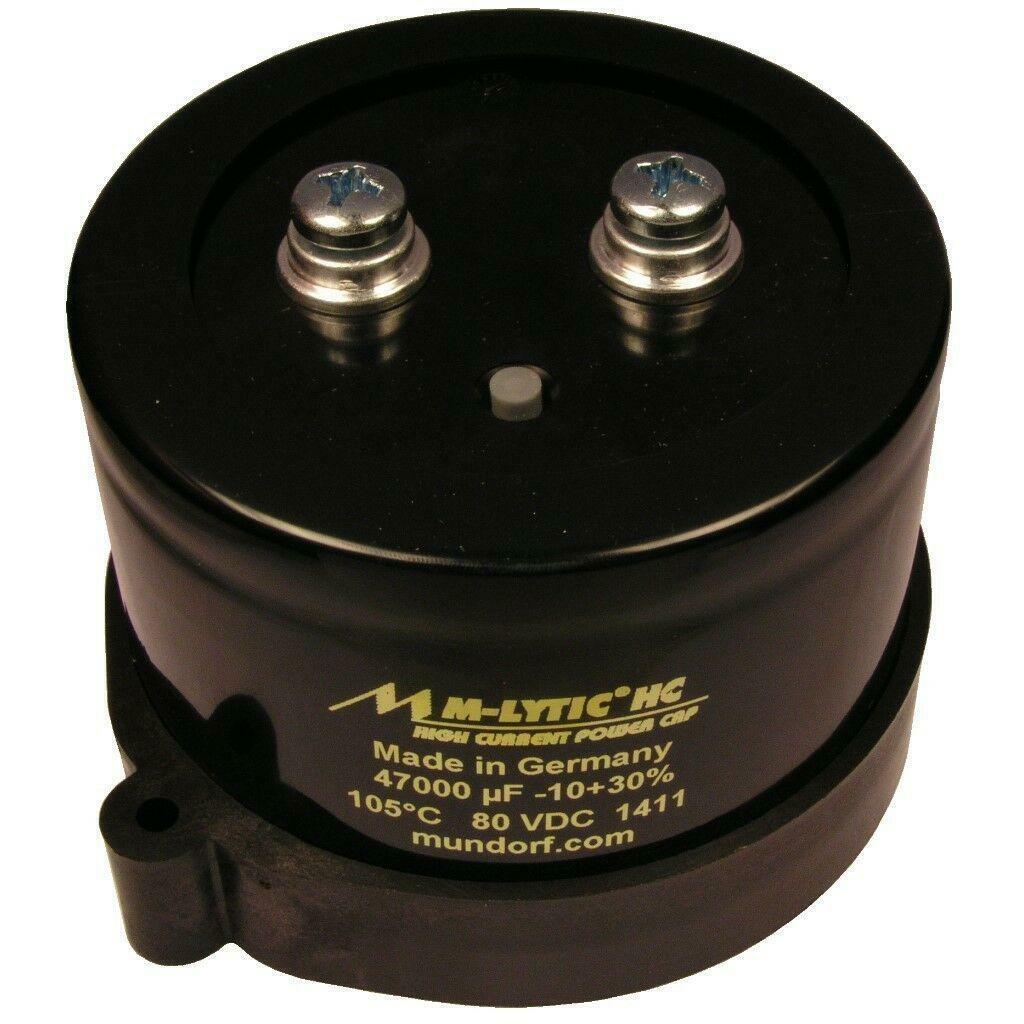

In general - best capacitors for power supplies in power amplifiers always between 63V and 100V versions. Best brands from my views are this:
1) ft-cap GW series
https://www.ftcap.de/fileadmin/user...xen/Gewindeanschluss/GW_series_16.11.2016.pdf
2) Mundorf M-Lytic
https://www.hificollective.co.uk/components/mundorf_mlytic_hcplus.html
3) SicSafco FELSIC I-PLUS
https://exxelia.com/en/product/detail/73/felsic-105-lp
https://exxelia.com/en/product/detail/78/felsic-i-plus
Unfortunately, for reasons of space, it cannot be used as a replacement part.
I. e. only for use in large outdoor power supplies that are manufactured afterwards but blown away regarded sonic performance (in all respects) any elcap with solder pin and most elcap with screw terminals from other companies like e.g. BC, Nippon, Rubicon, ELNA, RIFA Kendeil.
The old brand S+M - also excellent sonic results - unfortunately don't exist anymore
Including the transformer and filter choke, power supply can quickly cost 4-5 times as much as the power amplifier that is later connected to it - but it's definitely worth it.
Everyone who has done this and made no mistakes in wiring has confirmed the drastic increase in sound quality.
A SMPS (SPS) with same performance I haven't discover until now.
