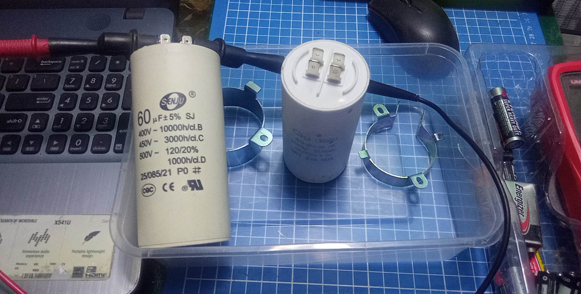

cbb60, metalized polypropylene caps of 100ufd/450vac, more than enough for a tube amp...

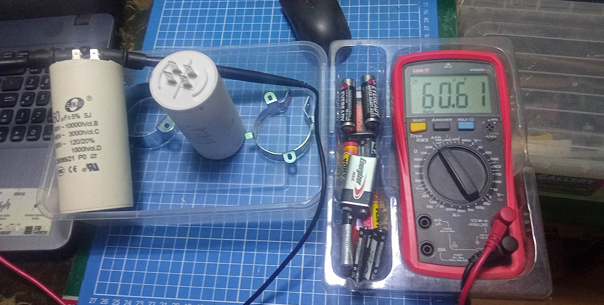

today, cbb60, polypropylene, 60ufd/450vac caps are available and cheap...100ufd values are also now available for about U$12....
using them in a tube amp say the ST70 is plenty of storage...i have seen a youtube video using no electrolytic caps, only polypropylenes...
