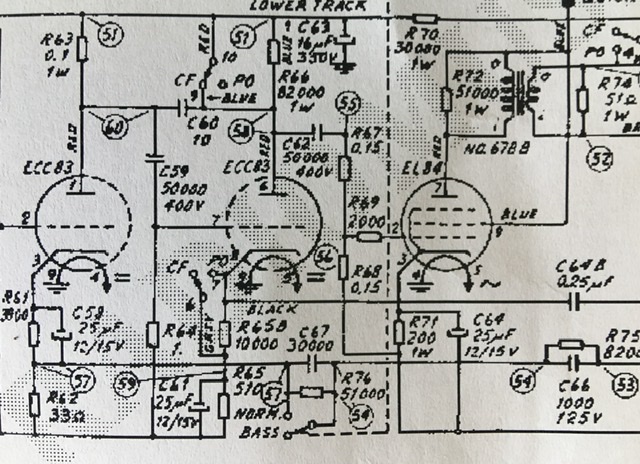

Another example is that used in the Tandberg 74B reel-to-reel, also TB5.
I’d guess this one has way too much gain in front, no need for 2 12AX7 stages.

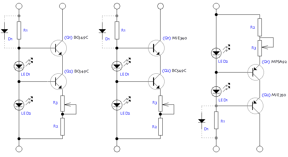

CCS:
dave

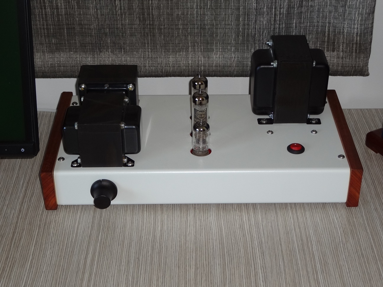

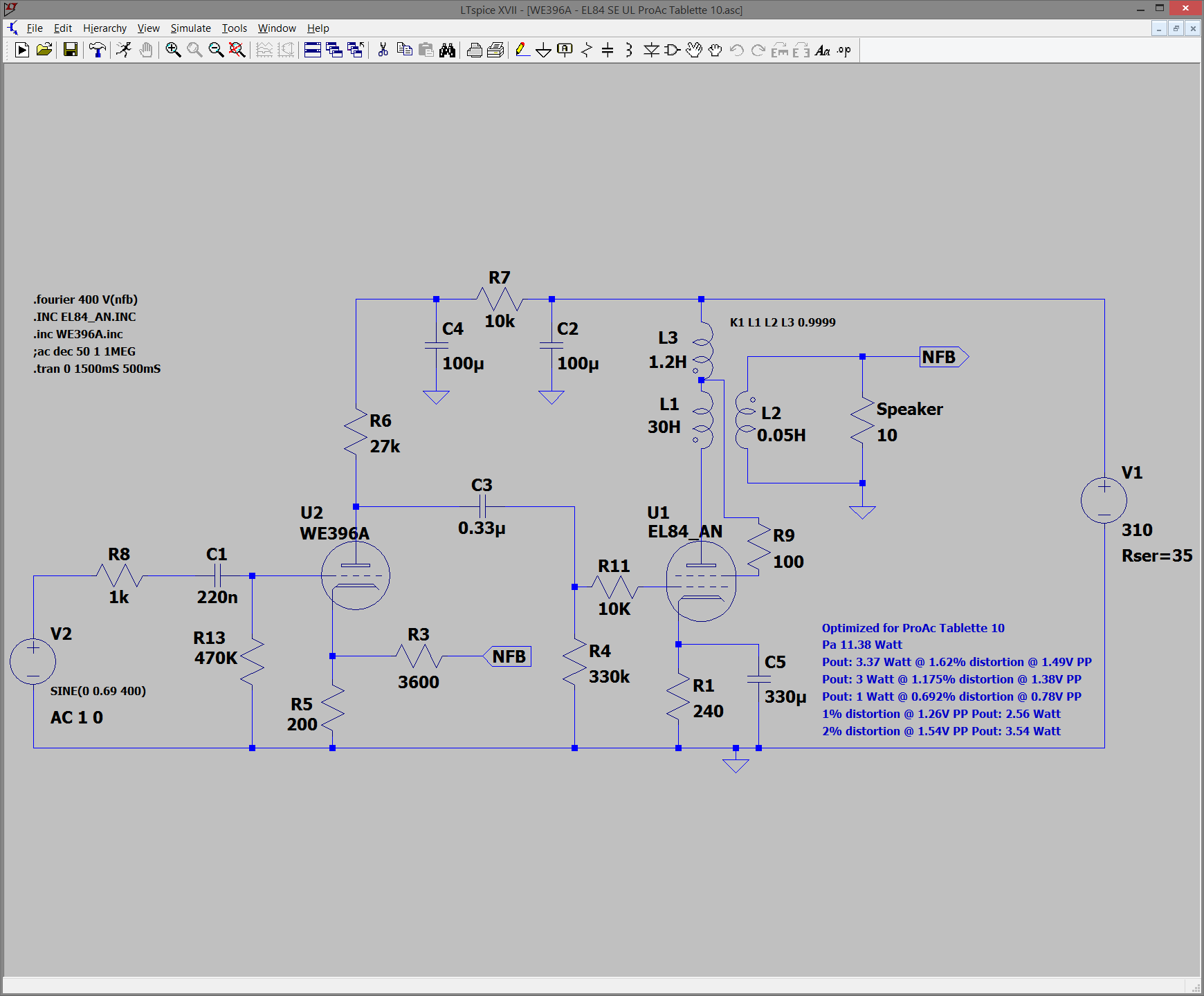

From DIYtube the Budgie that I built nearly 7 years ago. At the moment working on a replacement optimized for the ProAc Tablette 10 (sealed enclosure, 10 Ohm impedance).
I've used the Ayumi model for the 6BQ5. A model for the 2C51 shows hardly any difference with the WE396A. Rk can be increased to 260 Ohm but then the 8 Ohm performance deteriorates.
For tube alternatives I'll be using: WE386A / 2C51 / 5670 / 6N3P-E / 6N3P-EV and the EL84 / 6P14P-EV / 6P14P-ER.
Transformers are Transcendar TT-234-OT with 22.5% tap for UL.
Picture is of the Budgie
AmadeusMozart,
Nice looking amp!
And a good straightforward schematic.
I like it.
But I am curious about your wattage ratings.
You show the highest output as being 1.54V pp (peak to peak?)
(V peak to peak) / 2.828 = Vrms
1.54/2.828 = 0.545Vrms. Too low to be powerful into 10 Ohms.
Instead, did you perhaps mean 15.4V peak to peak?
15.4Vpp/2.828 = 5.45Vrms
(Vrms)squared / Ohms = Watts rms
(5.45Vrms)squared / 10 Ohms = about 2.97 Watts to 3 places
That seems more like it.

Also, move R8, and put it directly on the 396 grid and the other side of R13; that way R8 becomes a true grid stopper. And the rest of the circuit will perform 99.9% exactly as before (in all practicality exactly as before moving R8). WE396A are RF capable tubes, grid stoppers are good for audio.

Those were the input voltages.
You are correct on a grid stopper on the 396A, I just copied another schematic and I modified it, did not pay too much attention to the input.
Although I have made a mistake in modelling the UL output transformer according to post 17 in this thread: Modeling Pull-Push transformer in LTspice
Values for the OPT are: L1 = 1.2H, L2 = 19.2H, L3 = 0.048H. Remainder stays the same. Depending on whose model for the 6BQ5 you use you'll get something like 3.2Watt to 4.1Watt. Suspect this is due to the different manufacturers have slightly different tube characteristics. Optimum output seems to be around the 10 - 11 Ohm speakers due to using a 5000 : 8 Ohm OPT and in UL you'll want a tad higher imedance than 5000.
It will allow me to use the Tablette but there are also many speakers that are around the 6 Ohm which I can happily connect to the 4 Ohm tap.
I was taught that if a transformer is bobbin wound then use a small capacitor of 5nF in series with a 22K 1W resistor over the primary of the OPT to stop the ringing. Unfortunately there are not many that still wind output transformers properly and if they do then they are expensive. I bought some Hashimoto and they were not bifilar woud, was quite disappointed with those. VVT in the UK still makes decent ones as far as I am aware but costly. Valve Audio Amplifier Output Transformers for Push Pull circuits
When hard wiring you might sometimes encounter some instability around the EL84 and grid stoppers together with a small capacitor of 50 - 100pF from g1 to ground will stop that.
