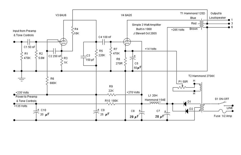

I built this one in 1968. It runs every day in the shop. All inside a Hammond 8x12x3 chassis. If I built it today I'd use one of the more recent Hammond SE OPTs.🙂
