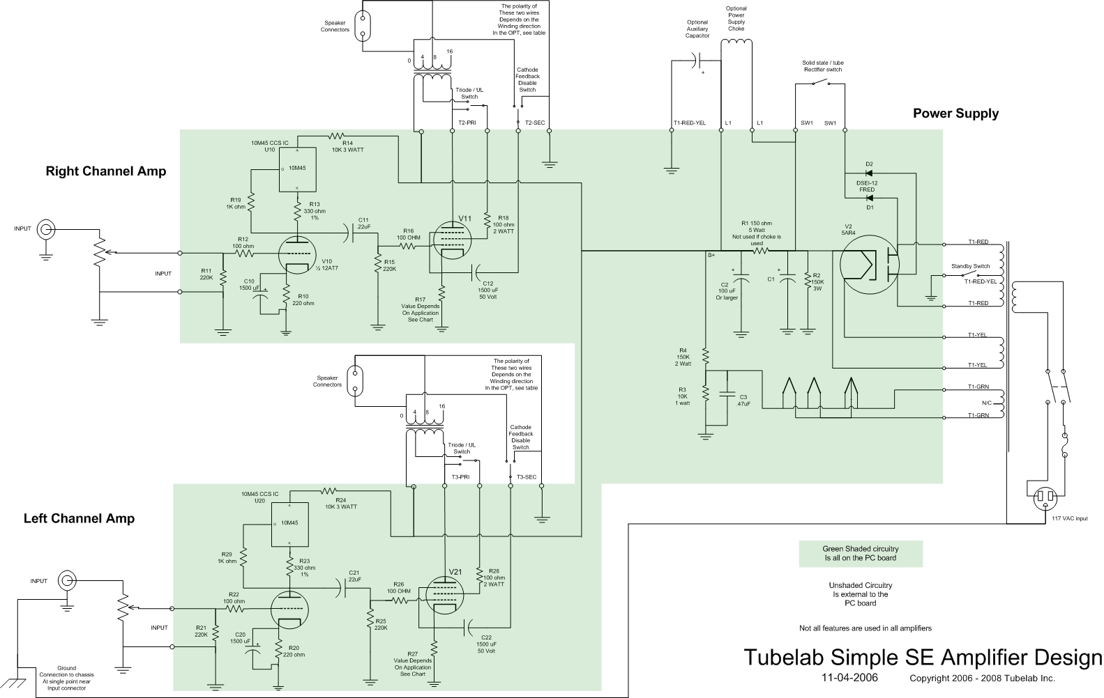

Best EL84 SE amplifier?
Two other ideas for a SE EL84 design...
Tubelab SSE (Simple Single-Ended)
The PCB is for octal output tubes but the circuit can be modified to use EL84/6BQ5.
Tubelab SSE | Tubelab

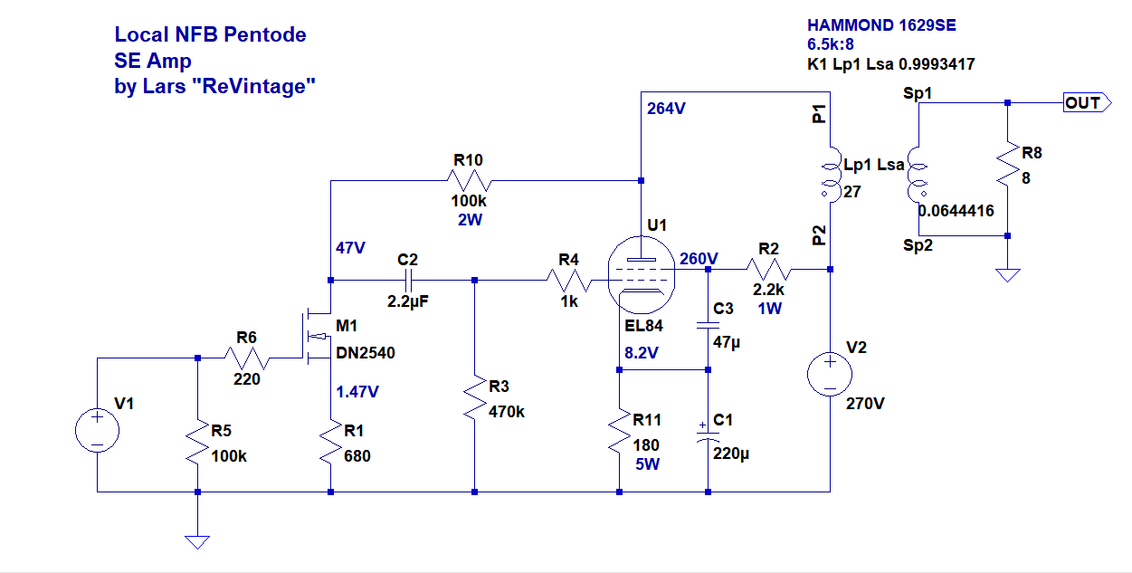

Attached is a design after suggestions by members Michael J Koster and ReVintage, from the 'Schadeode' threads back a while ago. It's a hybrid with a depletion mode MOSFET as the input voltage amp/driver stage. Plate-grid (local) negative feedback around the EL84. It should make about 5W out.

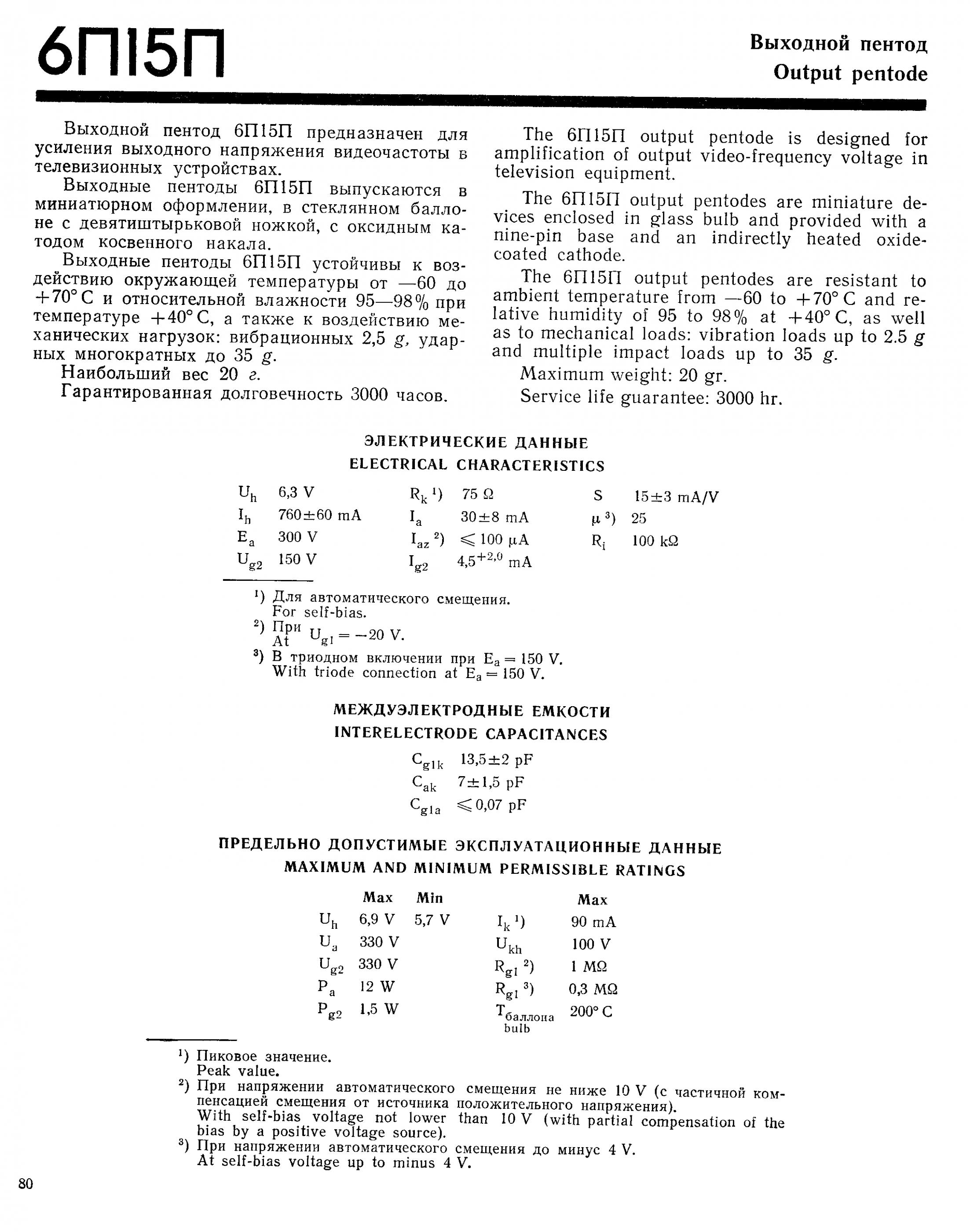

Wavebourn really likes the 6P15P. It's similar to 6P14P/EL84 but has a higher gm g2, which means it can't take as high g2 voltage. EL84 would be the better choice for UL use.
It's really not a better/worse thing. They're two (slightly) different tubes.
The higher gm g2 of the 6P15P might make it a better choice for pentode use with a regulated g2 supply at something like 200V. Perhaps...
This is the concept. I deliberately left components valueless due to the flexibility of operating modes.
Another cool feature, it needs little negative voltage bias and you can get away with a 100-120R small cathode resistor instead of using fixed bias. The cathode feedback coil Rdc also contributes to some cathode bias.
At some point near peak power, g2 starts drawing peaks of current. If the g2 supply voltage impedance is somewhat high, the inability to supply current to g2 will be the bottleneck to squeeze the last watts.
At optimal pentode loadline, calculated simply by Zopt=Ua/Ia * 0.9, LTspice shows a power output efficiency with the transformers Rdc included at 46% at clipping onset. Which translates to 4.5W at 9.45W plate dissipation.
At my first experiment with PL82, I had the loadline calculated wrong due to failure to include the cathode winding impedance into the loadline impedance. With trial and error adjustments, I reached an efficiency of 43% there.
Output is 9.4V peak (6.66Vrms) over 10R load resistor. Zeners adjusted at 230Vdc across g2. Tube operating mode - Ua = 270V, Ia = 35mA

I shall appreciate hearing more about your experience with using the 6P15P tube upon which you base your preference for 6∏14C. I mentioned the 6P15P because it seemed worth the consideration of the OP, who stated (post #1) that he will use pentode connection and a regulated screen supply.
The SV83 tube data you reposted was authored by Svetlana USA. This version of data is different from the attached “real” Russian tube data for 6P15P, which gives maxima for both Ua and Ug2 as 330V (screen dissipation is 1.5 W max). EL84 data sheets typically give 300V, 300V max and 2 watts respectively.
It would be good to find out what the real capabilities of the real 6P15P tubes are. But that may be a topic for another thread.

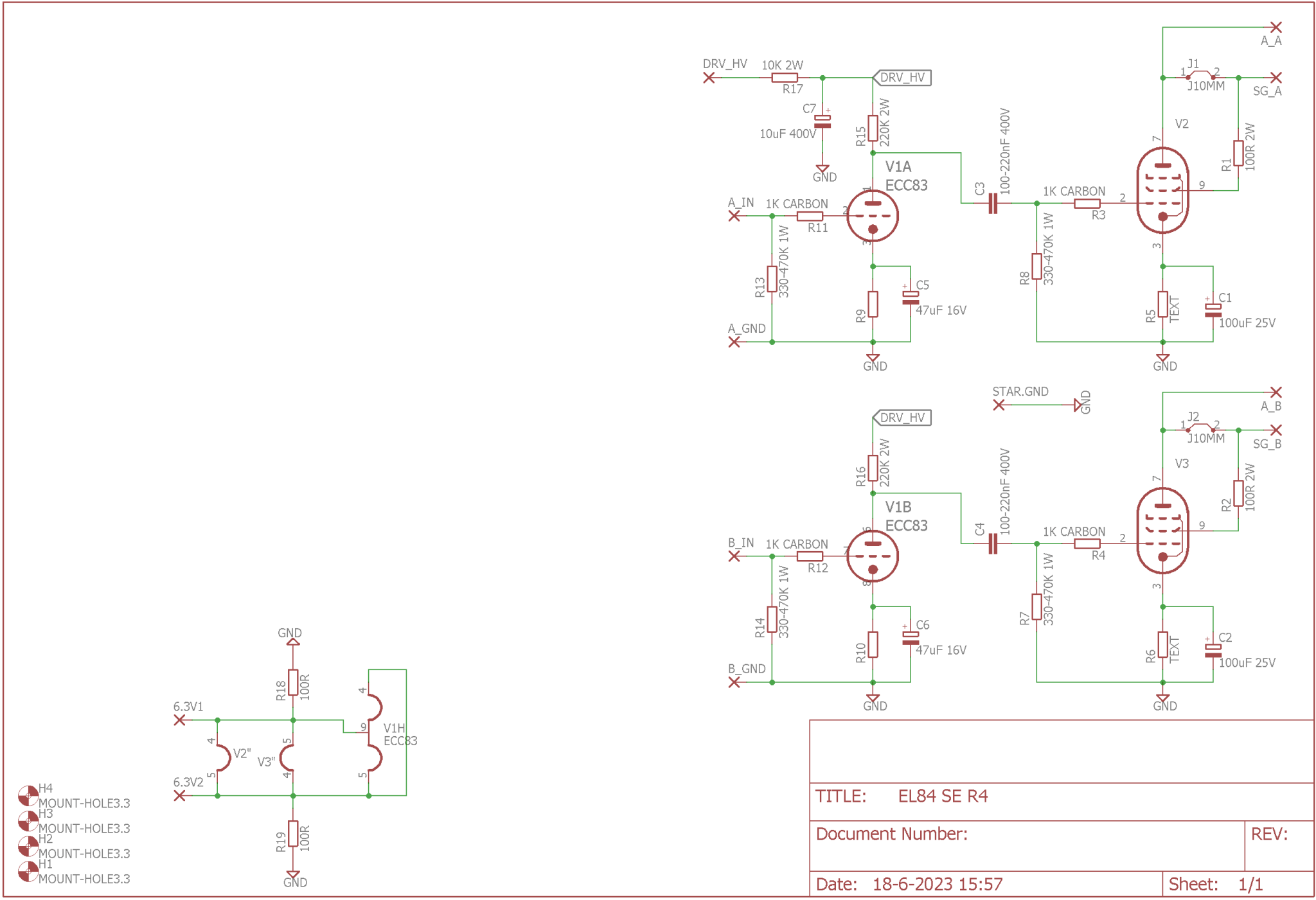

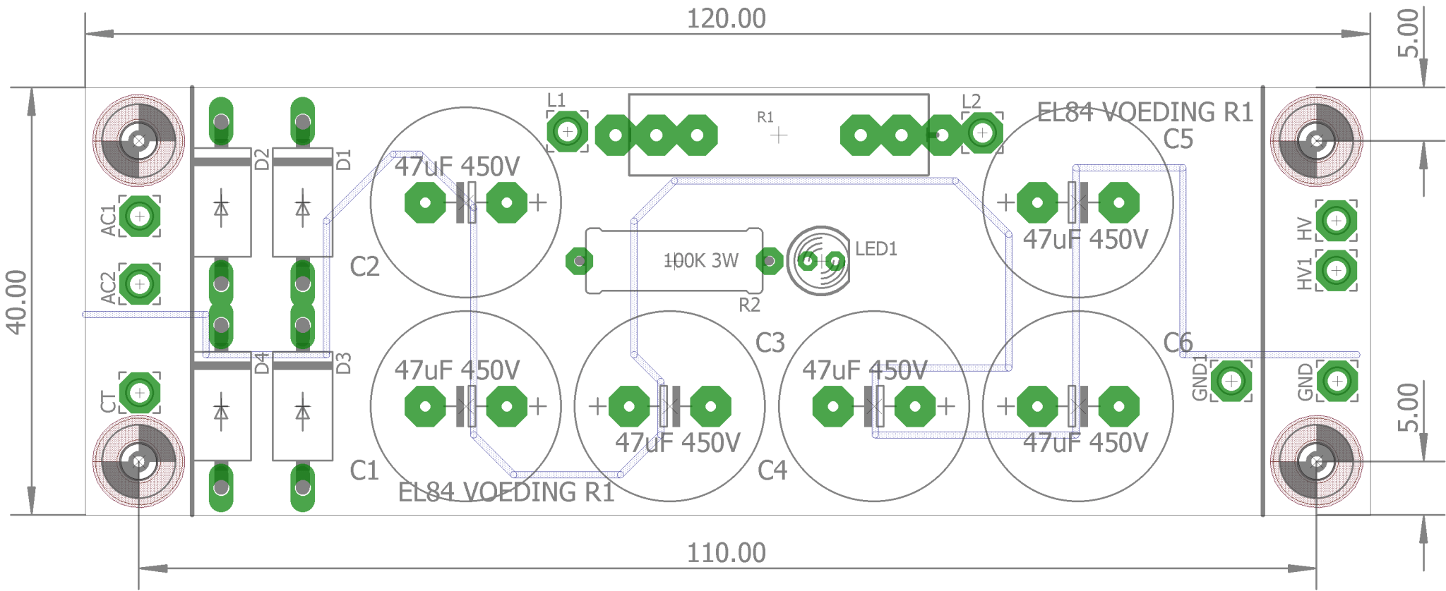

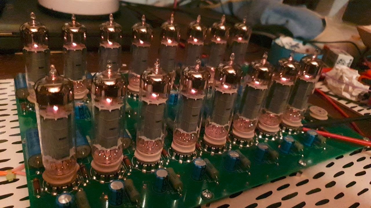

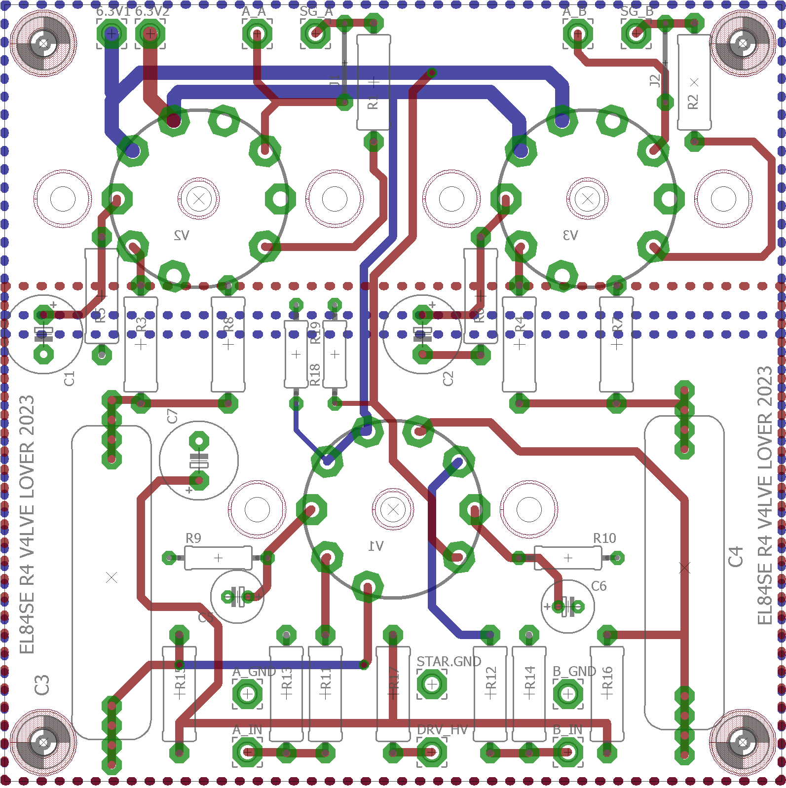

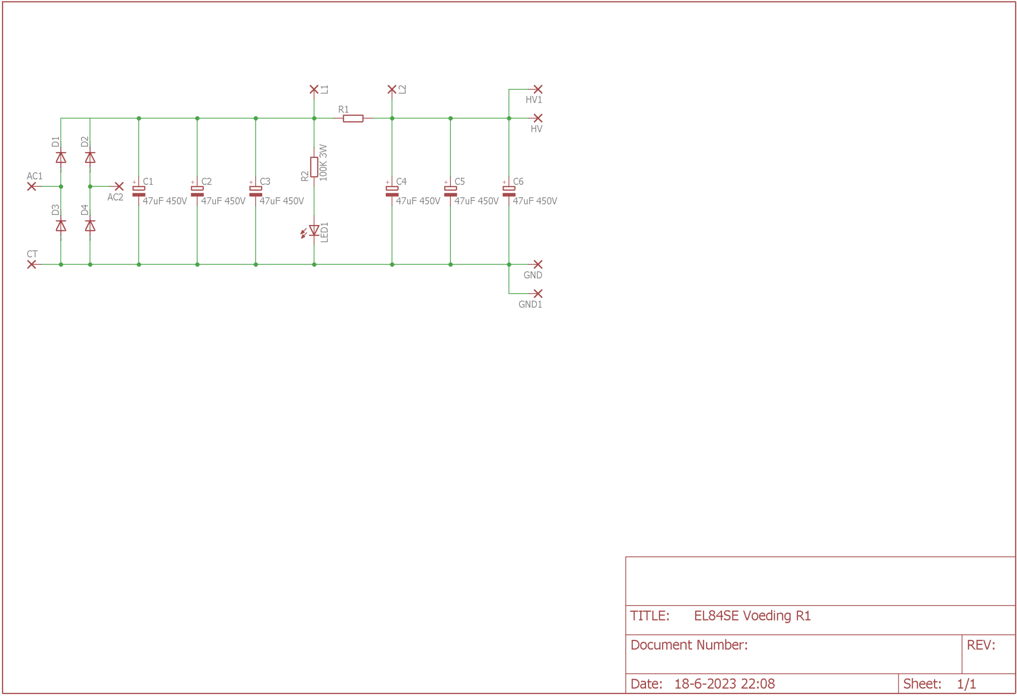

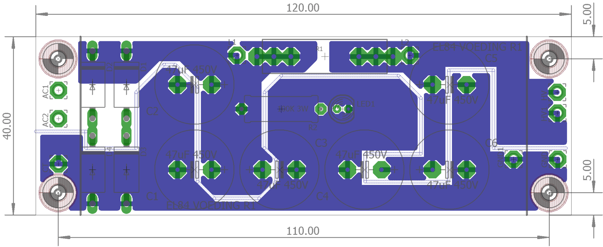

I have just Finished Revision 4 of the EL84SE and EL84 PCB's. And also made a new PSU board for it. New revisio uses VT9-PT Belton PCB sockets, much better than the Chinese ceramics from before.
Attached the images of the boards. Amplifier PCB is 100x100mm.
I have ordered some of these boards for selling to diya members.
V4LVE

This was too tempting, so I ordered one. Should be here any day. Have you had any reliability issues? I got the schematic from the vendor, and it shows that the screen grid is at 270v while the plate is at 260v. I don't know too much about this, but I thought that would lead to premature tube death.
