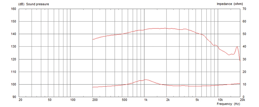

Let me rephrase my original comment - ignoring the plot: "As is well known, Arai horns usually exhibit a relatively flat on-axis response".
Here is an example of the 18Sound ND2060A + Arai 290, without active correction or filter:
Nothing new, nor a matter of life and death, so sit back and relax 🙂

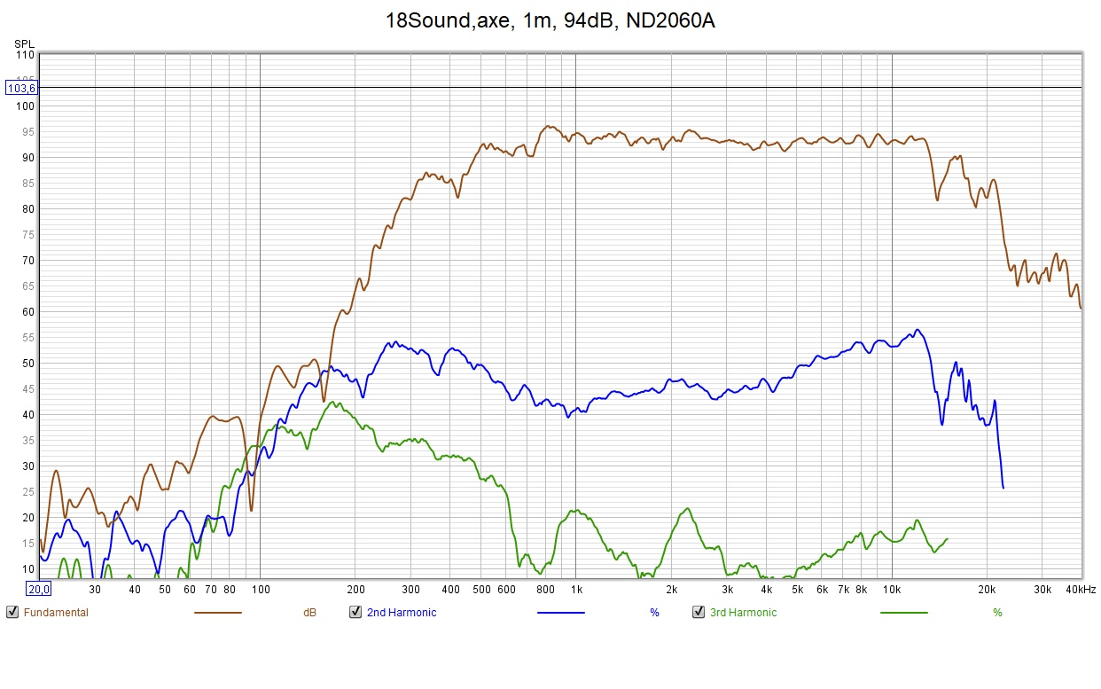

That driver (and the 1460A) is spectacular except for that last half-octave. It’s the driver I recommended to PaulW over a decade ago.
un-smoothed:
https://www.htguide.com/forum/forum...34994-the-raptor-a-10-mtm?p=631116#post631116
un-smoothed:

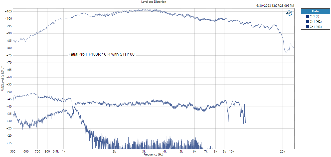

Hello All,
Added just for fun!
Thanks DT
Driver := fatialpro HF108R
Horn/Waveguide := fatialpro STH100
No smoothing
Added just for fun!
Thanks DT
No smoothing
Celestion does, for most of their drivers.I wish they'd just provide the PWT response, independent of any horn.
Beware, the STH100 is a Tractrix horn, so can't be good (according to some) 😉
Hello All,
Think of a Tractrix as a controlled directivity waveguide not too different than a oblate spheroid waveguide.
Crossover above the peak on the impedance plot and put a blindfold over the eyes of the critics, they will never know.

Confusing choice of words as octaves are discrete like that. 108.24hz to 216.48hz is an octave. That degree of distortion in the upper treble region which is much less audible than the rest of the frequency range and thus is not as substantial as the graph implies, is characteristic of all metal diaphragm compression drivers with the exception of a couple beryllium dome drivers. Synthetic diaphragm drivers often have this issue to a lesser degree though they also lack the magic the metal diaphragm drivers which results in cymbals for example sounding very real and shimmery harmonic overtones. A lower mass adequately stiff diaphragm operating within its intended power handling range will be more extended thus pushing the moment of diaphragm breakup closer to the inaudibly high frequency point hence the use of beryllium.That driver (and the 1460A) is spectacular except for that last half-octave. It’s the driver I recommended to PaulW over a decade ago.
un-smoothed:
