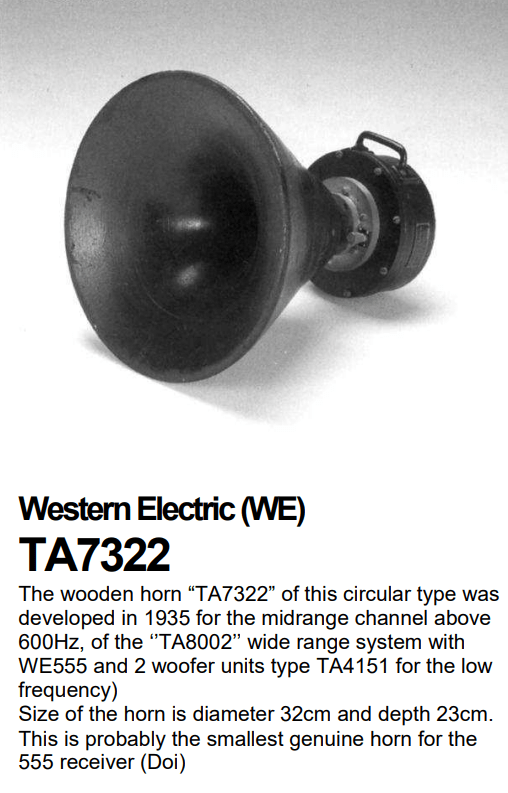

i disagree too Tratrix is the way to do if you want to go very low and not have a 1meter diameter horn as with the JMLC profile , Goto Horns goes very low and don't have a trumpet effect if you cross them well . i always prefer round horn tratrix or exponential like JABO or anvantgarde horns. I have a pair of ARAI 480 at home and prefer it as deco than to use them in a speaker..

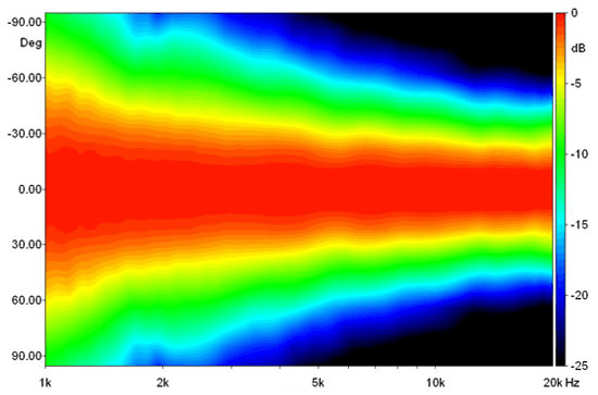

Directivity isn't up with the best, but can be decent when the horn is short

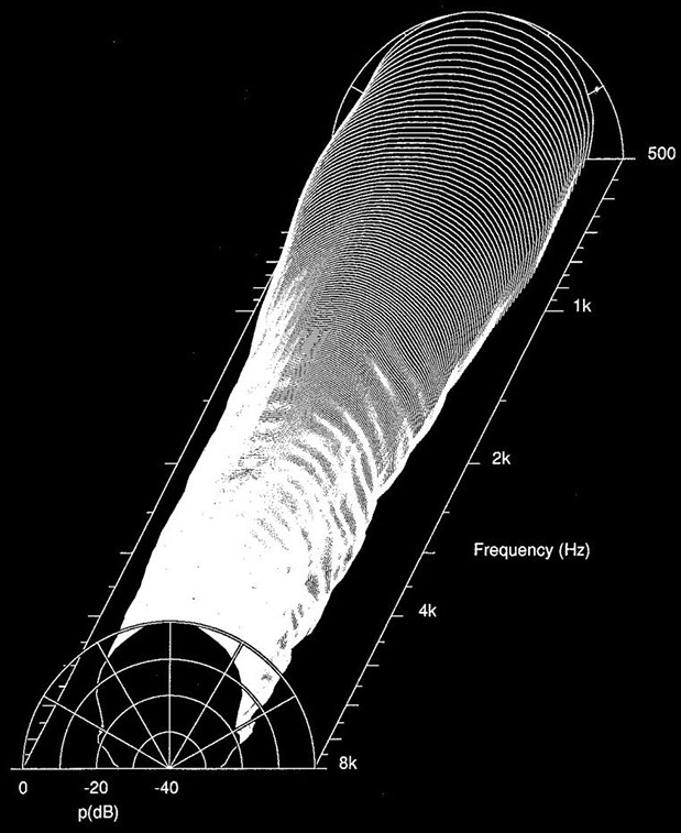

Regarding trumpet effect: I've noticed it, especially with longer axisymmetrical horns. Of course it depends on the implementation (passband a.o.), listening distance etc. Have you listened to older Avantgarde Trios and the latest version?
Radial horns, as you use yourself, are of course devoid of this effect (the horn physically differs from a trumpet resulting in a different perception), but radial horns usually exhibit pattern flip and unfortunately I am also sensitive to that phenomenon > shift in image when walking across the room.
Overall, I agree with Newell and Holland's findings, which remains the most thoroughly conducted study of its kind.

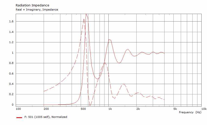

This is not correct. The loading of a native Tractrix profile is acceptable good but as the profile does not expand fast enough in the mouth region and because of the fact that the mouth area is quite small one get huge resonances for the radiation impedance around the cut-off (here 425 Tractrix horn):I disagree.
Tractrix loading is poor.
This is why I introduced my true expansion tractrix horn.

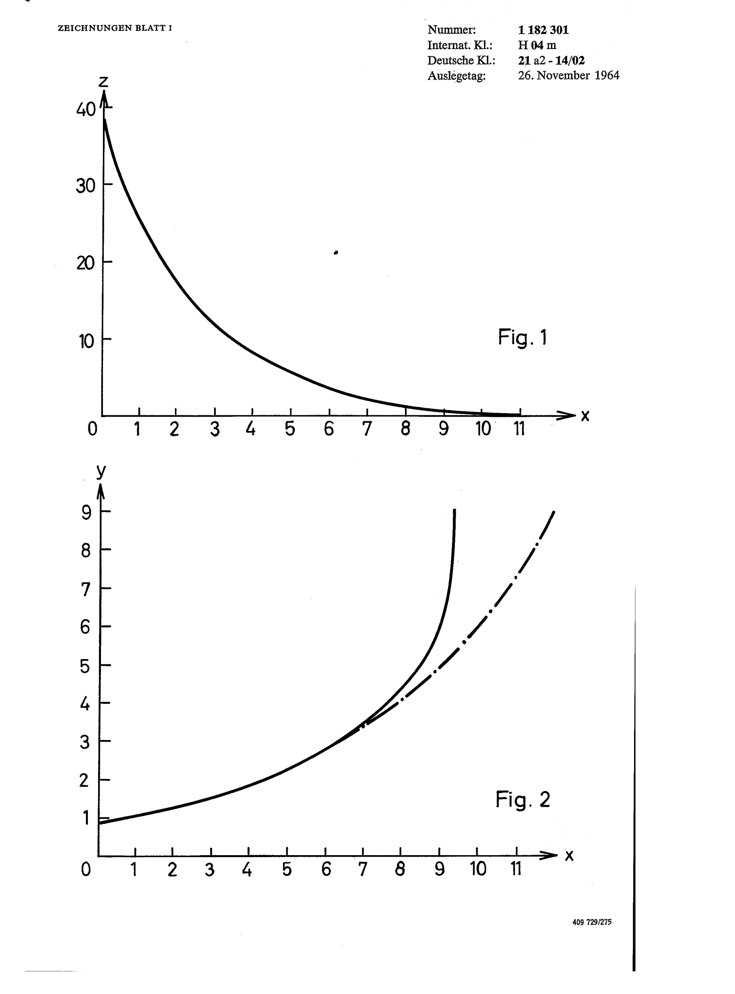

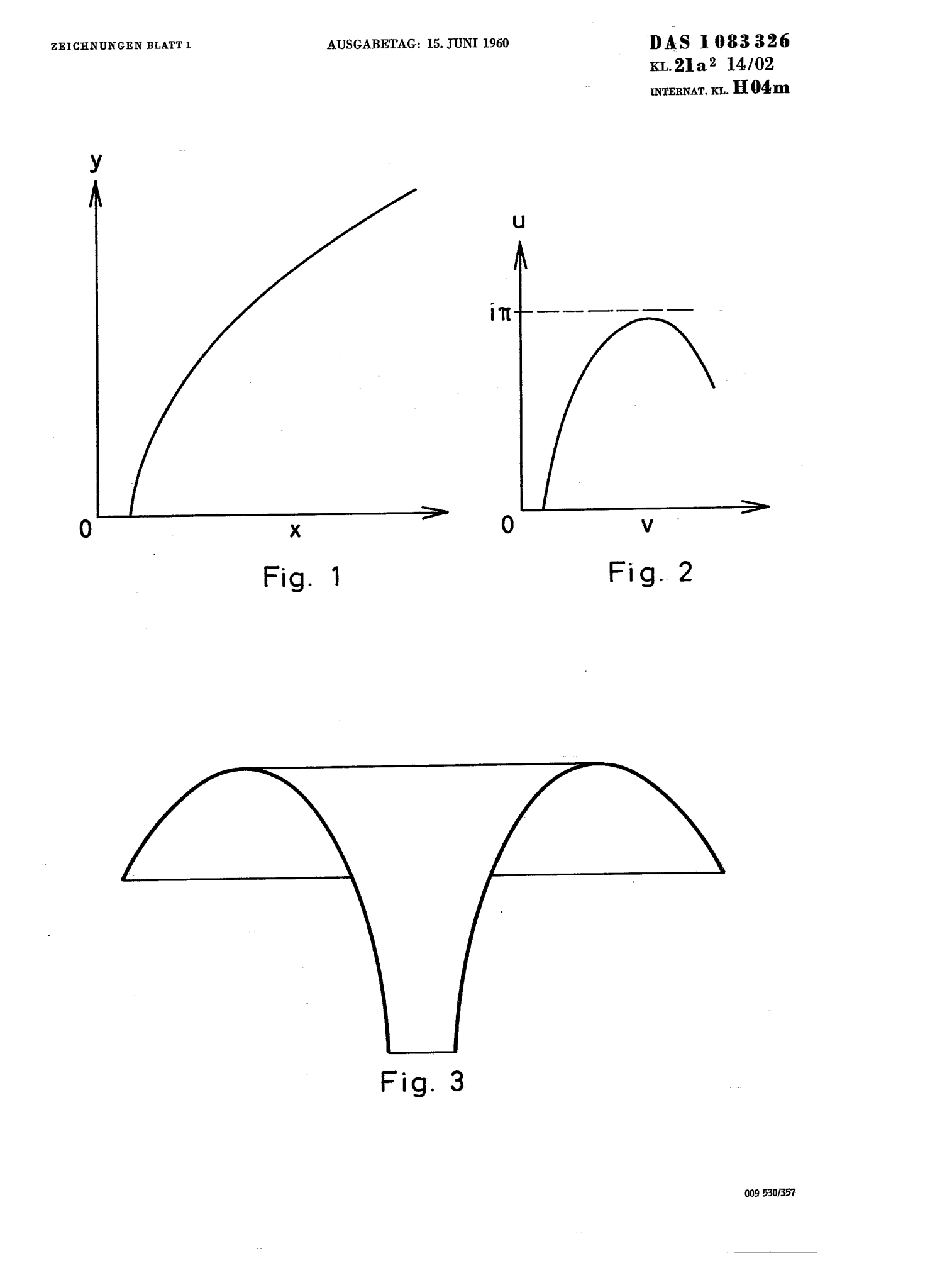

Personally I'm in favor of shortening existing horn profiles as Manfred Harsdorff did at Siemens Klangfilm and Docali has implemented in his spreadsheets.
Just to mention, I don't like Tractrix horns ;-) The true expansion Tractrix horn was simply a theoretical study object. Maybe if someone is interested I could provide the one dimensional coordinates for a round horn. But directivity control will be indeed poor.

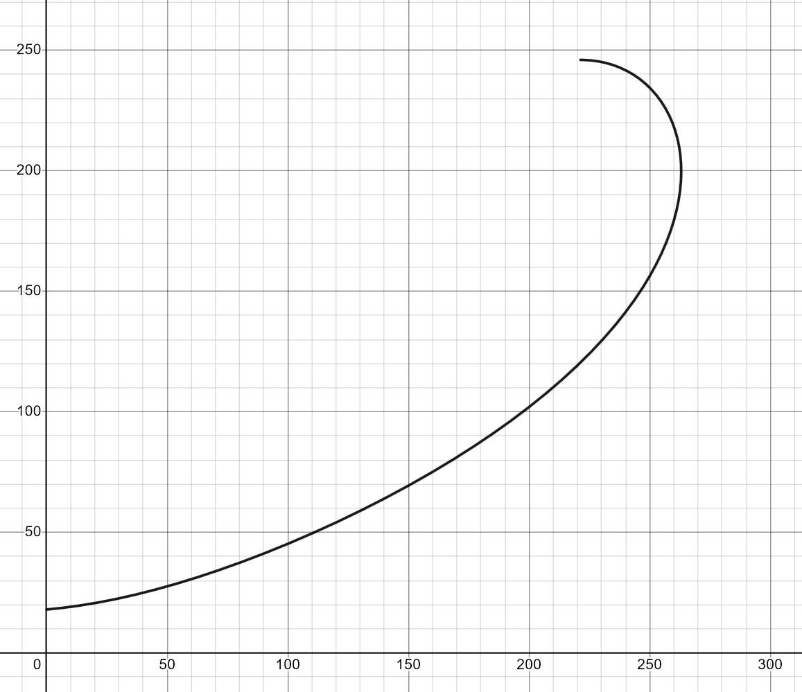

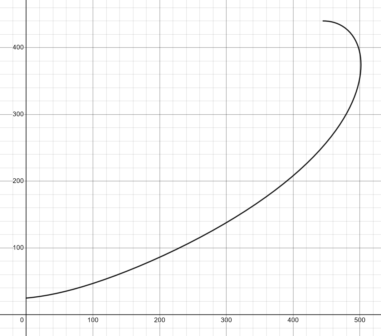

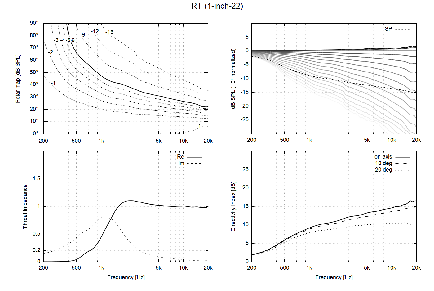

Just a random shape, took me 5 minutes including the BEM analysis 🙂
https://www.desmos.com/calculator/sug3snaxgg
View attachment 1186507 View attachment 1186508
Should work from about 500 Hz in a hifi setting.
Roundover aside, the profile probably isn't much different from Newell and Holland's AX2 horn.
As well as this one:
Sure, as almost any horn (or waveguide) with a 1.4" throat.Should work from about 500 Hz in a hifi setting.
But it can't be "roundover aside". That's an integral part of making a good horn, free of any "trumpet effects". No matter how long it is.Roundover aside, the profile probably isn't much different from Newell and Holland's AX2 horn.

Ideally, the roundover/mouth termination is an integral part of a horn.
This doesn't alter the fact that an existing profile can be revised, including a mouth termination, as Mansdorff did.

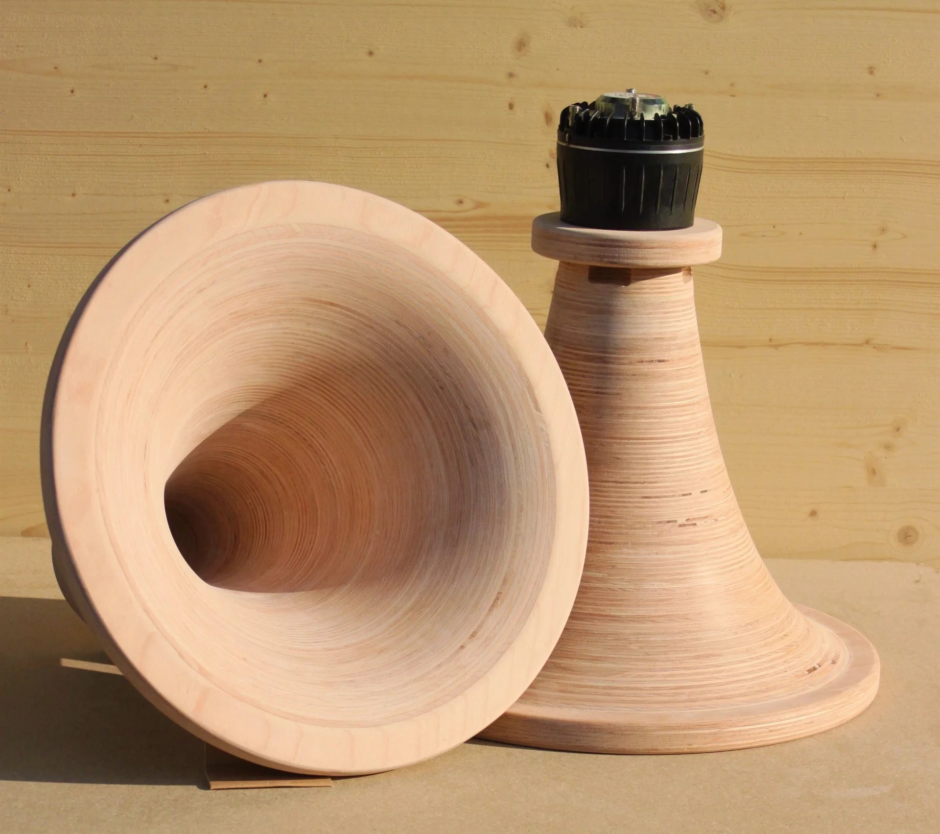

Sure, one can do many things. But the acoustic result is what counts and that doesn't look as a very nice device to me.

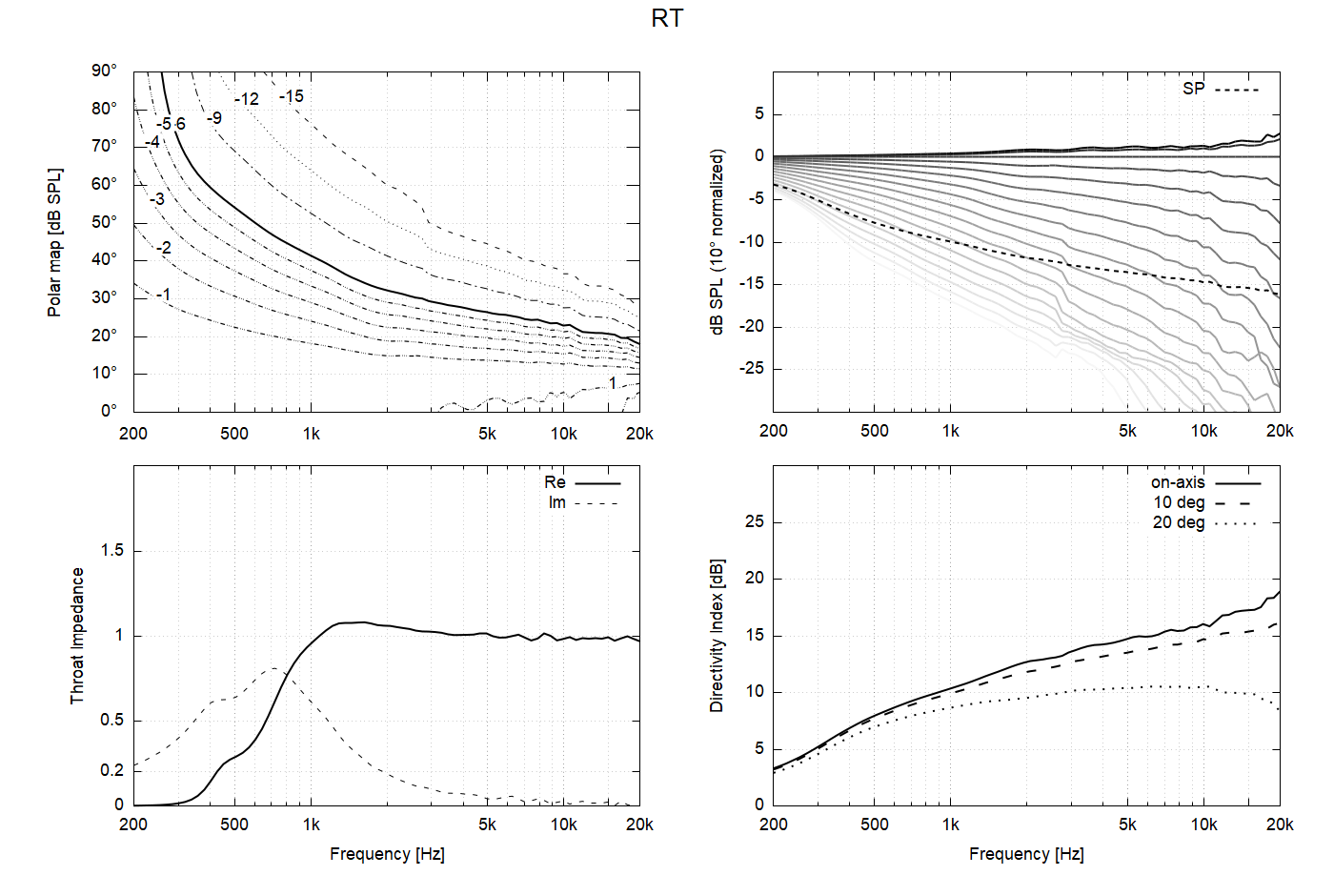

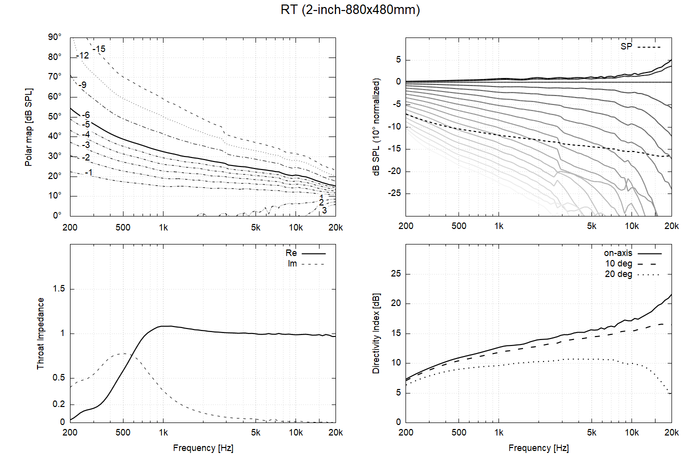

BTW, this is 2" throat, axisymmetric horn ⌀880 x 500 mm:
https://www.desmos.com/calculator/gcqpk1l1ww
Still no trumpets here 🙂
View attachment 1186534 View attachment 1186535
Perhaps a 1" version with R=180?
