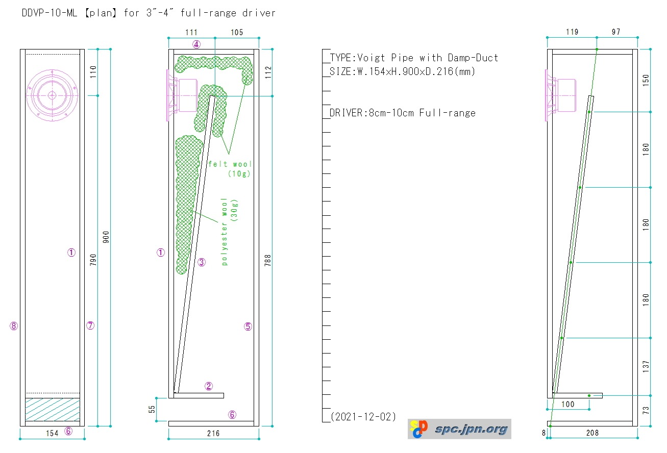

I installed Pluvia7HD in various boxes and found the cost performance of DDVP-10-ML to be the best.
The sound quality is sufficient for my needs and I have no complaints.
The material cost is 25 USD (3,440 JPY).
12mm plywood is 18.2 USD, SP terminal is 4.4 USD, and sound absorbing material is 1.6 USD.

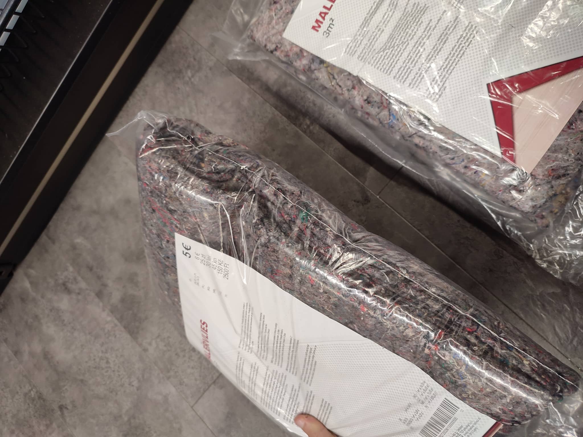

That looks like what i use in some of my cabinets. But it needs to have a certain thickness, like at least 1cm, to work well.Would this kind of insulation also be good for speaker cabinets. It says its made from recycled textile its called painter's fleece.

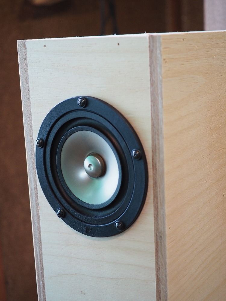

since yesterday i've been following various projects for an active monitor to match the pc and markaudio pluvia 7 hd has a decidedly interesting sound. i also see your projects and all, or almost all, opt for these tall boxes with the reflex made in a certain way brought to the ground. i also see that you position pluvia 7 on the front panel flush with the outside and no one positions it on the inside edge of the front panel. is there a reason why no one has ever positioned it internally?
like this:
like this:
Code:
The basket is designed for front [surface or flush] mounting with slightly raised cylinders around the screw-holes, which would make rear-mounting more of a challenge. The latter also tends to increase diffraction effects in smaller driver sizes; the Markaudio units are designed with very shallow cone profiles & direct-bonded caps so they tend to have a wider polar response to higher frequencies than those with deeper cones &c.
