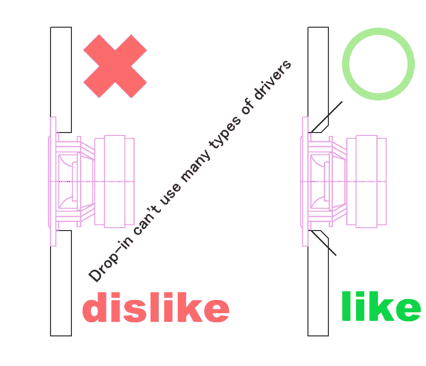

I'm actually interested in the Pensil cabinet the most as its the most simple one to make.
Reactions: 1 user
frugal-phile™
Joined 2001

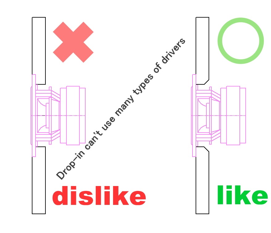

Yes it does. Helps prevent early reflections back thru the cone which can be very annoying. One only needs to survey the great number of instances complaints have been fielded and adding the forgotten chamfer fixed things.
Nandape is too conservative… note the changes to his illustration. The chamfer should start right where the cone can be seen from the side thru the basket, the driver shown (looks like my FR125 drawing), there is a bit of a ring but in the Mark Audio for example, there is no ring, and the chamfer dhould start right away.

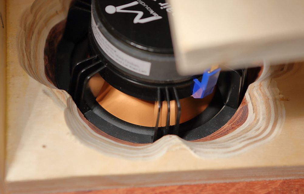

This is a pretty one, if you are using plywood the little bits left for the screws turn out to be unnecessary.
