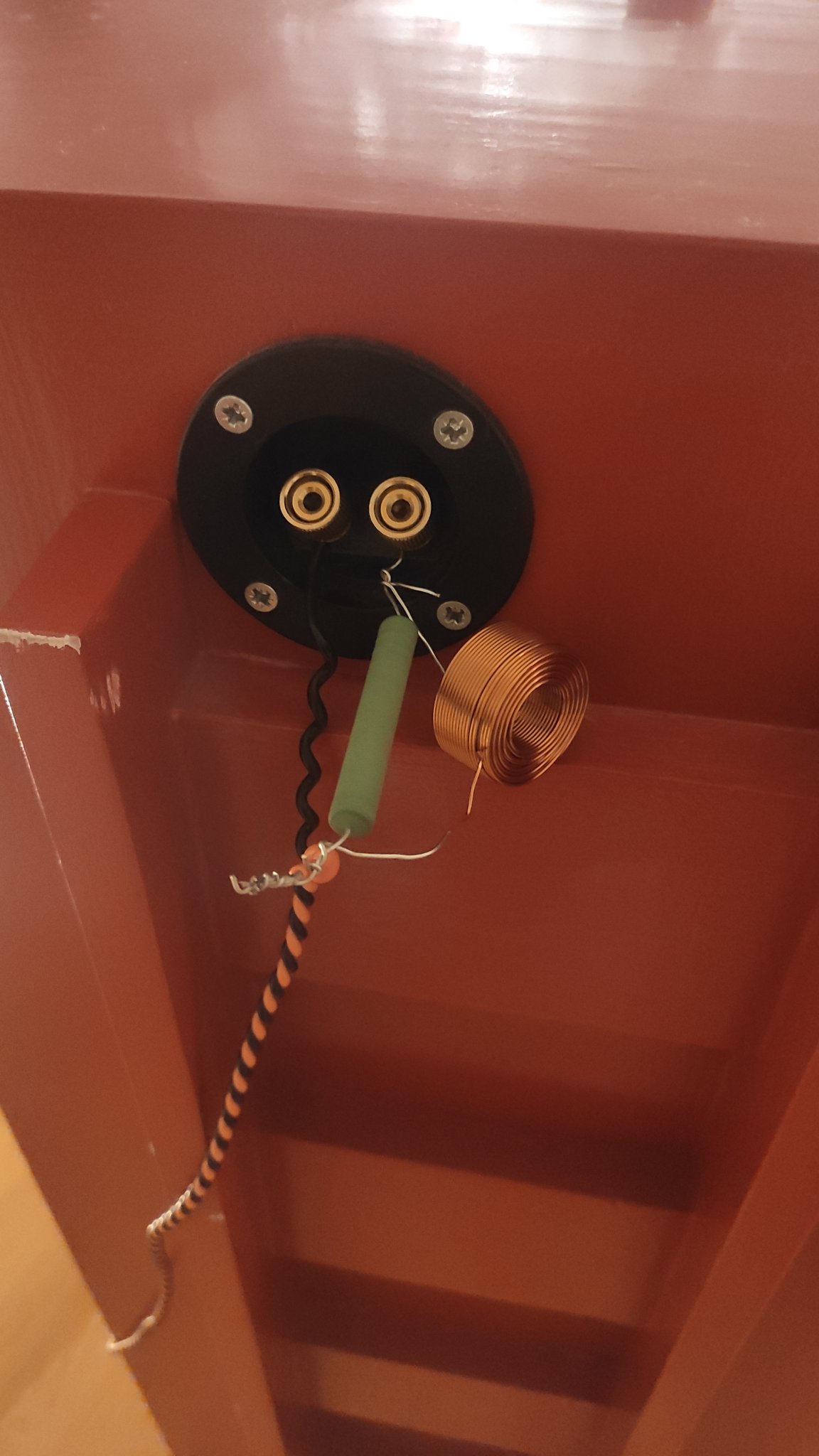

Ok, quick test with as close a network i could get on short noticeto the specs you calculated Allen. Mundorf 6.8ohm resistor + 0.5mH/0.49ohm coil. Well the LF are now deffinately in the room, the general balance is much better for sure, but i have noticed some new things in the sound that were new. That I must do more listening.
I have tried with only the resistor, that alone brought quite a bit of bottom end but kept the character fairly in tact. Adding the coil changed it a bit, somewher in the HF. Not sure what to make of it yet.
I have ordered now a few more resistors and coils to test (a "propper" bsc with a higher value inductor). Also on the way is a umik-1 mic, some neotech solidcore 24a wire and some audiigrade felt.
Looking forward to playing aroud, this is fun🙂
I will try soldering everything together ofc, not sure how much of an neg. impact just twisting stuff together has?

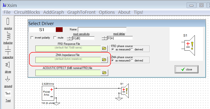

I'm starting to dabble into Xsim, trying to get a feel how various components/values/networks behave. Most is as expected, but having a single resistor in series, like I have tried yesterday, seems to attenuate across the band equally - that is to say the shape of the FR plot does not change, merely moves "down" apropo the value of resistor used.
I have tested this yesterday and it resoulted in more bass (comparatively). It was rather obvious. Is this due to reduced damping factor, which allows the driver to "flabber" around more freely near its resonance, but Xsim software doesnt acount for?
Yes, I've taken both the frd and zma files from another FR driver (Tangband). I know its not hte same, but the effect should be? Its what I could find. If you have both files available for fostex FE206En, please! Otherwise I also found FPGraphTracer, which I will try to use.

Sorry, I really should have been more precise. Checking again now, the FR graph was showing only 100hz upwards, so I was missing the lower bass! That clears it up, thanks!
Also with the file you shared, I also see less attenuation towards top most FR (as driver impedance rises again).

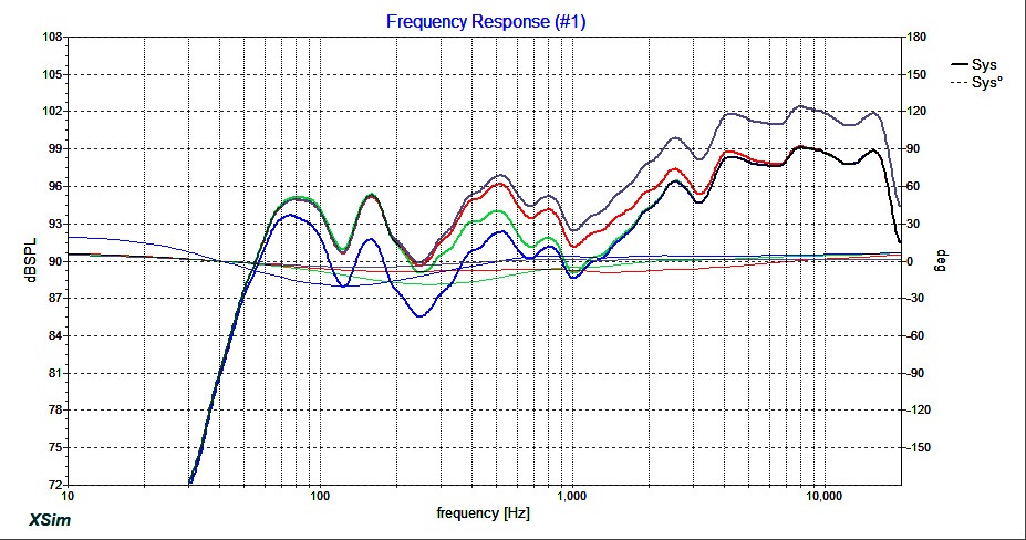

I sucessfully traced Fostex' FR graph for the BLH and ran a sim. Will do an actual measurement once the mic arrives.
Grey - 1.5R (amp Rout)in series - IS THIS CORRECT?
Blue - 1.5R (amp) and 6.8R in series
Red - 1.5R (amp) and (6.8R+0.5mH paralleled) in series
Green - 1.5R (amp) and (6.8R+2.2mH paralleled) in series - to try next
Listening impressions Blue vs Red. Im quite sure I prefer Blue (just the resistor in series). Adding the small inductor brings the upper midrange back up, comparetively kills the just the highs. Sound is muddier and darker, but overall just feels less balanced. Note I'm listening ca 20-30' off axis, which brings the topmost range down anyway.
Next to try is a higher value inductor 2.2mH in paralel with the resistor, as calculated for BSC. That seems to tame the upper midrange more.
What do you think? Am I doing this right?

Well, it makes sense that the coil passes low, not high so it's lower resistance at low frequencies (approaching it's DCR), compared to the 6R8 resistor it's in parallel with, means that having the coil in place brings up the lower frequencies relative to just the series added 6R8. But, is it causing a phase shift in the signals it passes? Is that muddying up the low frequencies? Dunno.

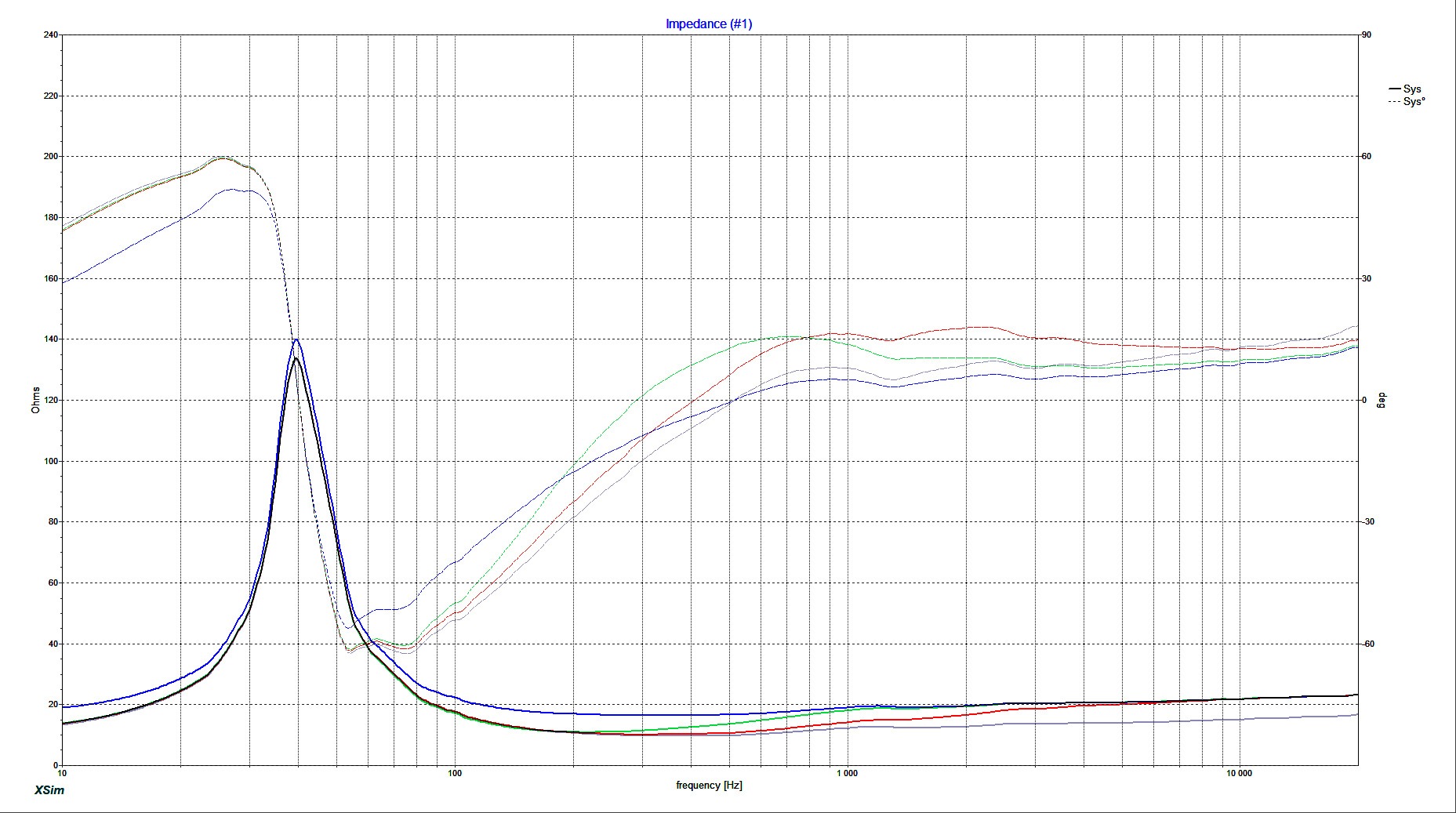

The impedance file is the one that allows you to see the changes that the crossover components make. I've been showing the filter effects without a response file, in a way that makes them easier to see.
Of course the response file allows you to see it all in context. Remember that it doesn't yet cover extra effects like the baffle.

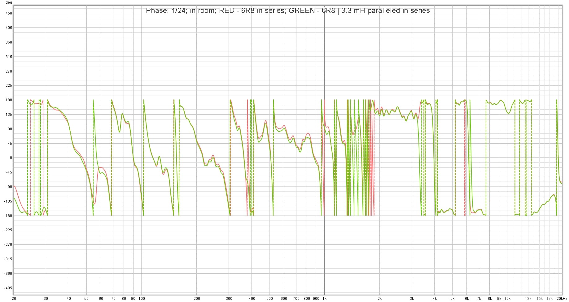

ranshdow, the phase seems to be "shifting", but not dramatically so to my eye. Not sure what to make of that either. 🙂

There's probably not anything to make of it. If I'm reading it correctly this is what the amp will see, and they're all usable. The phase varies with the response variations, no surprise there. The different impedances represent attempts to vary the response, as expected, but that specific information is obscured in this point of view.

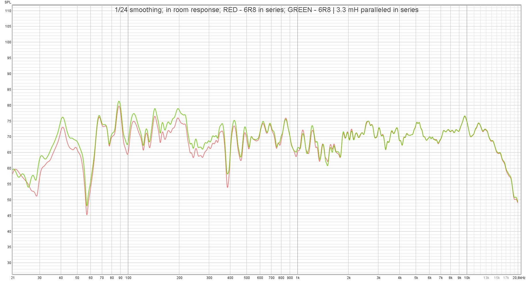

But now I think I have landed into "happy with bass" territory. I've now put a bigger 3.3mH coil in parallel with the 6R8 (in addition to 1.5 rout of ACA). That has brought the sub 300-400 ish Hz frequrncies up another 3db or so. Sounds fuller. So much so that i have even angled the boxes back in to maybe only 10'deg or so off axis. This added appreciatable detail, without beeing overpowering.
I have even measured with a calibrated mic now, and the smoothed out response is near flat from 40hz all the way up. I will include graphs when I get home.
Ofcourse there are still some local peaks and dips and the upper range is wild. But it feels like I can now move to phase two, tweaking the driver and enclosure/damping to smooth out the response.

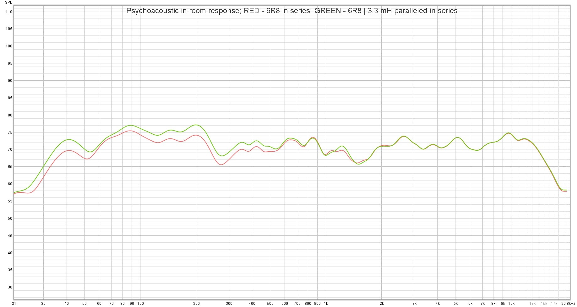

Here are the plots from my listening position, comments on the image. Recorded with a calibrated Umik-1 in REW. Its fairly consistent with what i got in Xsim, so im glad thats working. Now some questions to help me understand this better.
*note, speakers are only slightly toed out (5-10 deg off-axis from mic), ca. 3m away in ca.30 sqm room.
1. How does it look in general, what might be the biggest eye-sore, what might I try next?
2. That dip at 50Hz i believe must be room related, what do you think?
3. What can I do regarding that dip at ca. 300 Hz?
4. What can I learn from the phase plot?
5. Is there any other plot in REW I might want to take a closer look at at this stage?
Appreciated as always!

Regarding your REW sweeps I agree the 50hz dip is likely room related and probably not something you’d notice 90% of the time. How do you like the sound?
