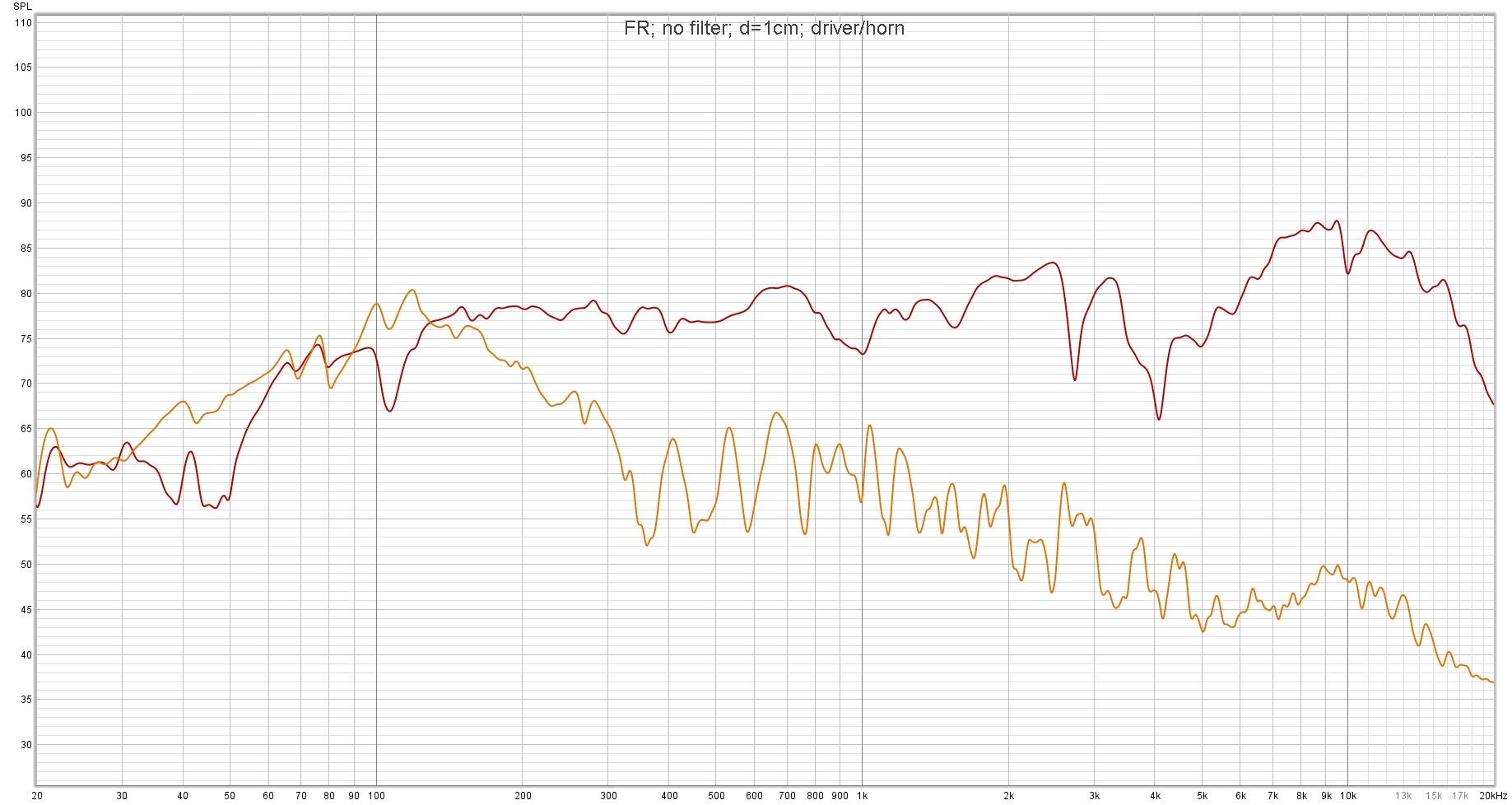

1. Measurement from 1cm (driver/horn), no filter, straight into ACA. THe level/volume was kept at the same position between the horn/driver measurements.
2. Driver from 1cm; no filter vs. 8R2 || 3.3 mH - this is overdone, it attenuates too low, 2.2mH should be about right
What do you think? I'm still most suspicious of that 700hz peak, clearly not room related. Is there something to do about it, without getting into a notch filter?

Did you try moving the mic around in different spots (still close to the cone)? Whizzers, as I understand it, can have phase interferences with the main cone, and perhaps across their own diameter.
Maybe, see if the bumps are reduced if you move the mic out to 30cm or so, and from side to side. It seems like the most troublesome bumps are the ones that are picked up no matter where you measure.
Since it is easy to do, you might try stuffing the compression chamber with wool or fiber-fill to see if that has an effect on the bump at 700hz or just to learn what such a treatment does generally. I have done this to smooth out the midrange for drivers (that were in small sealed transmission lines).
It is not just the hump around 700hz, but the dip that is above it which is curious. If you are interested in learning/experimenting some, you could take a driver out, mount it in a sheet of plywood, and measure it from various distances. See what characteristics change. You could even put the driver in a sheet of cardboard or foam core board if the plywood is too expensive/troublesome.

Good tip, i will try experimenting a bit more with measuring to get a sort of an averaged response.
The compression chamber is completely filled with mineral wool (by previous owner). I actually just got some acoustic felt, 8mm and 20mm, to experiment with. Some seem to even prefer these drivers without any damping behind it, but it doesnt really seem likely in the fostex horn, which has a rather shallow space behind it, with all parallel walls.
This peak at 700hz (and dips both side of it) i picked up with my ear even before measuring, so its a bit of a comfirmation. We'll see what happens with damping.. measuring in an open baffle might be revealing too, as you say.

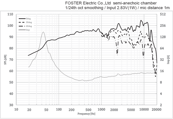

I found a few measurements that I made of one of my FE206E (stock cones, but with duct-seal between the magnet and frame and dampening material on the frame spokes). All were made at 12”/30cm, one at 20 degrees off axis, one with a version of the 98cent tweak-poly-fill stuffed between the cone and the whizzer. All were made with no baffle, just bare, sitting on the couch. The big peak/dip either side of 1000hz is not there in any of them.
what did you use for dampening material on the basket?
Very pliable leather, glued on, probably with E-6000 (solvent based, like Goop or Goo brands, that are sold in squeeze tubes at hardware stores in the USA), wrapped around the spokes and clamped with small spring clamps (or clothespins?) Any glue that sticks to leather would likely work.
There is a type of leather called “deer-tanned cowhide” which is not too expensive, but is quite supple/flexible. Actual deer skin costs much more. But since you don't need much, buying either new might seem expensive. Maybe recycle an old split-leather or suede clothing article?
I have also seen wool teased out and lightly placed in the space between the back of the cone and the frame, which should damp down reflections in that area. This probably would not work so well (?) on drivers that have greater excursion capabilities, but I don't know for sure.
