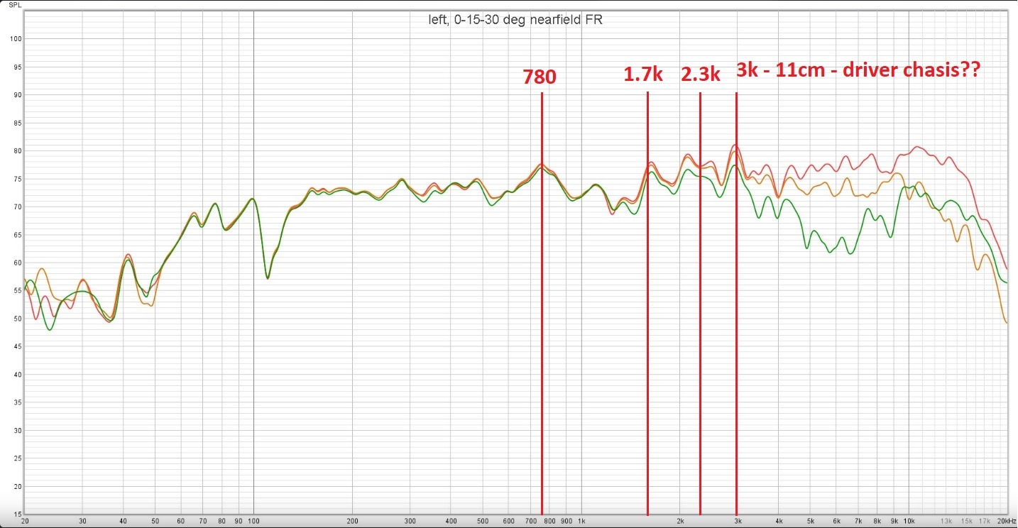

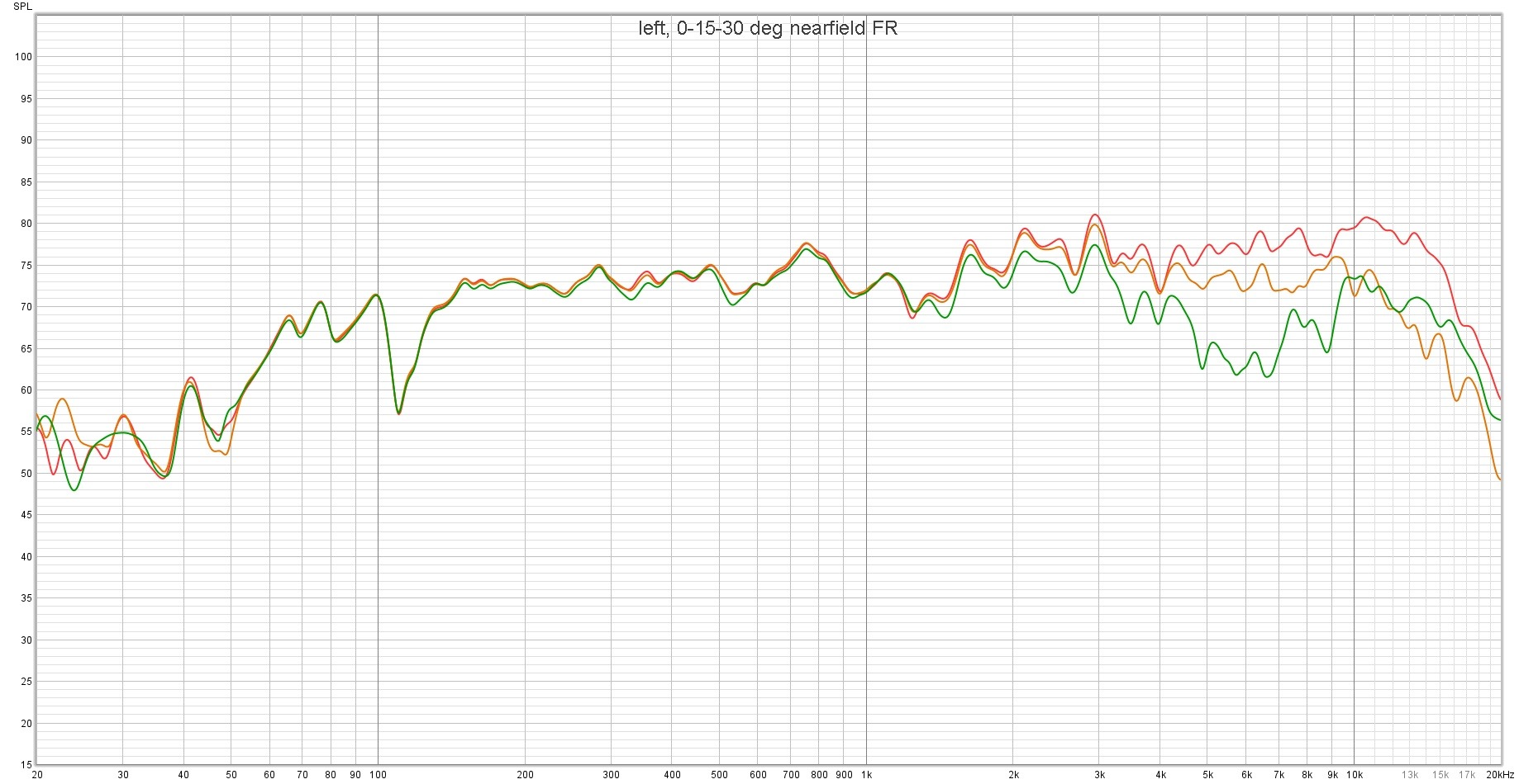

I have also done some more nearfield measurements and played with speaker position. They were set up roughly in a 3m triangle, with them firing directly into the room (roughly 30 deg off axis. I have since actually toed them in slightly to ca. 15 deg off axis, and found the trade off between extension of the highest frequencies and that peak around 2-3k favorable.
Nearfield measurements confirm this, past 15-20 deg or so, the highs get a little unpredictable. At 30 deg there is a wild dip from 3-7k and a peak at 10k. This i speculate could be due to the space between the whizzer and the membrane acting like a little horn amplifying those frequencies at that angle. This is where the foam mod could come in handy as well.

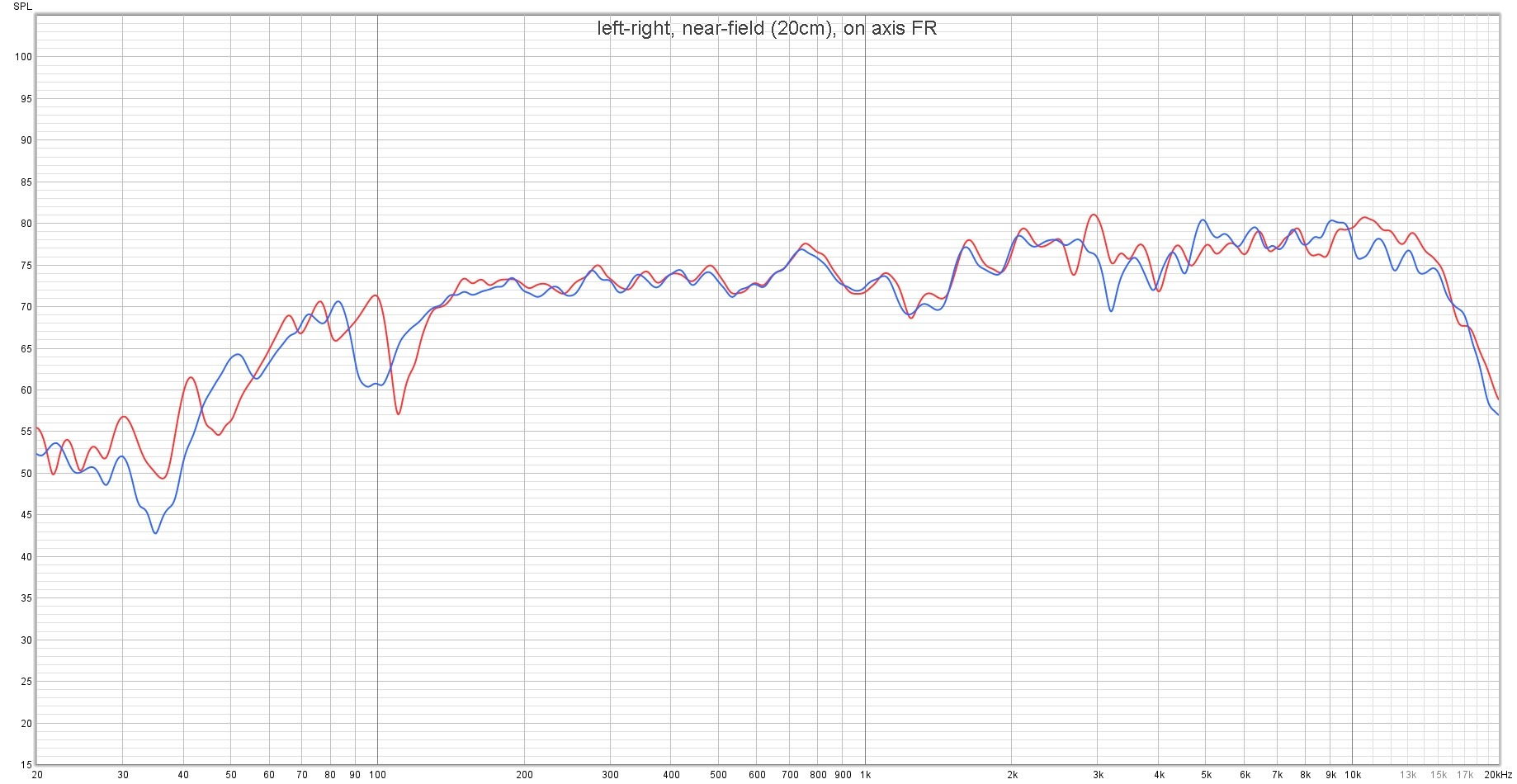

Also including L-R nearfield on axis, does it seem consistent to you?
All graphs are 1/12 smoothing, calibrated umik-1 mic.

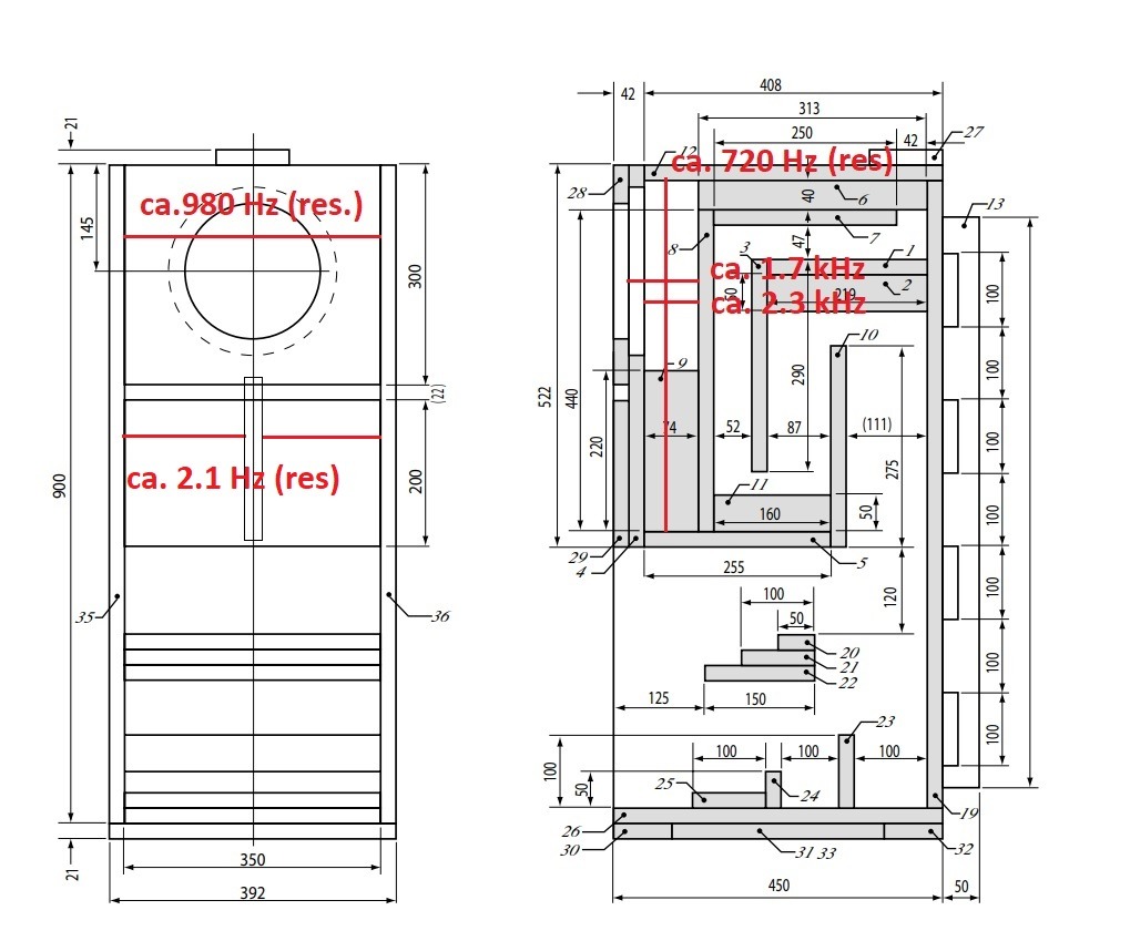

Than there is that 700hz peak, which according to some of your fellas' reports shouldn't be there. Should be enclosure related,
I've plotted some reflection and resonant modes of the compression chamber against my nearfield measurement, The 780 HZ and 1.7-2.3kHz come up. Does this seem a likely, despite being completely stuffed with mineral wool? The 3kHz peak corresponds to ca 10-11 cm, could that be the driver chassis bounce (5cm 2 way)?

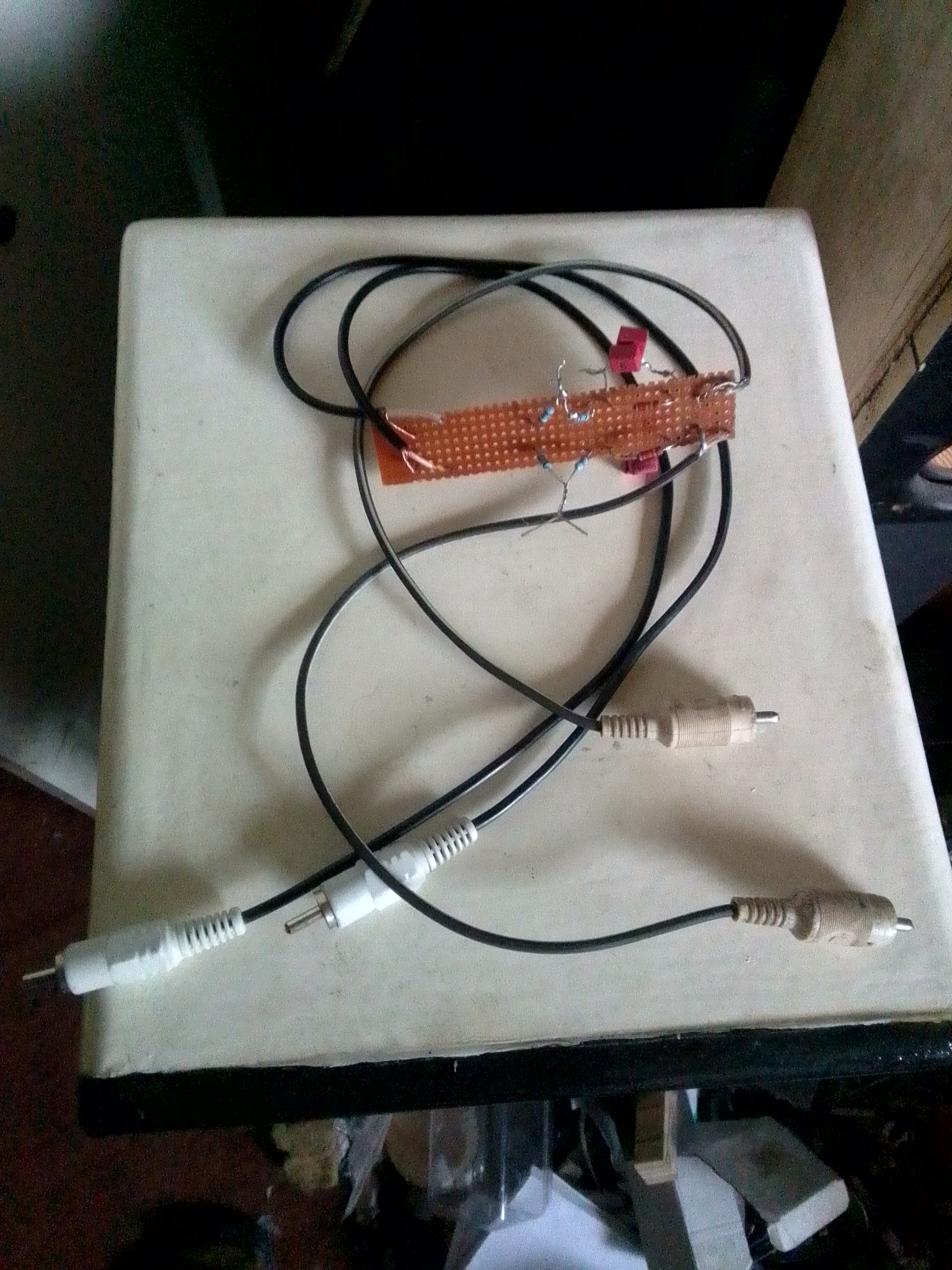

Yes, it's a line level passive network. I was first using a resistor network that fitted inside an rca plug in-between the DAC and a cheap class d amp that has a linear instead on log volume pot ("dolytec brease" or something) - the attenuation helped with controlling the volume at low levels, and since some speakers had falling off treble, I just thought that I'd bypass it with a cap. The third generation version won't fit in an rca plug, so I'll have to use a plastic box to house it in.

cracked case said: Yes, it's a line level passive network. I was first using a resistor network that fitted inside an rca plug in-between the DAC and a cheap class d amp that has a linear instead on log volume pot ("dolytec brease" or something) - the attenuation helped with controlling the volume at low levels, and since some speakers had falling off treble, I just thought that I'd bypass it with a cap. The third generation version won't fit in an rca plug, so I'll have to use a plastic box to house it in.
Thank you for showing this. It seems like an elegant solution. I can imagine that it could be a more transparent solution than using passive components between the amplifier and the drivers.
When I have brought up this line level filter idea before, I have been reminded that the component values are dependent on the input impedance of the power amplifier (preamplifier also???) to create roll-offs at particular frequencies. This is similar to how the reactive components of a speaker crossover interact with the impedance of the system's drivers to create crossover points. Fortunately for the line level implementation, the power amplifier has a stable input impedance; while speaker drivers' impedance varies with frequency and drive level (and other factors???).

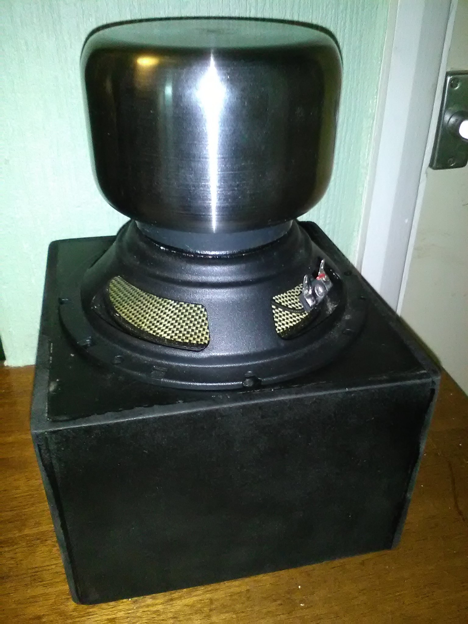

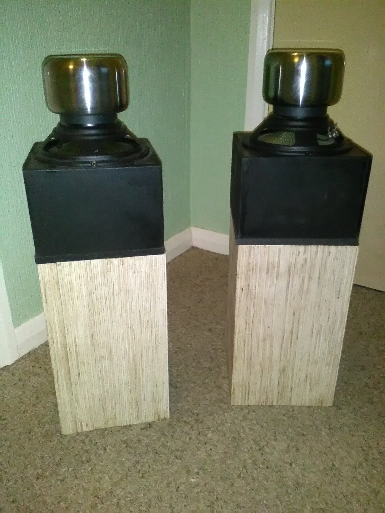

Now I have a Faital Pro 10FE200 in 10”x10”x5” deep (internal) U-frame; this also has the corners filled in to make the square cross section into an octagon. The Faital is sitting on top of the 33” tall back horn at about seated head-height, with the FE206e about 3” below, frame to frame, about 12” center to center. A 10mH coil inline with the Faital, no filter on the 206. Because the 206 is lower, my head is about 10 degrees off axis.I made a coat hanger wire bridge across the 206 frame and hot glued a ping pong ball about 1cm in front of the dust cap. Also put some dots of hot glue on the ball to lessen possible resonances. Seems to beam less intensely on axis, but the upper mids really are very strong still. They are most likely coming from the whizzer. I have not measured it, but hope to get around to doing so soon.
Playing the integrated stereo amp in mono mode, one channel to each driver, balance slightly in favor of the Fostex. The slowly rolled off Faital does a great job of balancing the rising response of the 206. For an economical pro driver it has an acceptable smooth and lively sound for HIFI use.
Also have an OB u-frame 15” sub engaged for the last octave minus 10hz.
This combo plays well above the level it's monetary outlay would indicate. It reminds me of Hi-eff horn systems that I have heard. Chances are that the LP filter on the Faital could be more precise, but just balancing the FE206e spectrum response with a nice sounding OB hi-eff driver really is nice. We must remember though, that not all pro drivers work well in hifi systems, due to response irregularities and colorations. Also, of course, bigger drivers beam more. The 10FE200 is said to be(parts express)appropriate as a large format midrange.
