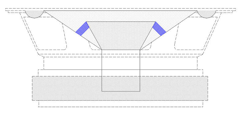

3 key things to look for, puzzlekoat (modpodge), ZIG 2-way glue, and ductseal. In particular there is a post specificlly on FF165. Here the generix coverage: https://www.t-linespeakers.org/design/tweeks.html
FE20x plugs are still proprietary, i will release the plans when i sell out the few i have left.

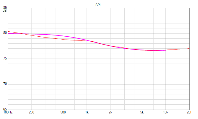

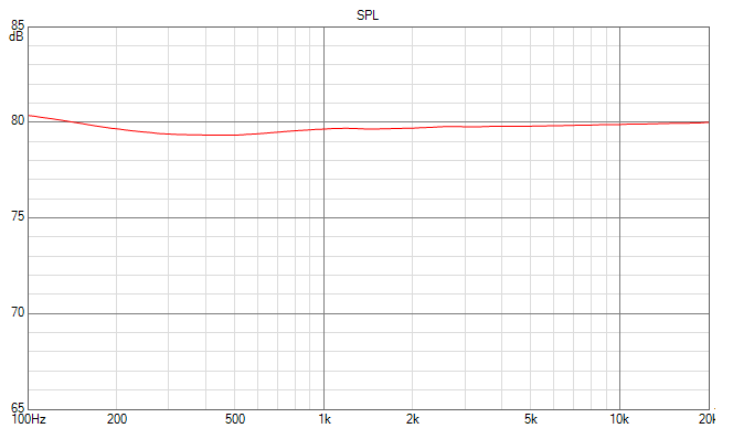

Meant to, got distracted 🙂 No, you don't want to subtract the 1.5 ohms as it can't be included in the filter.Did you take into account Rout of the amp whivh is 1.5ohm? I wonder if that drops the resistor to 5.3 in turn?
Ok the 1.5 ohms will already be causing a small variation to your response. To verify the shelf filter is working the same as a line level one would, these small differences should remain untouched before and after. I'll show that much in this post.
Firstly this is the driver against the 1.5 ohms and no crossover..
Now after adding the resistor and inductor, the 0.7dB dip in the mid hundreds of Hertz remains as wanted..
(If you want to tune that out similar to if you were using an amplifier with a near zero output impedance, we can do that in a later step..)

Note that a driver with a glued on dust cap can be viewed as a two way (coax) and with a whizzer a three way (triax) and all can be fine tuned physically.
No pics, write ups, just that way back when on a long gone forum I noted that kneading the whizzer between my fingers to ~literally take the starch (stiffness) out of them smooths out its midrange and if too much ('dull'/soft), then 'touching up' with cheap lacquer hairspray to add back some stiffness to 'taste' (sounds good to you).
Also found that on dust caps, a stick on star like used on little children's school papers/drawings can do wonders for this tweeter's breakup modes.
