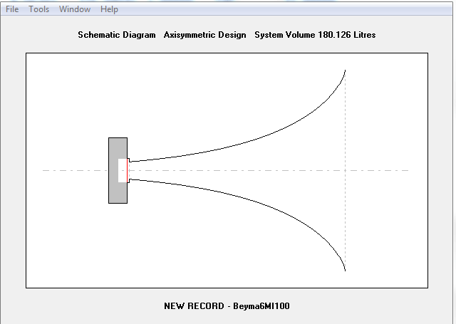

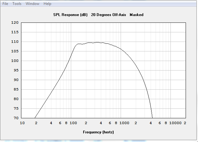

200hz, or even lower maybe 150hz at a push. Looking at anything from 6" to 15" driver, still have a blank sheet of paper.🙂
OK, so you want go from 300Hz to 200Hz crossover?
Totally forget using a 130Hz tractrix from 150Hz. Even 200Hz is actually below optimal with this conearea. It will not help pushing it 😉. Why not build a 100Hz instead😎?
The only way to go lower is to remodel to a "hornreflex". With a 150Hz below 100Hz will be no problem. But then senstivity and low bandwidth are the the eventual problems. Only OK for midbass, so this is nothing for you.

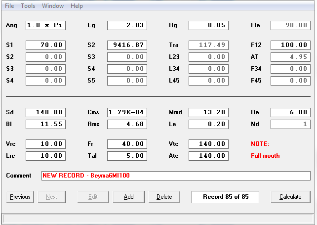

Sheets of MDF are a max 1200 wide so I will set myself a limit of 1200 max at the mouth. 113cm long and 110cm wide seems to be the quick calcs on a 100hz tractrix horn with 80cm2 opening. Seems doable. Now I need to find a driver🙂
With a horn that big you're going to have to think carefully about where the mid-treble horn is going to sit, if it's time-aligned . It's going to be a long way up.
This is one of the reasons people compromise with exponential/hyperbolic horns for the upper bass .

Yes, I have done a few sketches and when the horn gets over a metre long, with a width of 120cm it creates other difficulties.
Maybe I will go back to a 100cm tractrix.

JLH, about the Delta Pro-8A, what compression ratio and cutoff have you used for this driver?
85Hz to 600Hz with 2.7 compression ratio.
