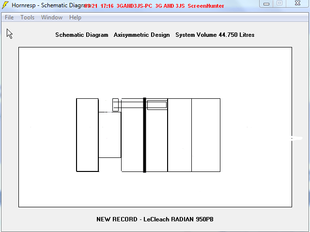

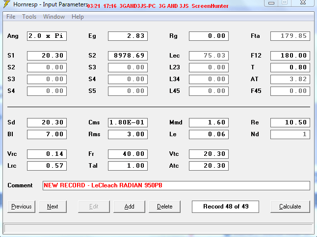

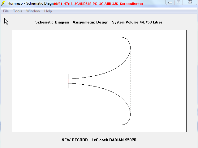

Since I have Chosen the RAdian driver and I a crossing at 300Hz I probably dont need a 130hz horn.

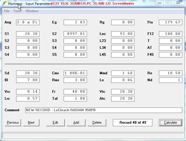

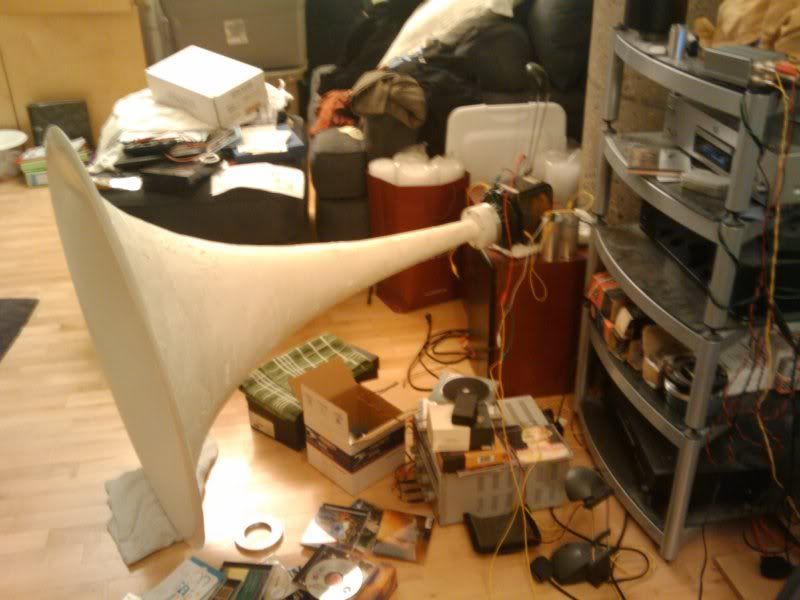

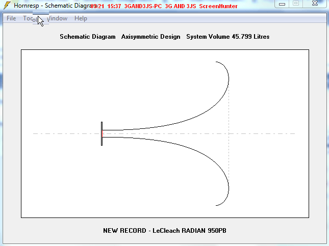

Here is 180hz LeCleach horn. It will be roughly 90cm long and 90cm in diameter.
This is a preliminary measurement of the 200Hz Auto-Tech LeCleach horns(L=65cm, D=100cm) we just received. There is now idea whatsoever to build them ourselves as that would be more costly.
Note the 2441 below the horn😉.
These or a pair of 180Hz horns need to be c/o at 3-4kHz.
But you still need a pair of midbass horns below 300-400Hz.

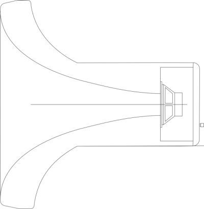

Is it acceptable for the horn flare to drop down in a straight vertcal line (taken fron the last point given from hornresp). I have seen some where the curve is continued around (as in the picture posted above). My horn will be 50mm thick plywood and this should look nice and be simpleto build.
I assume this is purely aesthetics. I am making the template for the 180hz LeCleac'h.
Here is a very poor sketch of what I meant, I will give it a nice round edge.
My lower midrange horn has also a more pronounced edge, towards LeCleac'h profile, its something between regular tractrix, and LeCleac'h. I don't think such big lips as zagaja did, brings a considerable advantage. Neither do i like it aesthetically. And you will be obliged to set the acoustic centers of the other channels more far away. Making a 4" throat, and a adapter for 2" is however clever, so you can play, and try paper cones out.
You will also need to think how you will attach the horn to the frame. May you make a part of the outer section straight, or square.
I have experimented a bit and if i return the edge with a curve of approx. half the radius of the outer flare it looks right to me. I will make one of the joints at the 4" point to fascilitate 8" drivers.
The 50mm wall thickness will allow me to put a rebate in the outer edge to allow a bolt to hold the 4"/2" adapter in and also the driver.

Hi 3GGG,
Sim your horn with the 85-90 degrees above and compare with your 180 degrees. You will the see it will be a considerable difference. For mid and high the full 180 degree is essential. If you use Jean-Michells spreadsheet you will also get the figures beyond 180 degrees.
In the case of low-mid the effect will not be as important as such a horn will be helped by mirroring from the floor. I wouldn´t go over 90 degrees for low-mid either.
post68.
The 180degree return looks good. It should be possible to make a template from Hornresp that gives the shape you need.
If you retain a bit more material on the back of the mouth, you can extend the return to 270degrees where it meets the outside of the horn outer thickness. this could be pretty close to a full Lecleach.

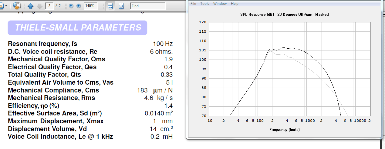

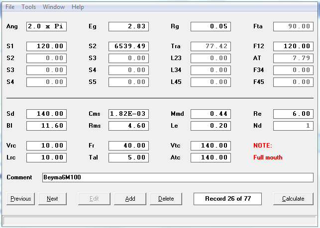

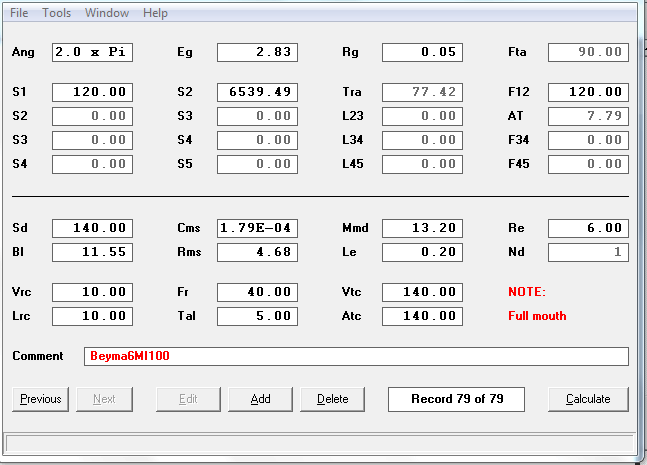

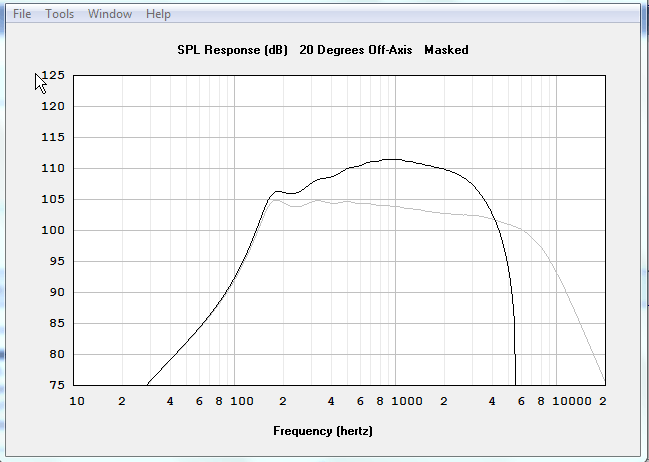

I have been playing on Hornresp a little more. Can someone explain why the 20 degree of axis response is so different on this driver, the Beyma 6MI100.
