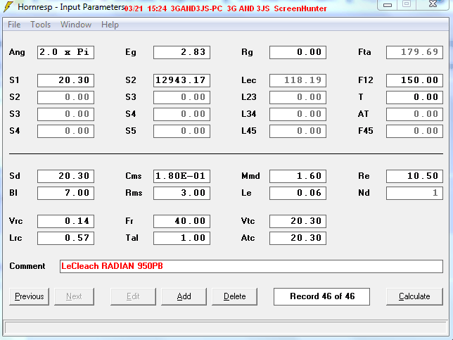

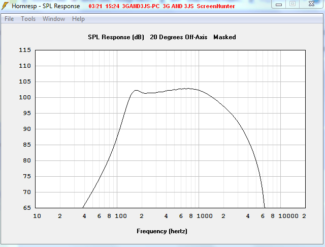

Mark, the idea of a 10" in a big horn and then the Radian has alot of merit. The price of the Radins is nice so they may well get the first call up fot the smaller horn. Since i am building the horns I have a degree of flexibility in the size of the throat.
I havent been able to get Hornresp to show much response down to 120 hz though.

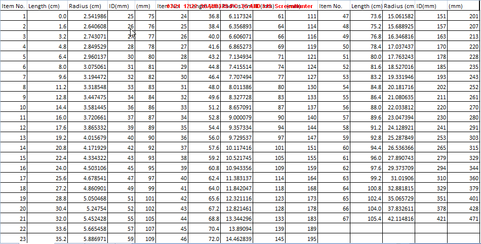

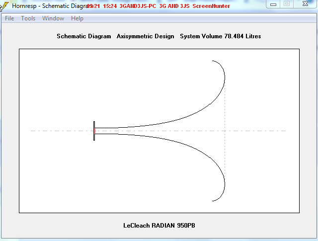

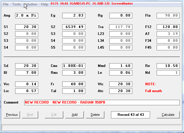

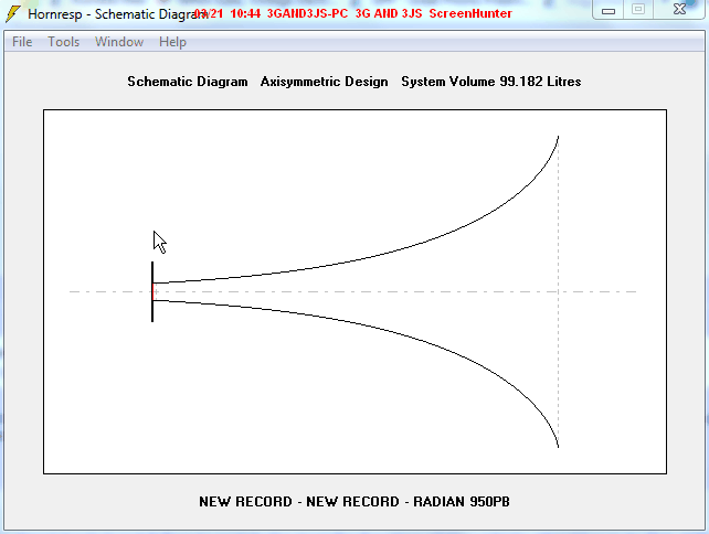

I have made the decision to try the Radian driver in a 130hz tractrix horn. It will be 105cm long and 84cm in diameter.
