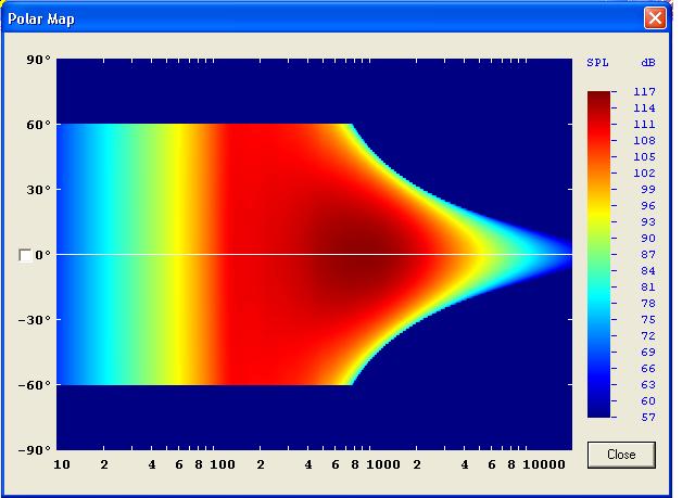

However, it's not a constant directivity horn . Analyse it with Tools > Directivity option, axis or 10 or 20 degrees off axis ...

Here's the polar map. The directivity tool showed constant directivity up to about 400Hz. Then it fell off a cliff.

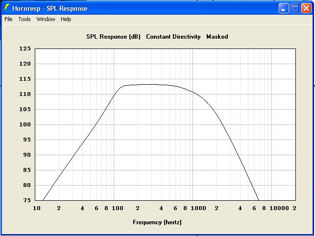

If you ever had the pleasure to work with this driver you would understand. Its not always about the numbers, but about the actual real world performance. Its the only woofer ever made that can do +/-3dB from 85Hz to 5KHz at 109dB 1W/M sensitivity.

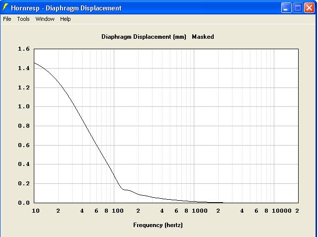

Maximum excursion at 60Hz is 0.6mm. Xmax for this driver is +/-1.0mm, and Xvar is +/-4.5mm.

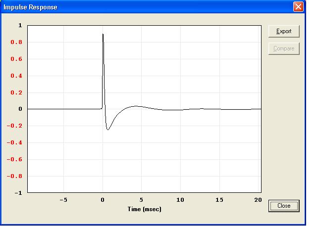

Simulate all you want. It doesn't result in real world measurements. Until you can understand that there can be quite large differences between simulations and real life you will not be able to advance your design skills. In the end you have to build a lot of stuff and gain experience. I can tell you from first hand measurements that the impulse response of a 126Hz full size tractrix horn without a back chamber looks more like the Rocky Mountains. This is with either the 8PE21 or the Studio 8M. It lacked taughtness and dynamics/punch. Once reactance was annulled the sound was much more dynamic, better dampened and controlled. The smearing was gone and the silence between notes was much better resolved. It really is a night and day difference.
