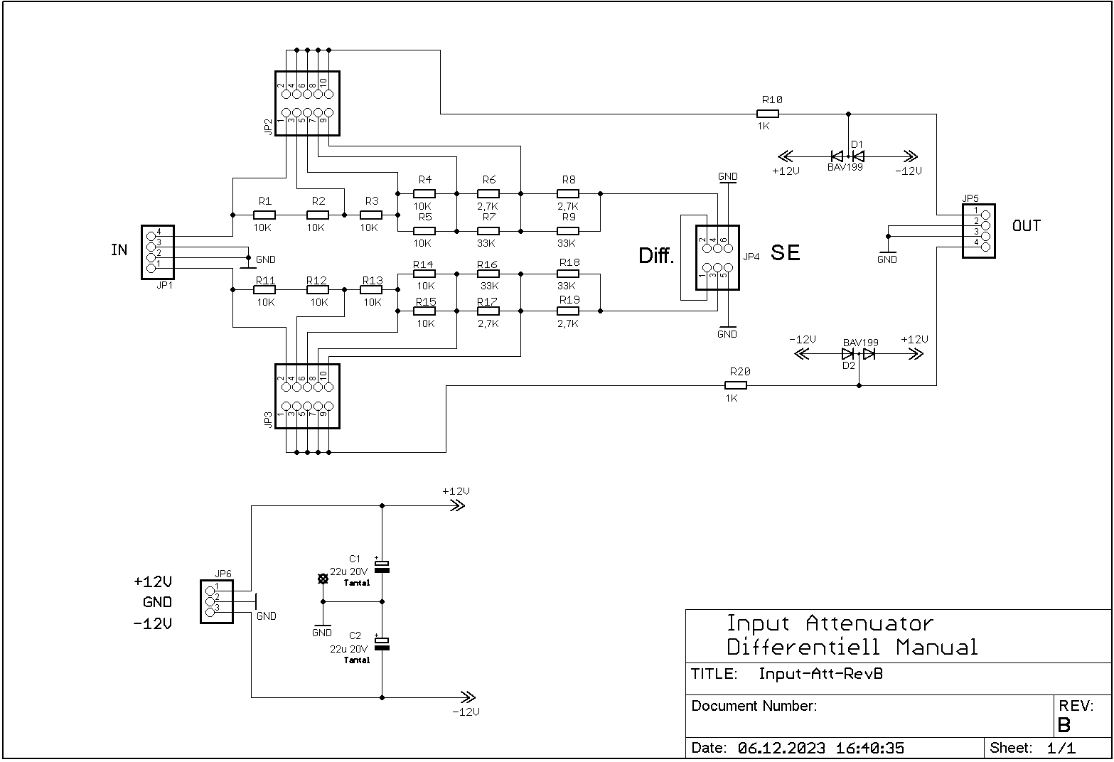

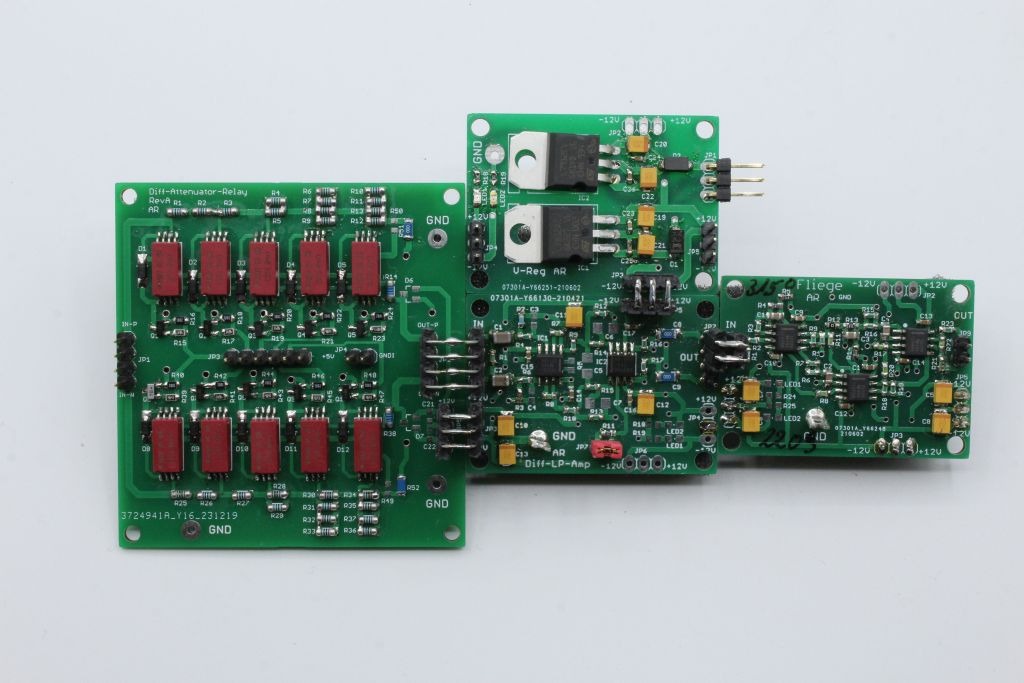

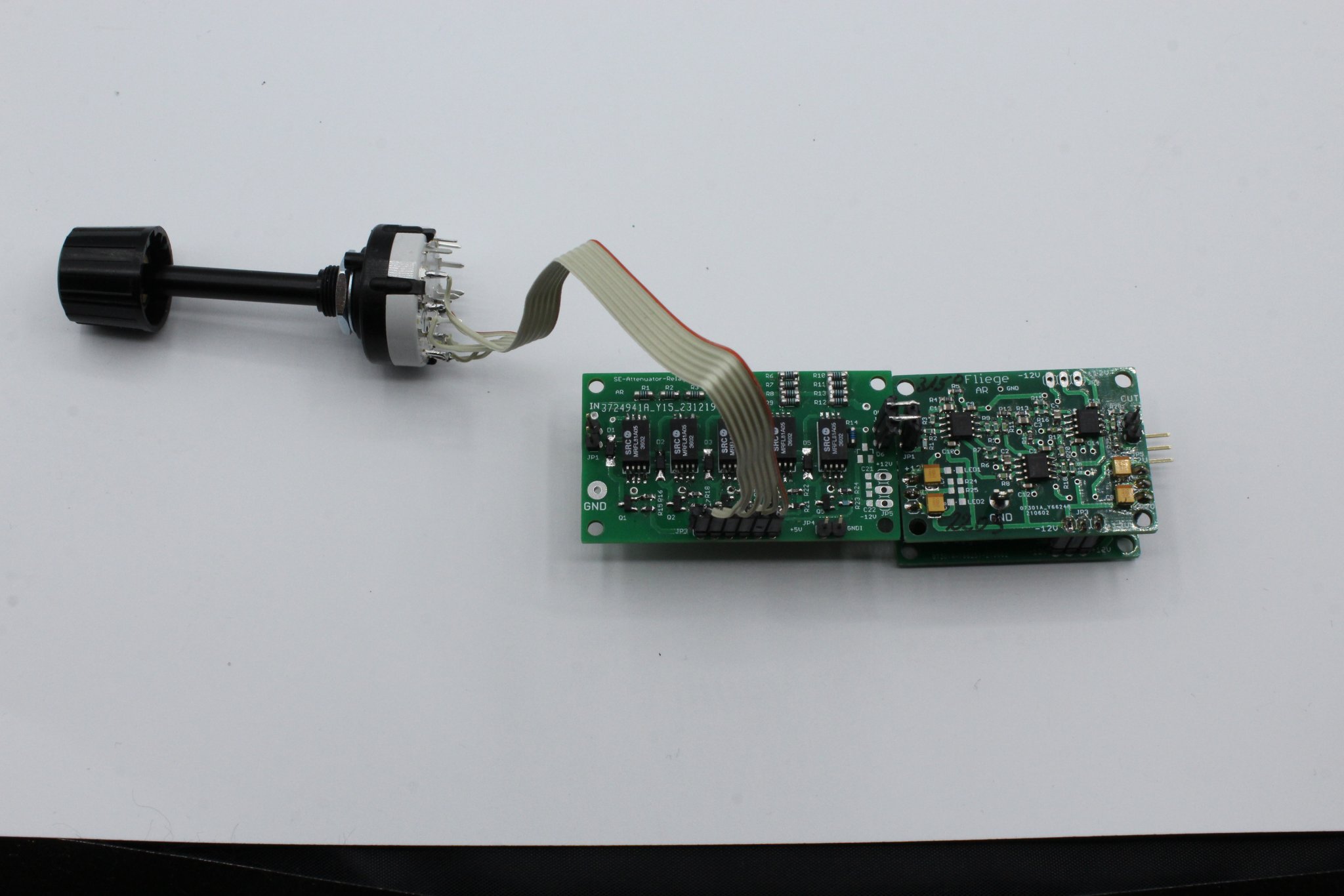

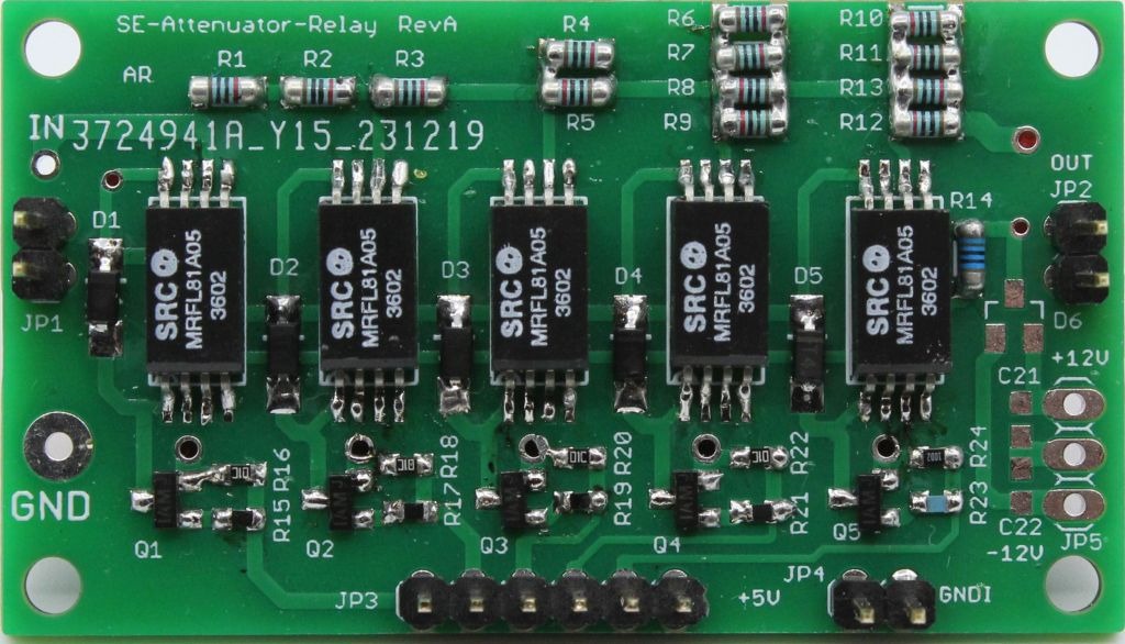

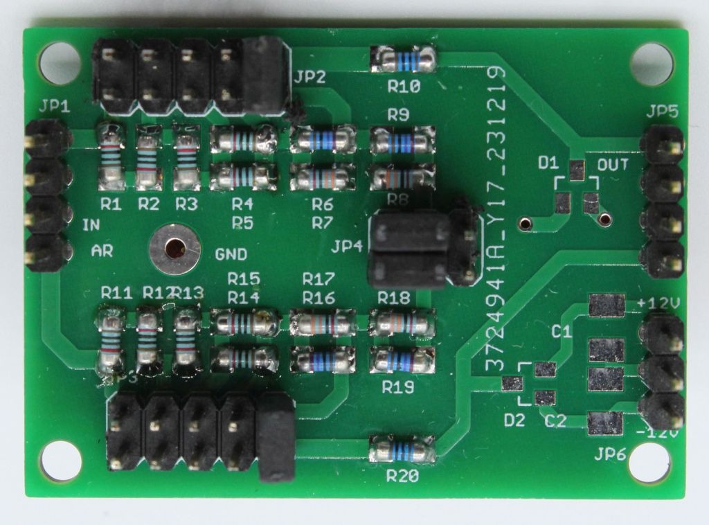

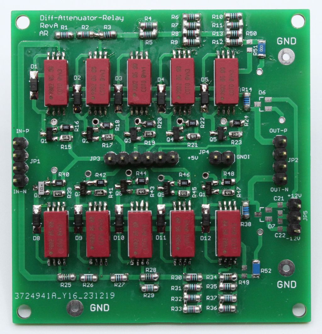

first of all I wish you a happy new year.
I was pretty busy doing some input attenuator boards both single ended and differentiell, manuall (jumper) or with relay.
Here are some pictures.
This is the manuell version. Two times single ended (stereo) or one times differential.
This is the single ended version using relay to switch. Can be controlled by a rotary switch or a controller (Arduino, ESP etc)
Now the differential one with relay.
This is how the SE relay attenuator may be connected to my dual fliege notch. The voltage regulator board is under the notch.
Finally the differential version. From left the diff attenuator, fully differential amp, dual notch filter. Above the amp is the voltage regulator.
Put it in a box with some switches and connectors and you get a nice instrument.
If you like to get some blank boards, just ask.

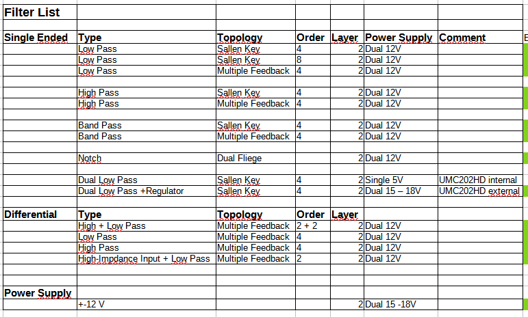

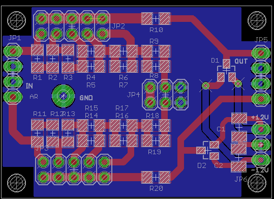

Attached the schematics and layouts of the attenuator and a list of my filter boards.
If you have questions, just ask.
Alfred

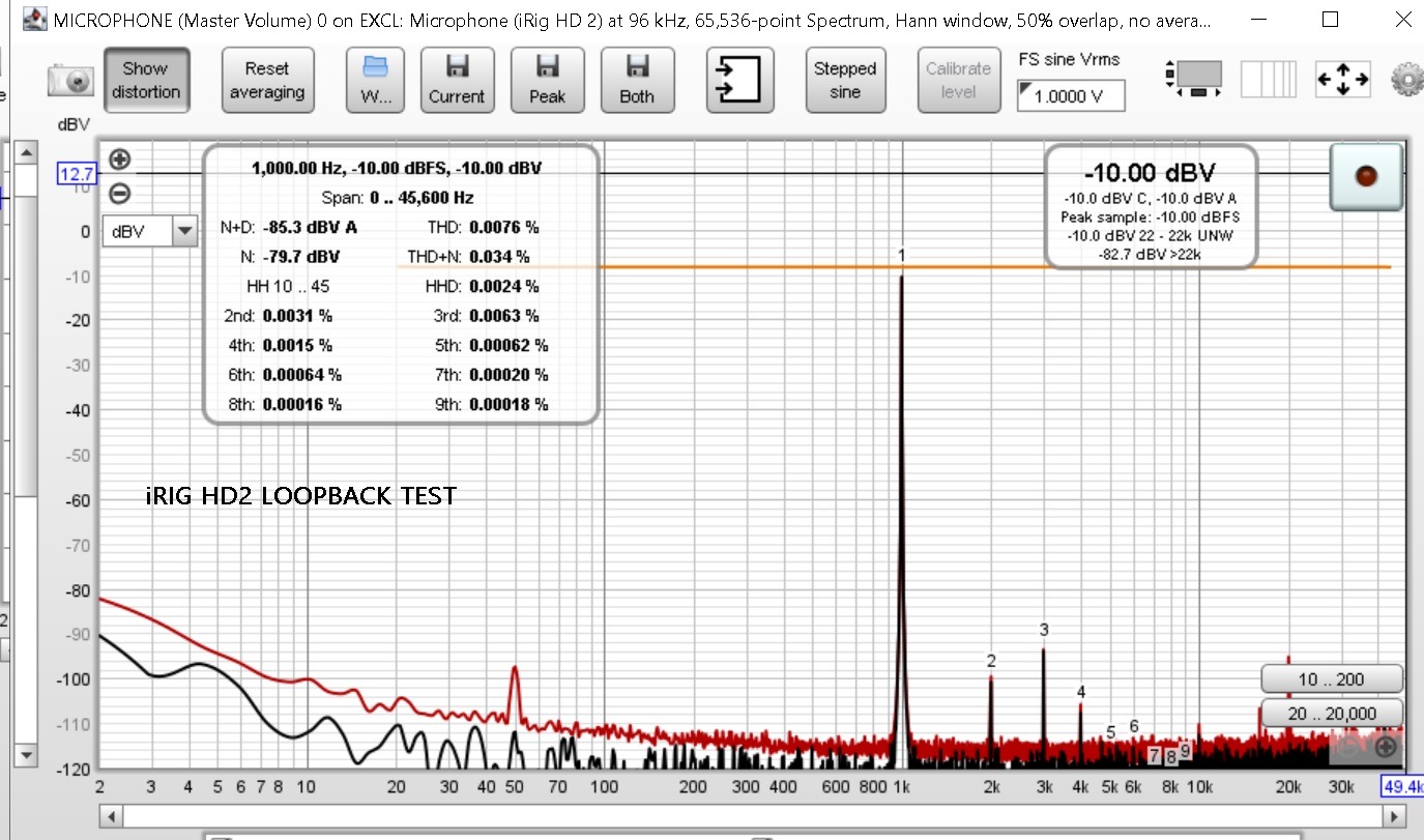

IK MULTIMEDIA iRIG HD2 MONO 24bit 96kHz INTERFACE.
Tested this today and found:-
It's very sensitive on max gain - about 90mv for guitar pickups.
It has a thumbwheel input level control with a wide range of adjustment - on minimum iit s too low for the max loopback output
The multicolour led needs to stay in the green when sampling.
It supports upto 96K sampling so I set the REW's range to 48K.
The input and output are 1/4" TS jacks, easily converted to RCA with adaptors.
REW uses the Java driver.
The screenshots are of loopback tests.

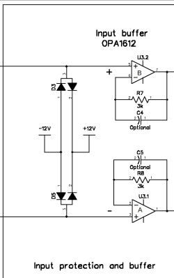

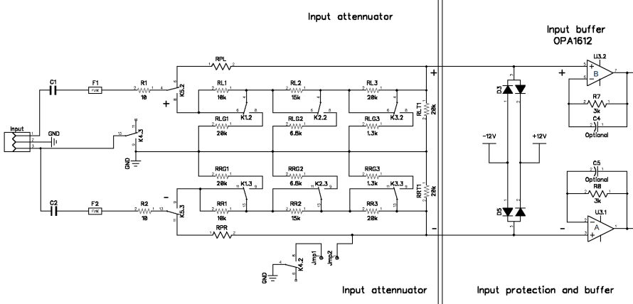

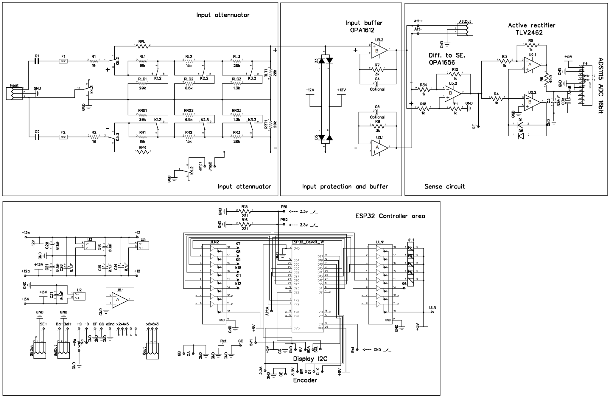

Hi all...
I'm doing a second version of my SuperRanger motherboard, and as I changed the "input" protection for the buffer opamp to the same as the input protection @MagicBus did on his balanced board for the Behringer.
Q: Will it be correct to not load R7/R8, or maybe use a lowish say 50ohm instead ?
My input protection circuit:
Note I also attached the complete circuit here.
@MagicBus board:
@MagicBus board:
Hi Jesper,
I'm not the most knowledgeable around but usually the RC network at the feedback loop is used to kill possible oscillation. Values depend on the frequency of interest. In one of my early PCB I had provided pads for SMD parts so to keep traces short if I just wanted to bridge the resistor and since this was the case, those parts were omitted latter in the design.
@MagicBus Thank's...
I also read something like that, and it's also working as expected in the balanced Behringer board.
Reason I had them 3k at my first motherboard/attenuatorboard is that the input protection had an resistance of around 3k, but as there are none "resistance" on this one, I will try to just use an "0" ohm thinfilm SMD resistor, and not load the capacitorpad with anything for a start.

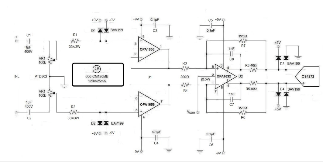

Nice! Just to make clear, the protective diodes only work together with current limiters in front, be it resistors, light bulbs or the attenuator itself.
Hi...
Yes, I will use a bulb at the RPL / RPR (ResistorProtectionLeft, ResistorProtectionRight or bulb) @ -0dB
Let's see how it goes.
I could also place it at F1/F1, but the idea is that when voltage is settled or under control, the signal can go directly into the buffer without any protection at -0dB, just as my working SuperRanger V1 is working.
As soon as attenuation is engaged at (K5) -6dB ---> -42dB the attenuator resistors will be part of the diode protection circuit.
I think it would work 🙂
Jesper.

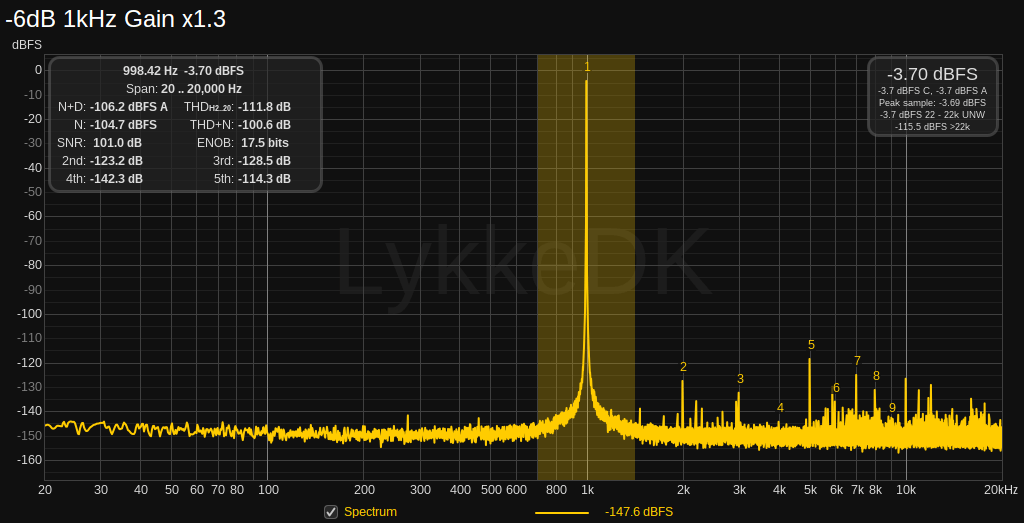

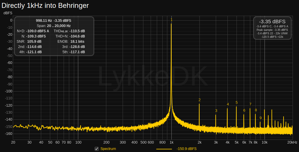

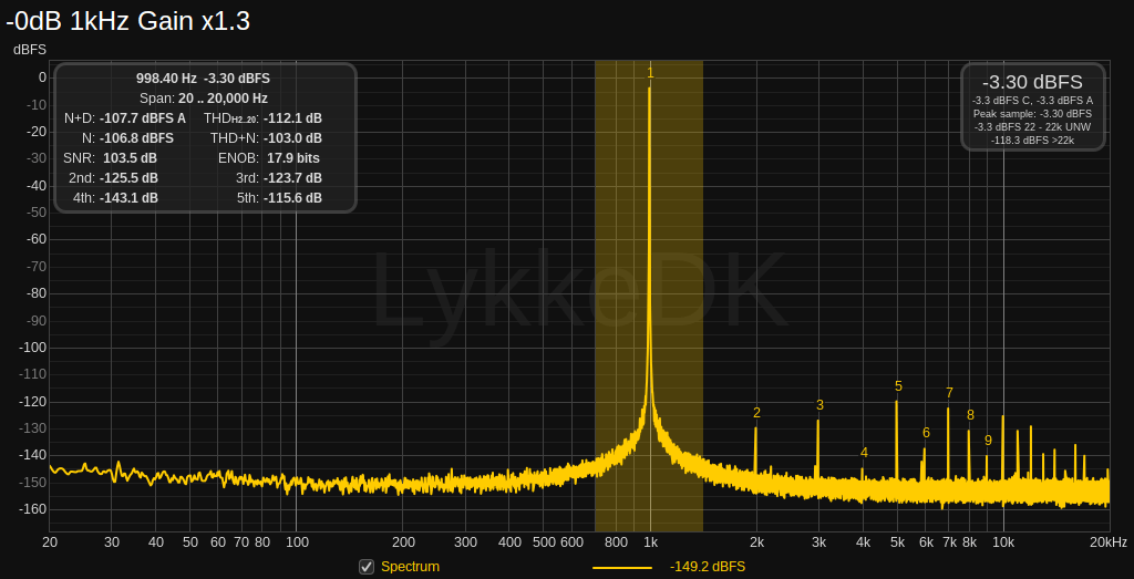

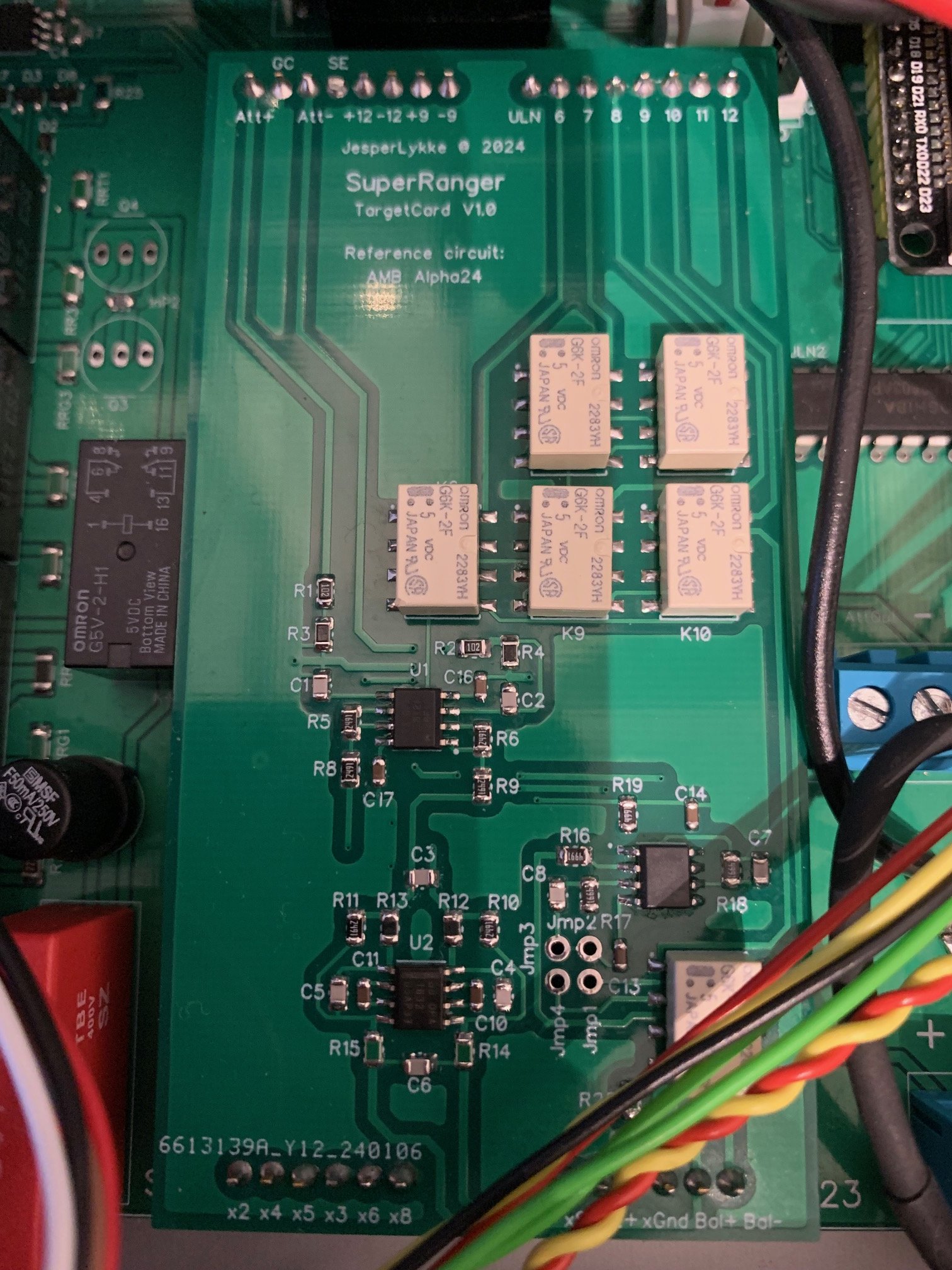

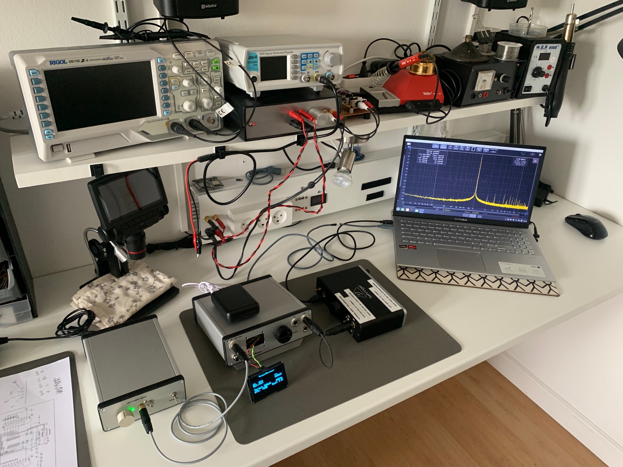

Having a little accident with my little oledscreen, so please don't mind the big blue one on the pictures.
- A new cheapish (8Eur 1.3" oled) is on the way with mailman now 🙂
I was for sure excited when trying the autoranger part of the (modified AMB alpha24) piggyback board.
Fortunately it behaved much better that I could have possible hoped for.
The autoranging part / outputcard is just converting the input signal to an userchangeable targetlevel. Which I allready explained here.

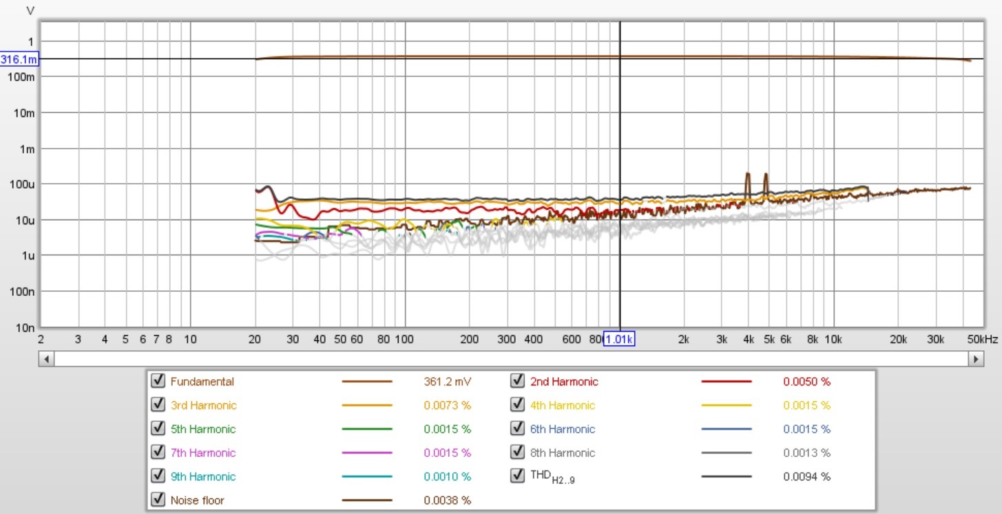

So what I was thrilled to see, was how much distortion and noise the output card would add, and if it would work proberly also.
Well.... Pictures below:
I'm so satisfied with the result, but there are still a long way doing the code and calibrating the in/out number's, but it's fun to do.
Noisefloor with shorted input's through the two lightbulb's
(There aren't really any change compared to sending the input through the MELF attenuator resistors) :
To have something to compare with, sending an 1kHz (Victors osc.) directly into the Behringer:
Now 1kHz ---> SuperRanger (gain is automatically set at 1.3):
At -6dB:
And for now at -12dB:
At -6dB:
There aren't much difference THD wise, how much gain the outputcard set's (ranging from x1.1 to x1.9)
Jesper.
