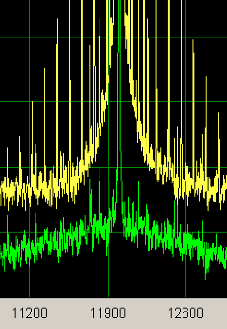

Some "good news" and interesting reading / studying material uploaded 🙂
Ergo's STOCK versus MODIFIED DCX2496 battle results
Perhaps this image is good for a teaser picture

Hello Ergo,
Well done! Your various measurements are very interesting and now it’s for sure: Modding isn’t placebo! 😉
I’m also glad to see that I can still trust my ears although my brain sometimes is misinterpreting them.
I’m pretty surprised about how poor the jitter performance of the original DCX master clock (build with 24.576 MHz crystal and 74HCU04) is.
The only disadvantage is that headroom for further improvements becomes smaller. Perhaps AK4396 DACs or power supply or …?
Kind regards, Frank

Ergo,
Is that at 5dB/div vertical scale?

OK, thanks.

There is absolutely no connection between a few test measurements and the conclusion that "modding isn't placebo"! Do you think that amplifier measurements are proof that they sound different?
Many differences can be clearly heard, .... even when there are no differences! The placebo effect is too powerful to stop by force of will. If you gained an impression of clear improvements by listening to your dcx, modifying it with soldering iron, then listening to it again, that conclusion has to be ignored. Get an unmodified dcx, put the 2 side by side, and do some simple blind testing of friends, 10 sec blocks, quick switching, many tests, document all results, analyse stats. Ahh, too hard.
Much simpler and more interesting would be posted waveform images or actual wav files of the analog signal exiting the dcx2496, before and after mods.
I know you do not like modding under any circumstances.
I fear the only proof for you would be to hear the difference yourself. So just test it!
BTW: I lived in Sydney for about a year. Very friendly people there in Australia.
Frank
