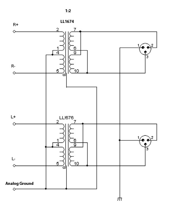

Quick question. I want to replace both input and output circuits.
Is the RS232 control board still available, and where can I get a good, readable copy of the pin outs of the ribbon connectors?
Also, I intend to do 1:1 input transformers and 4:1 output.
Any comments from those that have done this would be welcome.
Doug

I wouldn't go for more than 1:1 and 1:2. Ideally 1:1 and 1:1. With 1:4 your impedance seen by the DAC is 4 times lower and that could be deadly for the DAC, depending on your circuitry after the TR.
I can see I wasn't very clear.
On the outputs, I am looking for a 4:1 reduction. So if the DSP puts out 8 Volts rms, the transformer puts out 2 Volts rms.
This lowers the output Z by a factor of 16. If the output Z of the DAC is 10K, the output Z after the step-down is 600 Ohms.
I am doing this to better level match with my consumer amps, avoid resister dividers and take a load off of the DAC chip.
While I believe 4:1 is correct, I would welcome comments.
I would dearly love to do a 4:1 step-up at the input, but would need something extraordinary to drive it with. Not good design.
So I am staying at 1:1. Lowering the input Z to 600 is probably not a good idea. 🙂
Doug

Output circuitry - Are you planing to eliminate opamps and put transformers instead, or you want to use transformers after opamps? If you are planning to replace opamps with transformers I think you are miss judging DACs, they do not put much of the voltage out. If you lower down the signal so much I do not know what could you drive with it. Please accept my apologies if I am wrong in understanding.
My understanding is that The op-amps are buffer Circuits, with no voltage gain. Now that you have me wondering, I'll have to look it up in the data sheet of the DAC chip and the DCX schematic.
I want to eliminate the output circuitry, if a step down transformer will drive the power amps at the correct levels.
you understand fine. Thanks for taking an interest. I understand others have done this. Hopefully someone with real-world experience will chime in. 🙂
Regards;
Doug
OK, now we are talking. I have done exactly that, but not with 4:1. In my case I have Lundahls 1674 that are 1+1 : 4+4. I am using them as 1+1 : 2+2. Depending on the amp that works just fine. Some amps I actually had to increase gain on the amp in order to do it. In some other case I had to add XBOSOZ in the output since there was not enough voltage to drive my amp. So that is my experience. I do not know what do you have but I doubt that you will have too much - unless you are using preamp. My goal was to drive amp directly from Lundahls, and I am able to do it only with my Cary Audio 2A3 amp. Aleph 30 was way too weak so I had to add XBOZOS.
I prefer only Lundahls in the way of the signal and that would be my choice. Also I would prefer to do it as 1+1 : 1+1 but not enough output from DACs. So double check, in my case that's the story. There is a huge difference in having those opamps or just transformers sound wise as well as output wise.
Here is how is connected on the Lundahls. I got them from Kevin at K&K audio and he was very helpfull and nice to deal with. Give him a call and he could help you a lot.
