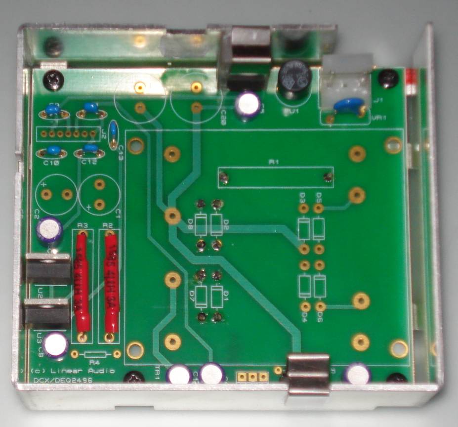

Hi Oettle!
Not sure that the PI filter is solving all noise problem. On my linear PSU, I first included a PI filter on the analog rail and after more testing, the noise floor was lower without the PI filter. 7815/7915 are not the best regulators for noise too.
With the linear PSU, +-15v and 3.3v are around 15mVpp noise, the +5V is below 30mVpp. If you replace the 7805 on the DSP board with a low noise regulator, you go further too.
With the linear psu, the difference is not only lower noise. Dynamic and high frequencies are also better. I received 3 reports from diyers with the same opinion.
For the one who use the DCX in analog way, I would also suggest to change the op-amp before going with the passive solution. It's a pain to do but very very efficient. I suggest LM4562 for input circuits and buffers, and OPA2134 for the DAC output (or better a double OPA827). Passive solution is in theory very fine but is not very dynamic and bandwidth not really flat.
Stephane

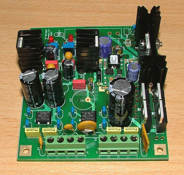

Hi Stephane,
You are right you can’t reduce all noise with a pi-filter but you can reduce noise depended on its frequency. With the proposed 100µH coil and a 220µF cap noise reduction @ 100 kHz is about 40-50 dB. So the 400 mVpp noise can be reduced to something about a few mVpp and it’s getting difficult to measure the remaining noise with a scope at all.
PSRR of the AK4393 is 50 dB and that of a standard 7805 is about 50-60 dB within sonically frequency range. That might be the reason why Ergo can’t see any improvements @10Hz-20kHz. Above 20 kHz this should be different because PSRR of the standard 7805 regulators get worse. Remaining question would be whether this out of band noise is sonically relevant at all?
Regarding PSU modding I didn’t understand benefit of improving +3.3V and +5V rails so far. These rails aren’t used by a single analog component. They supply digital components only. I’m using 3 DCX for several years and I’m not aware that DSP failed nor have I heard about such a problem.
But noise is an issue for the +/-15V and +9V supplies which are used mainly by analog components (DACs, ADCs, opamps).
Regards, Frank

Hello Frank, from stormy Northern California. I just got power after 1 and 1/2 day of outage. Regarding DACs that is exactly how I felt about exchange of DAC chips. There is difference, slight and mostly heard in high frequencys. Not a day or night but worth doing.
Regarding digital transformer, I believe it is not such a mod that could be heard with all other mods installed. Since Jon and Scientific Conversion is literary in my neighboroughood I had a opportunity to visit them and to have a demonstration on very sophisticated HP jitter measurement unit. Jon has big collection of various digital transformers for comparison. It was an eye opener. With simple replacement of various transformers in the same test board, instrument was showing jitter reading. The difference was tenfold.
Just exchanging digital transformer is not going to make a bad design a good one. In the case of Behringer it most likely lowers jitter at one step, and than everything else contribute to the sound.
I am glad that you found improvement with new DACs.
Cheers
AR2

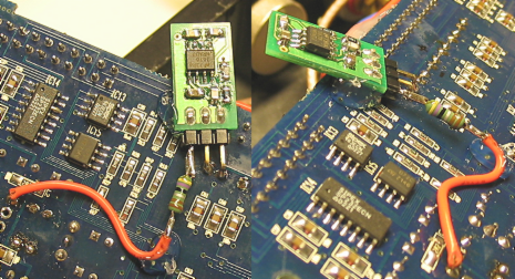

Have you tried to play with CKS pins? On the original design, the setting is pins 26, 27 and 28 connected to ground. It can be interesting to try disconnecting pin 28 and 27 from ground with AK4396.
