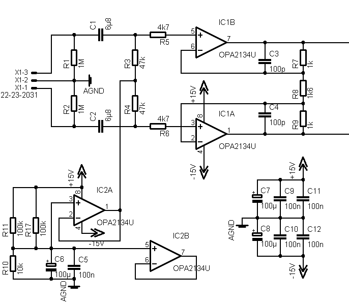

Are there any simple opamp-outputs (preferably balanced) that gets rid of the DC filter cap alltogether? Why is it even needed in a differential system?
And how 'bout a simple single ended input circuit?

Hi Novec,
I'm not aware of how to get rid of the DC voltage without caps but you can use Polyprop types to improve quality and you can use smaller values for tweeter and mid (C-µF * F-Hz = 1000). Without filtering the DC voltage the following opamp(s) might get a CMRR problem.
Here you get a simple and good analog IN circuit. C1 and C2 should be at least MKT (eg. Wima) type. For IC1 I would use LM4562. With R8 you can change gain setting. Instead of R10 there could be some kind of a zener diode.
There is an excellent example to go from balanced to single ended and get rid of the 2.5V DC without coupling caps on the data sheet of the DCX DAC - the AK4393 I think it is.

Thanks, oettle. Problem is I need a single ended input. It's probably a very simple thing to do, I just don't know how, and can't get any good search results on the forum. I won't need a DC input filter with the sources I've got now.
I'm still uncertain why a differential signal needs DC caps at all - doesn't the nature of differential eliminate the need for ground reference?
Hi Novec,
you can use the analog IN ciruit with balanced and unbalanced inputs. You need the input caps, because you have to add a 2.5V DC for the ADC.
Thanks, Jan, I think I'll keep it single ended and go for that. I have some LM4562 left from the group buy, so I'm pretty much set to go.
I have a whole lot of good 2.49k resistors, but no 1k - is there any way I can use them instead? I don't need anywhere near the 4.8V output level the original circuit gives.
Oettle: I guess it's the IC2's job to generate the 2.5V for ADC reference? And the same chip can be used for both channels? And just to clarify - when going single ended, the negative input is shorted to ground?

novec said:[snip]I have a whole lot of good 2.49k resistors, but no 1k - is there any way I can use them instead? I don't need anywhere near the 4.8V output level the original circuit gives.[snip]
It's the ratio of the resistors, more than their absolute value (within reason). Those 2.49k's will do quite well.
If you want to use the filtering caps in the original app note, make sure you decrease their values by 1/2.49 as well.

Ok, that makes for 400pF and 1320pF - 470 and 1500 sound good? I'll probably go for Wifa FKP2, I don't have any fitting values lying around anyways.
looking at the original DCX output circuit I would say that the first opamp stage is just the same as on the AK4393 data sheet. But at the output of this opamp Behringer uses a 47µF AC coupling cap. Reason for it might be that if the R values doesn't match exactly there will be some small DC voltage on the output?
Yup, and on the original output stage you've got a whole lot of amplification both in this opamp stage and the next. Remember, it's a pro unit with +22dB max output level, and I think they value full DC blocking higher than the sound quality they lose with the capacitor.
