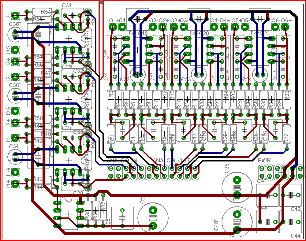

I've thrown together (well, not exactly thrown, I've done it pretty carefully) an IO board with six output stages from the 4393 datasheet, three input stages as shown by Oettle, and a bit of power conditioning. It a bit shy of a 100x80mm board. I've made room for the huge MKP1837 decoupling caps, but the first cap on the output stage might be a little cramped if you go for standard values.
The point of the board is that it'll have all components on top, but pin header sockets soldered underneath so it slides straight into the ribbon cable sockets on the DSP board without any cables. The input circuits need DC caps ahead of them, and if necessary, the separate mic circuit. Mic relay signal and relay power is easily tapped from the right hand header.
Comments and tips are very much appreciated, as I have noe experience or training in board design, I just set it up so it looks more or less logical and tidy.
ZIP with board and schematics here

Oettle; When feeding single ended signal into the analog inputs you suggested, doesn't that effectively cut resolution in half? Would it be possible to reverse polarity on one of the opamps and have it convert the single ended signal into balanced?
Going in single-ended, you can just increase the signal in that case, watching the input level LEDs. But also in the balanced input case, you always have to adjust the analog input level for best/max resolution, i.e. a few dB below clipping.
Jan Didden
Hi Novec,
You are right input voltage is doubled using balanced input. But I think there is also a difference between professional and home equipment regarding level? So you have to make a decision whats your favorite input level and have to adjust R8 (gain setting) accordingly. The original DCX input has the same problem. If you want to use different input levels I only see the solution to have different R8 values and to select between them via a switch or a relay. Life is not perfect but it becomes easier with digital input.
Regarding your proposed schematic:
1. I couldn't see the AC coupling caps for the inputs.
2. I would use small COG type (~1nF) and for the +/-15V rails X7R type (100nF) caps. I can't see any benefit coming from the proposed MKT type caps.
3. There should be two caps per opamp referring to GND!
4. The +/-15 supplies could be improved by two simple coils or better by two regulators which generate e.g. a +/-12 volt output from the +/-15V rails (see my Vreg schematic a few posts before).
Frank
Jan: Doesn't the ADC take half the bits from the positive input and half from the negative? Or does it just take the difference between them, even if the negative is grounded, so I'll get a full resolution digital even with a single ended input?
Frank: I just want to have the highest possible input resolution at my relatively low analog input level, but all inputs can stay at the same gain. Once the digital amps go online, they'll do the crossover functions for the fronts, and I'll molest a cheap receiver to feed the Behringer directly through I2S for center and surrounds. With some luck that'll only take a few months, which is why I won't put too much effort into the analog section this time.
Over to your comments:
1. I'll keep the AC caps offboard, I have some big Mundorf RXF caps I'll stick in the open space to the left of the DSP board.
2. COG and X7R? Afraid I'm not with you there. I figured nice MKT caps would be good both in the signal path and for decoupling, but maybe they won't make much of a difference. If not, cheaper and smaller is definitely better.
3. D'oh! Just my brain stuck in neutral again...
4. You're undoubtedly right, the onboard power supply isn't the best, but I was trying to make it cheap and simple. I've got just about all the other parts I need. If I can free up some board space by using other caps, it might still be an option.

Regarding the bias for the input circuits; does it really need an opamp? Both the circuits in the AK5393 datasheet and in the Behringer schematics use a passive bias with just a couple of caps and resistors.
Is there any way to simply eliminate one of the input opamps and short the negative inut to ground or bias? If not, I think I'll go for inverting one of them to make a full-level differential out of the single ended input. I'll also replace R8 with a trim pot.
