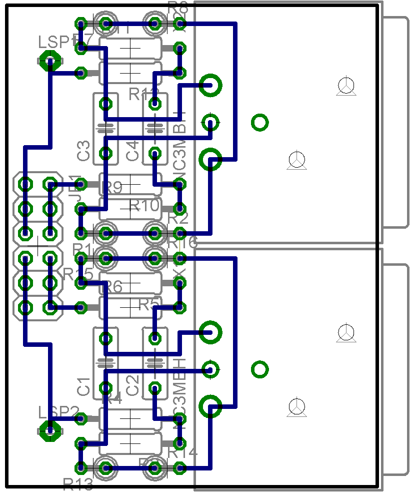

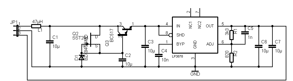

Hello,
here some fresh ideas for PSU modding. I routed the circuit on a 10x20 mm PCB which is the same size as a TO-220 case and replaced the two 7805 voltage regulators on the DSP-board. D1 is a 6.8V zener and Q2 a SST506 constant current diode. All 10µF caps are X5R 0805 type and the 1n and 10n caps COG/NPO.
This voltage regulator has a PSRR of at least 200dB (10Hz to 10MHz!) and has a low noise output which is much, much better than what I have seen so far.
You can use the same circuit for +/-12V supplies (op-amps), but zener must be increased and a different regulator must be used because the LP3878 supports output voltages only up to 5V. I myself don't need this because I use passive outputs.
Frank

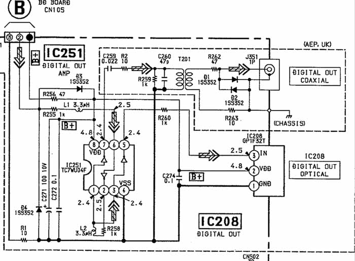

Thank you Ergo, very much, but that would be to run coaxial S/PDIF out. I was thinking of having AES/EBU out, for what I assume have to have CS transmitter. That transmitter will output S/PDIF as well, but my interest is AES/EBU. Are you saying that I should use that three wire signal and wire that to the input of CS chip in addition to the clock, power supply...
Hello Jan and Ergo,
I just have received my schematic for Sony XA20ES. Here is what is inside regarding S/DIF outputs coaxial and optical. Apparently they ddi coax out for UK market and not for US - it seems like it. This schematic might answer question that Jan had, and might help if someone would like to design a mod to make AES/EBU output.

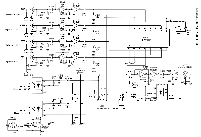

I'm just happy the DCX is as modular as it is, it makes input, output and PSU upgrades a breeze. I'm making just about the simplest passive outputs there is; based on Jan's article, but without the mute circuit and onboard DC filter caps. They're 1.9" wide stereo boards, so they'll easily fit in the DCX with room to spare for DC filters. You can even have different output stages for each DAC, if the amps down the line have different requirements.
Anyone interested? They should cost next to nothing if we order some at OurPCB or something.
What I don't understand is why all the mods I've seen so far are using standard ribbon cable between input/output board and DSP board. They're a regular analog signal, for God's sake! And all connectors are standard 10mil spacing, so it's very easy to solder good quality internal wiring to standard 10mil header sockets like these.
Next in line is swapping the AK4393s with DIT4192 S/PDIF transmitters to get full digital out, and swap the AK5393 for a separate input board with an SRC4392 S/PDIF receiver and PCM4220 ADC to get more and better inputs. That's after upgrading PSU and clock, of course.
AR2 said:Hello Jan and Ergo,
Thanks AR2 and Ergo, I understand now that optical stuff is really VERY simple! I have an HP 3756A 1-of-10 90MHz switch which I use for digital selection, and I will modify one input for optical toslink in.
Jan Didden

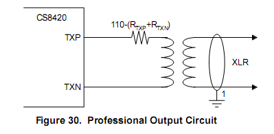

AR2,
You can make the AES/EBU out for Sony just as well. The only difference is basicly the transformer and passive components to adjust it for 110ohm instead of 75 ohm.
But I would rather mod the input of the DCX to receive the 75 ohm coax as the original digital input layout is more than poor in my opinion. The AES/EBU signal goes from XLR connector to relay, then about 8cm on PCB then through flat cable and connectors, PCB traces again and then finally reaches the CS chip. All this is far cry from proper 110ohm termination to the AES/EBU line....
Ergo

I don´t know how you managed to squeeze so much stuff in that smal area..I routed the circuit on a 10x20 mm PCB which is the same size as a TO-220 case and replaced the two 7805 voltage regulators on the DSP-board.

Do you know what the PSRR is for the Selectron regulator board?Just to have something to compare with.This voltage regulator has a PSRR of at least 200dB (10Hz to 10MHz!) and has a low noise output which is much, much better than what I have seen so far.
Hi Ryssen,
It's a double sided PCB with all SMD components. It's not a trick.
I'm not aware of the Solectron PSU mod, but I assume they use LM317 or something similar. These standard regulators have an PSRR of about 60dB which gets much worse above 1 kHz (10-20dB at 100kHz-1MHz), that's why there is so much HF noise coming from the switched Behringer PSU. The regulators aren't able to reject this HF noise.
My experience was that with 3 simple 100µH coils between PSU and DSP board you get rid of most of this HF noise and have a similar result as with the PSU mods I have seen so far at a much lower price.
Frank
Frank

Unless they are SMD parts, put 43 or 45 components on a double side 10x20 pcb is a nice success.
It can be cool to use this kind of "miniVreg" with my PSU too. On the DEQ, analog 5v (for ADC and DAC) is still using a 7805. The LM317 on the DSP board is used to produce digital 2.5v. No need to change this one.
Thanks but I can't make miracles to become true. Including the connector there are only 15 components.

Hi Ergo,
Because there is a lot of HF noise coming from the Behringer PSU it would be interesting if there is some improvement with a 100µH coil in the 9V rail.
My Vreg mod is able to handle up to 800mA but then would need some additional cooling. With the typical 180mA for the 3 DACs no cooling is required.
Frank
Frank

I just checked and the LP3878 is even available in Estonia through RS catalog. So I could try that also, though the order from there arrives most likely next week.
Ergo
Ergo
ergo said:AR2,
Ergo
Bypassing the PCB path is a very good idea!
And you can do even better and go for the SPDIF setup described in the Cirrus data sheet (for most CD players that output SPDIF only):

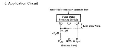

janneman said:Guys,
I have been looking into that optical input thing. Am I correct that those Toshiba optical S/PDIF receivers just need a +5V, you plug in the optical cable, and than at their output you have the 'electrical' S/PDIF?? Is that really all there is?
Jan Didden
yes Jan - very easy, and there is TTL/S-PDIF - but I think there's a capacitor and choke (yes, not resisot - see pic) external for digital filter or some such.
the TORX-179 is a nice high speed device, and will go with the 192kHz mod nicely.
Simon
Simon
Thanks. I use an HP high-speed selector unit for digital source selection, and I plan to mod one of the inputs to toslink.
Jan Didden

Can I pick your brain some more. I found a data sheet for the -177, not the -179. It says "pulse width distortion 15nS max". Is that the jitter spec? If so, it doesn't seem too hot.Pulse-R said:
Simon
Jan Didden
