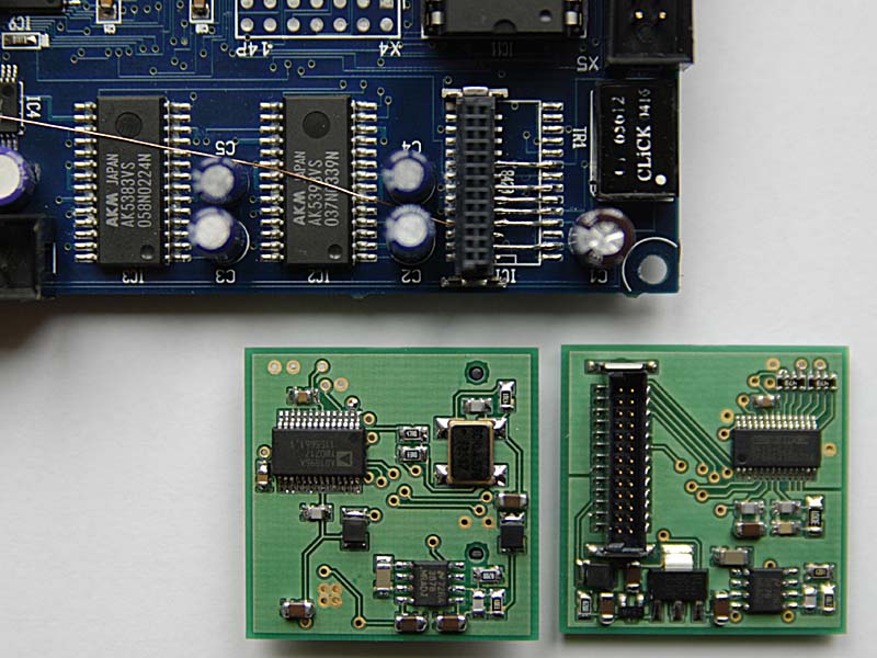

When I started I only wanted to get rid of this sometimes dull sound caused by the erroneous CS8420. When I finished I found myself one (in my opinion) big step closer towards 'sonical heaven'. So what did I do? I fear nothing really new but perhaps a new combination. I took this 2. generation CS8416 + AD1896 replacement for the CS8420 sample rate converter which is described here http://freerider.dyndns.org/anlage/Behringer-Input-Stage-E.htm or there http://www.dcx2496.fr/upsamp.php added a low jitter (typ 0.5 ps) clock which is something like this http://www.tentlabs.com/Components/XO/index.html or that http://www.dcx2496.fr/selectro3.php designed two improved low noise supplies with high PSRR for both functions and routed everything on a tiny (32x32 mm) PCB which can be plugged directly onto the DSP board of the DCX via a SMD connector soldered to the pads of the CS8420 (no noisy and difficult to assemble cable).
What I expected was to get rid of all the clicks, cracks and sometimes dull sound caused by the CS8420. What I didn’t expect is this sonical clear higher accuracy (much better details).
The picture shows DCX-DSP board (blue) with SMD connector assembled instead of CS8420 and two MOD-PCBs (both sides). If there is somebody who is interested in this mod please send me an email. I have a few spare PCBs left.

I have a few questions regarding your mod, that I think could help me a lot in understanding:
With installation of a new clock in the input circuitry with SRC and receiver - what is happening with the clock already installed in DCX? Is it still needed, or not? If not does it need to be taken out?
There is really good amount written on jitter and lowering on jitter here:
http://www.lessloss.com/
They have the very same approach as Guido from Tenet Lab which in short is: Better to eliminate jitter by switching DAC to be master and CD to be slave in regards to clock. That is achieved by installing separate link between DAC and CD and eliminating internal clock in CD player. That way all the jitter is more or less eliminated as DAC and CD and wire that connect them are clocked to the same clock. This could be impractical for someone who uses several sources, but fine for someone who connect only CD to the unit.
In existing approach DAC acts as a slave and CD is master clock? I am assuming. In that case we are trying to lower the jitter that is already generated and delivered to the input of DCX through the AES/EBU or S/PDIF wire.
Would it be possible to use your mod as master and feed the CD player from that clock? I gusess that also put me back to my first question, does your clock now act as master clock to the whole DCX or is it clocking only SRC and CS8416?
Please let me know if this is correct.
Thank you
AR2
The mod is not only an improved SRC but also a low jitter clock (typ. 0.5 ps) with improved low noise and high PSRR (>100dB) supplies. The clock on the DCX-DSP board is deactivated by disassembling one resistor. So everything inside the DCX (PLL, SRC, DSP and DACs) operates absolutely synchronous with this new ultra low jitter master-clock at a speed of 96 kHz.
Because a CD player provides 44.1 kHz data it’s typically not synchronous, but that's not really important as long as it delivers rather low jitter data so that the PLL can lock on it properly, because this 44.1 kHz data is up-sampled to 96 kHz and re-clocked by the SRC anyway. Most important is that the DACs (inside the DCX) get a low jitter clock and that the SRC is synchronous to this clock.
I think there are ways to make the data source (eg. CD) synchronous too, but I fear only with high costs, low flexibility and low benefit.
