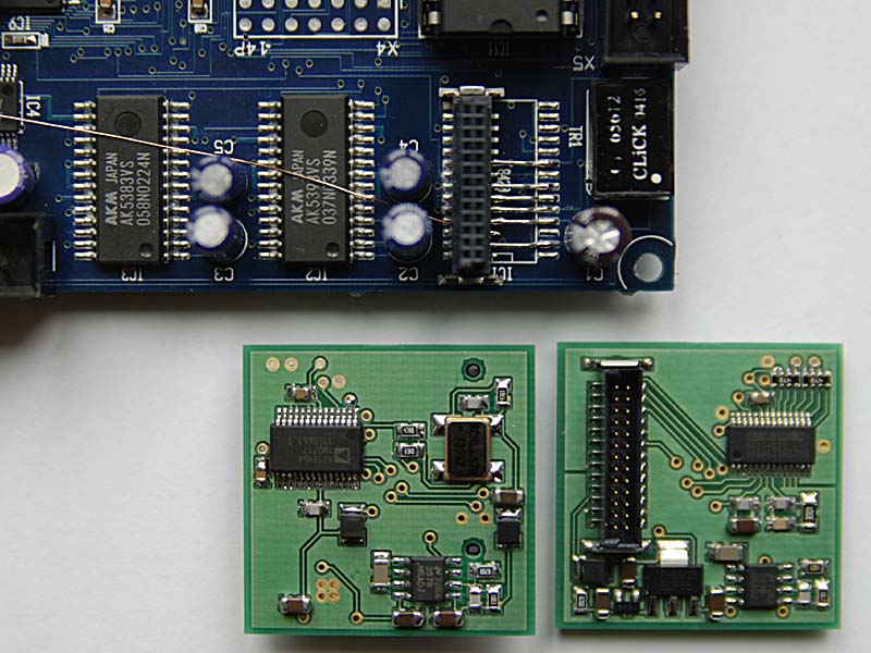

Hi all,
When I started I only wanted to get rid of this sometimes dull sound caused by the erroneous CS8420. When I finished I found myself one (in my opinion) big step closer towards sonical heaven. So what did I do? I fear nothing really new but perhaps a new combination. I took this 2. generation CS8416 + AD1896 replacement for the CS8420 sample rate converter which is described here http://freerider.dyndns.org/anlage/Behringer-Input-Stage-E.htm or there http://www.dcx2496.fr/upsamp.php, added a low jitter (typ 0.5 ps) clock which is something like this http://www.tentlabs.com/Components/XO/index.html or that http://www.dcx2496.fr/selectro3.php, designed two improved low noise supplies with high PSRR for both functions and routed everything on a tiny (32x32 mm) PCB which can be plugged directly onto the DSP board of the DCX via a SMD connector soldered to the pads of the CS8420 (no noisy cable).
What I expected was to get rid of all the clicks, cracks and sometimes dull sound caused by the CS8420. What I didn’t expect is this sonical clear higher accuracy (much better details).
Here some pictures of both sides of the assembled PCB and the instead of the CS8420 assembled SMD connector on the DSP board. If there is somebody who is interested in this mod please send me an email. I have a few spare PCBs left.

The picture shows DCX-DSP board (blue) with SMD connector assembled instead of CS8420 and two MOD-PCBs (both sides).

Very nice. I good direct plug as in my small miniCLOCK.
Not too difficult to wire the connetcor on the DSP board?

Do comment..🙂I just ordered much newer and better ones from AKM - AK4396 to put them in the place of original 4393s. I cannot wait to do this mod and to give it a listen. These are highly regarded chips.
Hi Ryssen,
I myself use an ultra low jitter 24.576 MHz oscillator, which supports digital inputs up to 96 kHz. The advantage is that PLL; SRC, DSP and DACs run absolutely synchronous for best sonical quality. You can also assemble a 28 or 30 MHz oscillator to support 192 kHz but then you have to stay with the existing high jitter 24.576 clock on the DSP board or you have to add an additional low jitter clock. Regarding sound quality it doesn’t make sense for me to down sample a 192 kHz input to the 96 kHz internal frequency of the DCX.
Frank
Frank
No it doesnt,even thow my DVD player supports 192khz,I don´t know what media does (DVD-A?).And my Roland M-1000 digital mixer and DEQ2496 does not so...Regarding sound quality it doesn’t make sense for me to down sample a 192 kHz input to the 96 kHz internal frequency of the DCX.
Then I can connect XO3 24.576MHZ (As I have it) to the CS8416/AD18961 pcb and remove the clock on the DSP pcb?
