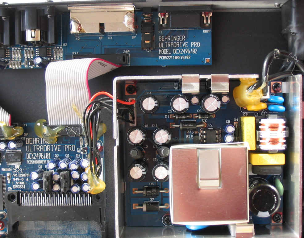

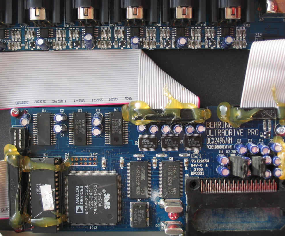

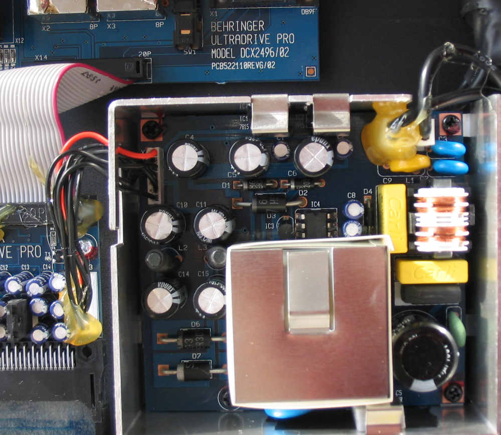

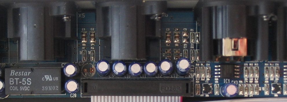

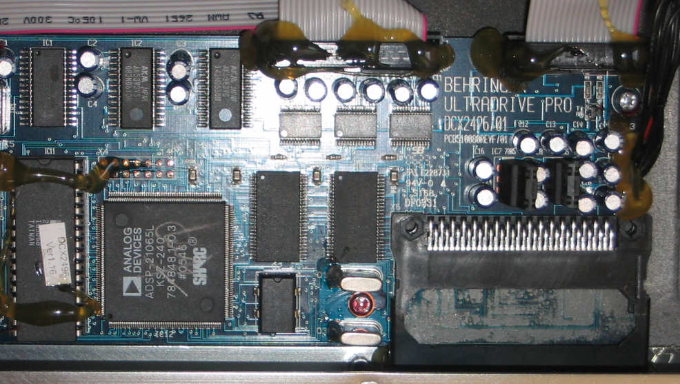

Hi guys,
I bought a DCX2496 a week ago.
On the enclosure it states 0607
So this unit was assembled in July 2006.
I opened the enclosure and made a few pictures, so that those of you with experience can detect possible differencies with older production units.
I am still wondering whether to replace the analogue out board with that designed by Jan Didden or the one on the Selectronic site (who will come also with a new high-end design)...
Lucas

Seems that not much differences at least looked from the top
You can compare to my pics from a few years ago
http://f5.infonet.ee/ergo/DCX2496/dcx2496%20002.jpg
The transformer in power supply seems to have a shield in yours and also the serial communication ports have a shield in yours.
Ergo

Yes, that's the latest version, I've opened one a few weeks ago.
There are minute differences compared to the "old" versions : SMPS
shielding, decoupling caps on the output opamps, slightly different
layout for the clock oscillators, all in all nothing major. By the way
Selectronic is launching a high-end ouptut stage for the DCX :
http://www.selectronic.fr/audiophiles.asp
The input XLR sockets aren't installed yet on this example but they'll
be Neutrik ones. It's a plug & play board which keeps all of the
original functions operating and improves A LOT the analog performance. Picture :
