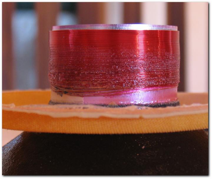

I can tell you from experience, a lot of smoke and bad bad smell. :hot: Your speakers and your amps will end they're life after some time.
I learned this after using the DEQ2496 single ended with my DC coupled The End amps.:bawling:
Let the attach image bee a warning :smash:

The fact that your speaker doesn't return to the neutral position is shure sign that you have DC voltage applied to your amp. In order to avoid that, capacitors are inserted in the signal path to block DC signal. Your music should be only AC without any DC in it. Another way to remove DC from the signal is line level transformer with ballanced signal that canncel itself, but lets leave that alone for now.
DC in signal path is something you should avoid unless you enjoy burning your speakers. In order to simplify your question on AC or DC coupling - you just have find out that you do not have DC blocking in the input of your amp. So you must have something that will stop +-2.5V DC coming out of AKM DAC. With nice pp cap in the way of signal you will still have dramatical improvement over stock opamp output board.
