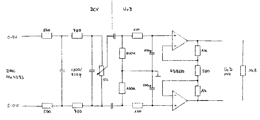

Hi Jan.
it's me again. I drew two circuits. The first shows DCX and UcD without pot and the second how I would integrate the pot.
I thought AC coupling caps are best after the pot because of the high input resistance of the instrumental amp of the UcD?
The Ucd amps have an on/off control input (http://www.diyaudio.com/forums/attachment.php?s=&postid=441385&stamp=1090523307) which is connected to the Hypex supply which has a power on/off circuit with power on delay. Might be this is already sufficient. Perhaps it is possible to connect the mute output of the DCX here too.
Do you have any complaints?
My crossover points are 127Hz and 1,35kHz with a 48dB slope. I've no possibility to calculate the filter. Is there a chance that you help me to optimize the filter?
Kind regards and best greetings from Bavaria,
Frank

Hi Frank,
Apologies for the late reply, missed your post!
This will certainly work, and the choice of the pot value seems sensible at first glance. The only remark I would have is that the pot setting influences the filter after the DAC; the lower the volume, the higher the filter cutoff frequency which would in theory give you more hf noise with lower volume. Then again, since this hf noise is high in frequency you probably don't hear it. I don't know how resistant the uCD is to hf noise?
This is probably best checked by just trying it out.
Jan Didden
Hi Jan,
I don't understand why you think the pot setting has influence on the filter.
Since the input resistance of the UcD is rather high (200k) the total resitance (10k) of the pot (which is the load of the filter) stays rather unchanched (about 9.5k at full volume).
So the pot setting has an influence on the filter since the total resistance of the pot varies between 10k and 9.5k but this minor change has a negligible influence on the filter (about 3% at 20kHz).
But perhaps I've overlooked something?
Frank
Frank, I was replying to your circuit in post 826. The pot resistance changes the source resistance seen by the last filter capacitor (the one after the two 750 ohms resistors), so in theory the cap value should be recalculated (increased).
I now see that I misread the circuit also: I initially thought you used the pot as a variable resistance and that would have a large effect on the cap (and also vary the required cap value with pot setting). I now see that this is not the case, you use the pot as a real attenuator, so the effect is much less and also constant (provided the ucd has high Zin as you stated).
You are right, no changes are required.
Jan Didden
Yes but the 100 ohms is effectively open ended with the very high ucd input Z, and the 100 ohms/ 100pF has a rather high cutoff point. There is influence but not too much. The pot itself increases the -3dB point of the filter and the 100 ohms/ 100 pF pulls it down a bit again. It could be tweaked but I think it's OK the way it is.
Jan Didden

Andrew I missed your point, you are right. The pot gets in series with the 100 ohms and then the 100pF becomes significant! Definitely needs to be adapted.
Jan Didden
tried hard to simulate what you are talking about. I can't see that the pot setting has any not negligable influence on the filter or attenuation.
The instrumental amplifier on the UcD PCB adds additional attenuation and phase shift at the high end. So the question is what is the optimal filter setting (attenuation at 20kHz and 40kHz).
Frank
Each part of the pot appears as the source Z for the 100 ohms and 100pF on the ucd input side. That means you have a lpf of (very roughly, there's more issues) of (part of the pot + 100 ohms) and 100pF. That is not inconsequential.
BTW at mid point of the pot your volume is zero, you know that of course?
Jan Didden
if I'm right, the R100, 100 pF filter on the Ucd is a HF filter to attenuate noise caused by the wiring. The filter and the pot setting is negligible for frequencies below 20kHz.
The far more important question is what is the optimal (second order) filter setting for the tweeter channel (attenuation at 20 kHz, 40 kHz, 80 kHz). Might depend on whether you have CD or SACD data. Does anybody know about some theory?
Frank
